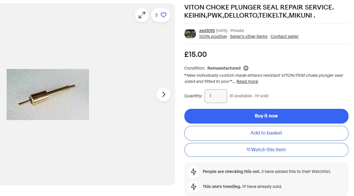

Re: One white plug
14 Oct 2024 08:05You don't need to send the carbs, just the plungers (Zeds Ebay add below)Thank youu, I will wait for some replies for the dynojet needles!! For the plungers, how much it can cost me to ship all my carburetor?! I am afraid a bit to send these carbs far away like that!!!! They are hard to find here hihi 😉

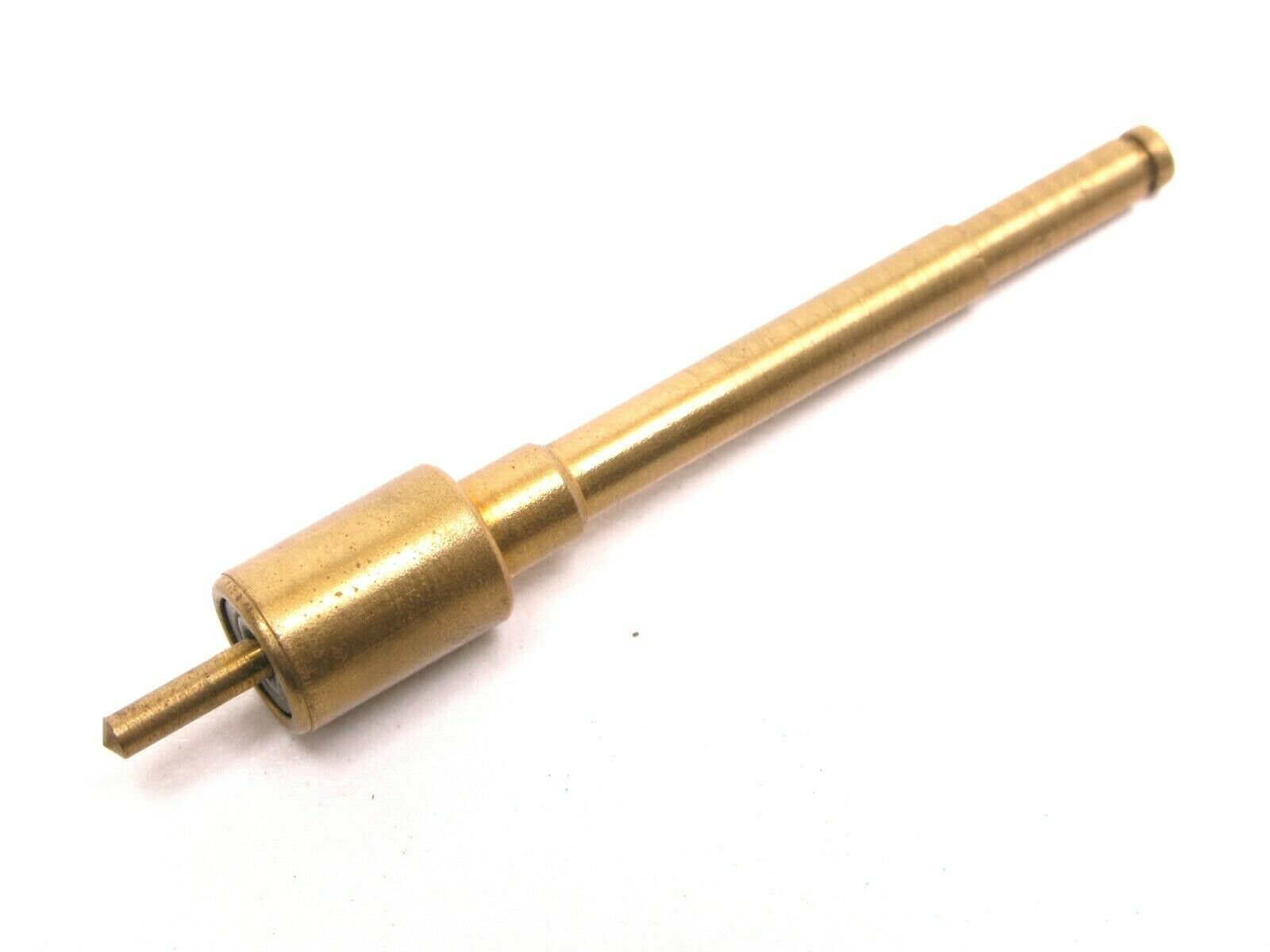

14 Oct 2024 08:21 - 14 Oct 2024 08:25You don't send all the carbs.For the plungers, how much it can cost me to ship all my carburetor?! I am afraid a bit to send these carbs far away like that!!!! They are hard to find here hihi 😉
Just the bare plungers with springs etc removed as in the pic.
I replace the old worn and leaking seal with ethanol resistant viton.
I have done hundreds worldwide and it usually only takes about a week to 10 days on average each way to and from Canada, USA etc.
Here's my email -  zed.1015@yahoo.co.uk  - if you want more details on price and how and where to send etc.
Price direct is cheaper than Ebay with their fees etc.Â

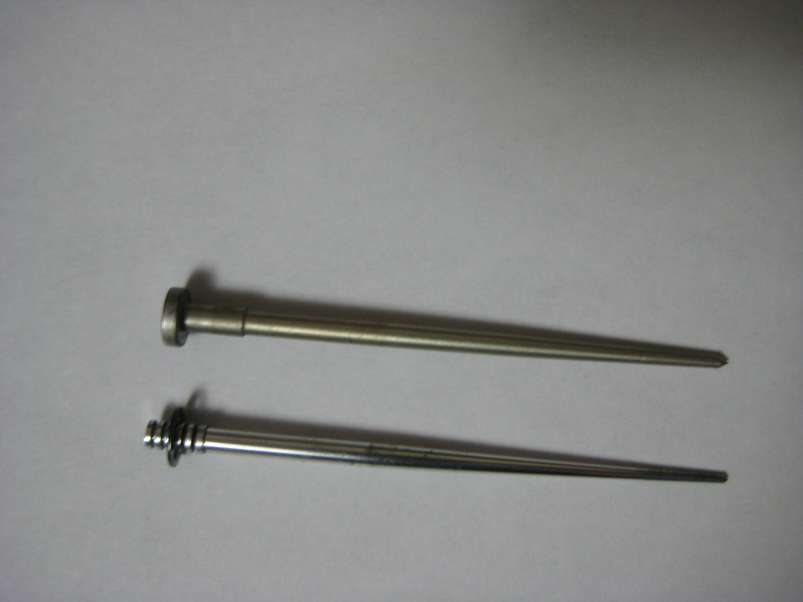

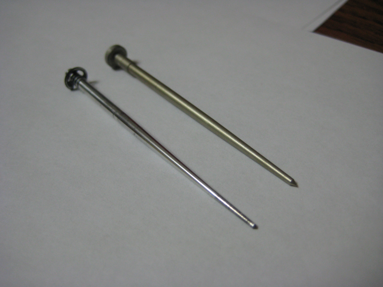

Here is a example of "Dyno-Jet" needle for a CVK carb :
Stock needle has no adjustment but can be adjusted "leaner" by stacking washers under the heads. You can see how much thinner = richer the Dyno-Jet needle is.
Generally you should only try to fix one issue at a time when trying to tune carb problems, it is hard to track what fixed the issue when changing multiple tuning parameters. Get the choke plungers fixed then see how it runs, move on to needles if it does not solve the 3-4K RPM issue.
