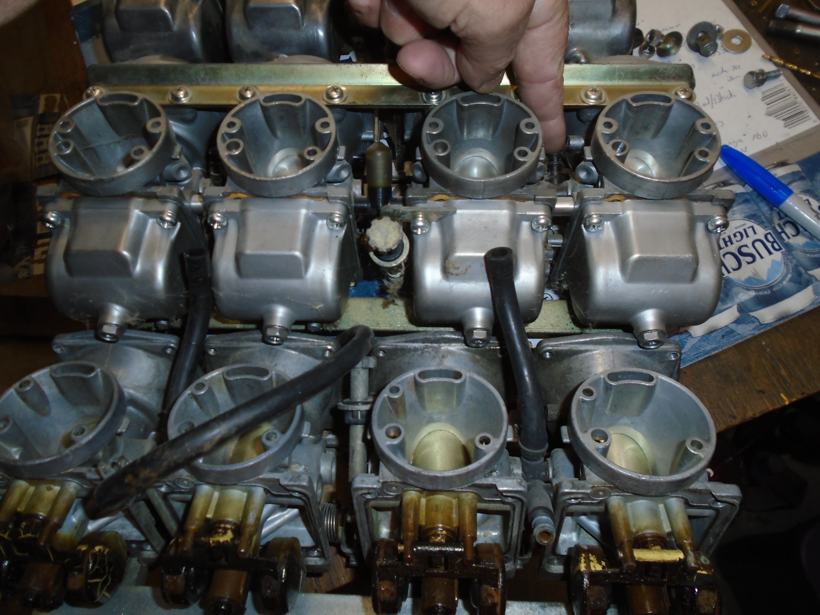

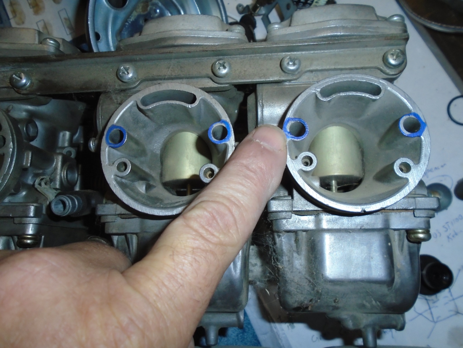

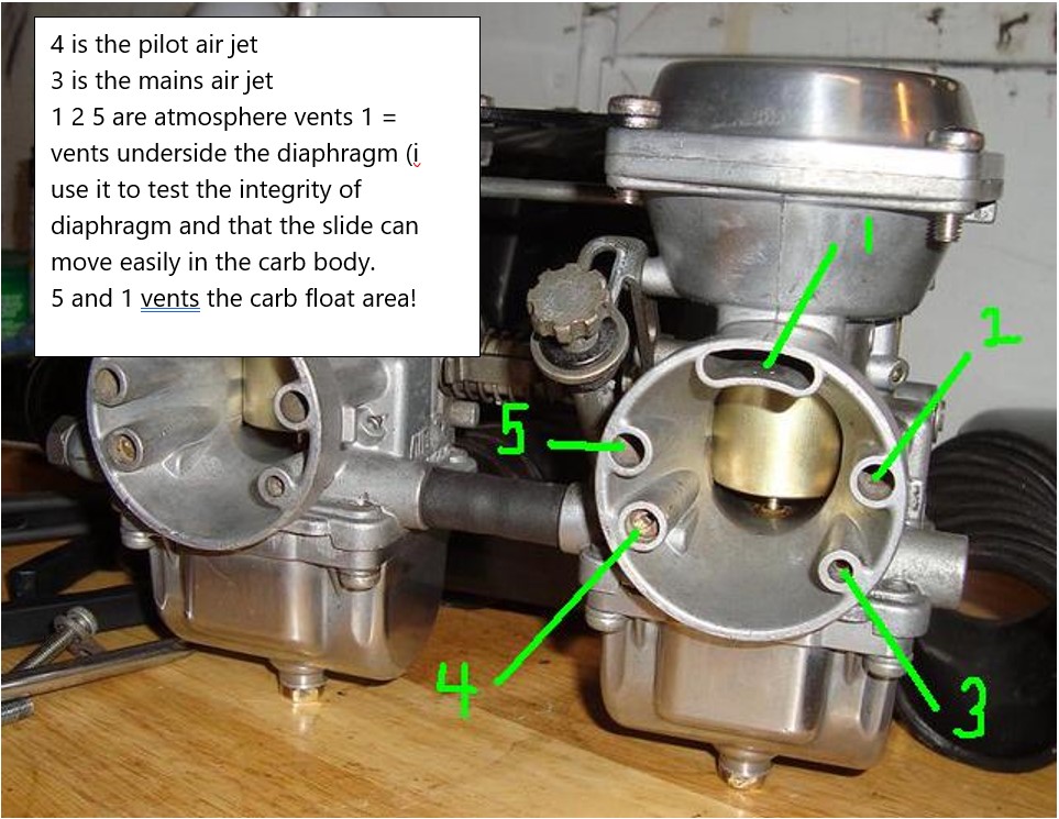

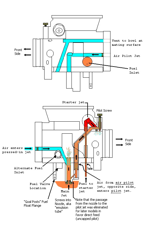

Bowl vents. David, depends on which version of 34's You have? They went about it differently on different types. You have Your basic 34's, black plastic TEE between 1 and 2/3 and 4 then they had one that vented (2) casting holes, thru intake as highlighted in blue. These are the air-cut style Kawasaki ones. Others shown are Suzuki GS and Yamaha XS, they also used the black plastic TEE. I'm still suspect of float tower to float or float pin bind.

10 Sep 2024 08:06That explains why mine were flooding. Changed the O rings but didn't clean out #1 Like I did the rest. The old ones were crusty and falling apart. Seems to me having the vents in the vacuum path would cause negative pressure in the bowls or how does that work? Looked to me the vents were in a casting on the sides but judging on how it was flooding I guess I was wrong. It was coming out of the two holes you have circled in blue. Got it now.Bowl vents. David, depends on which version of 34's You have? They went about it differently on different types. You have Your basic 34's, black plastic TEE between 1 and 2/3 and 4 then they had one that vented (2) casting holes, thru intake as highlighted in blue. These are the air-cut style Kawasaki ones. Others shown are Suzuki GS and Yamaha XS, they also used the black plastic TEE. I'm still suspect of float tower to float or float pin bind.

10 Sep 2024 08:43It certainly does seem strange (I was always under the impression the bowls needed "atmospheric pressure" through the vents) still "every day is a school day" - the stock airbox on my "K" was so restrictive the negative pressure must have been significant when the motor was singing !!!That explains why mine were flooding. Changed the O rings but didn't clean out #1 Like I did the rest. The old ones were crusty and falling apart. Seems to me having the vents in the vacuum path would cause negative pressure in the bowls or how does that work? Looked to me the vents were in a casting on the sides but judging on how it was flooding I guess I was wrong. It was coming out of the two holes you have circled in blue. Got it now.

Wookie I agree and have thought the same regarding bowl vents in the carb intake bell. I think no matter what the pressure difference is present there will be a difference between fuel in the bowl and air entering the carb intake bell. Keep in mind it is just a vent, not a jet and it works in both directions. Air in as the fuel level drops and air out as fuel level increases.
At least that is how I see it.

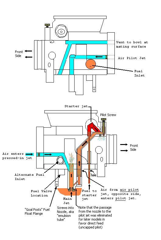

Got to say I was intrigued by this (Wookie's are easily distracted !!) so I found the below diagrams which may make it a little clearer (doesn't help solve your problem though Davido

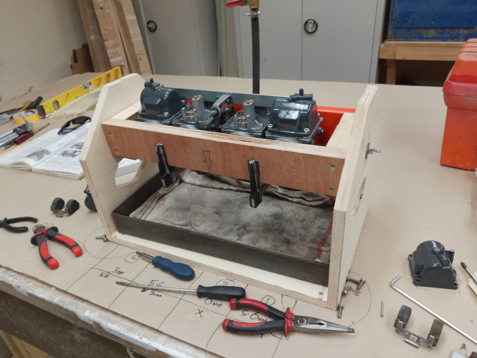

Yes,looks like it was the bowl vents.But not a blockage in the traditional way. Just me doing something stupid. (I new it was going to come down to that). I built a nice rack to hold the carbs and keep them level while doing the fuel level adjustment. Also with a swivel so I could flip everything over to get to the bowls. Problem is,to hold the carbs in, I had a plank across the airbox ports on one side and a plank across the engine ports with a couple of clamps to hold everything together. I must have been blocking the bowl vents on No.2!!
As soon as I took the carbs out of the rack to check the vents I turned the fuel on and ....No leak. Everything in order. Fantastic.
Tomorrow,I have to adapt the rack so it will hold the carbs without blocking anything, then I can finally get the fuel levels checked and adjusted.(fingers crossed)
