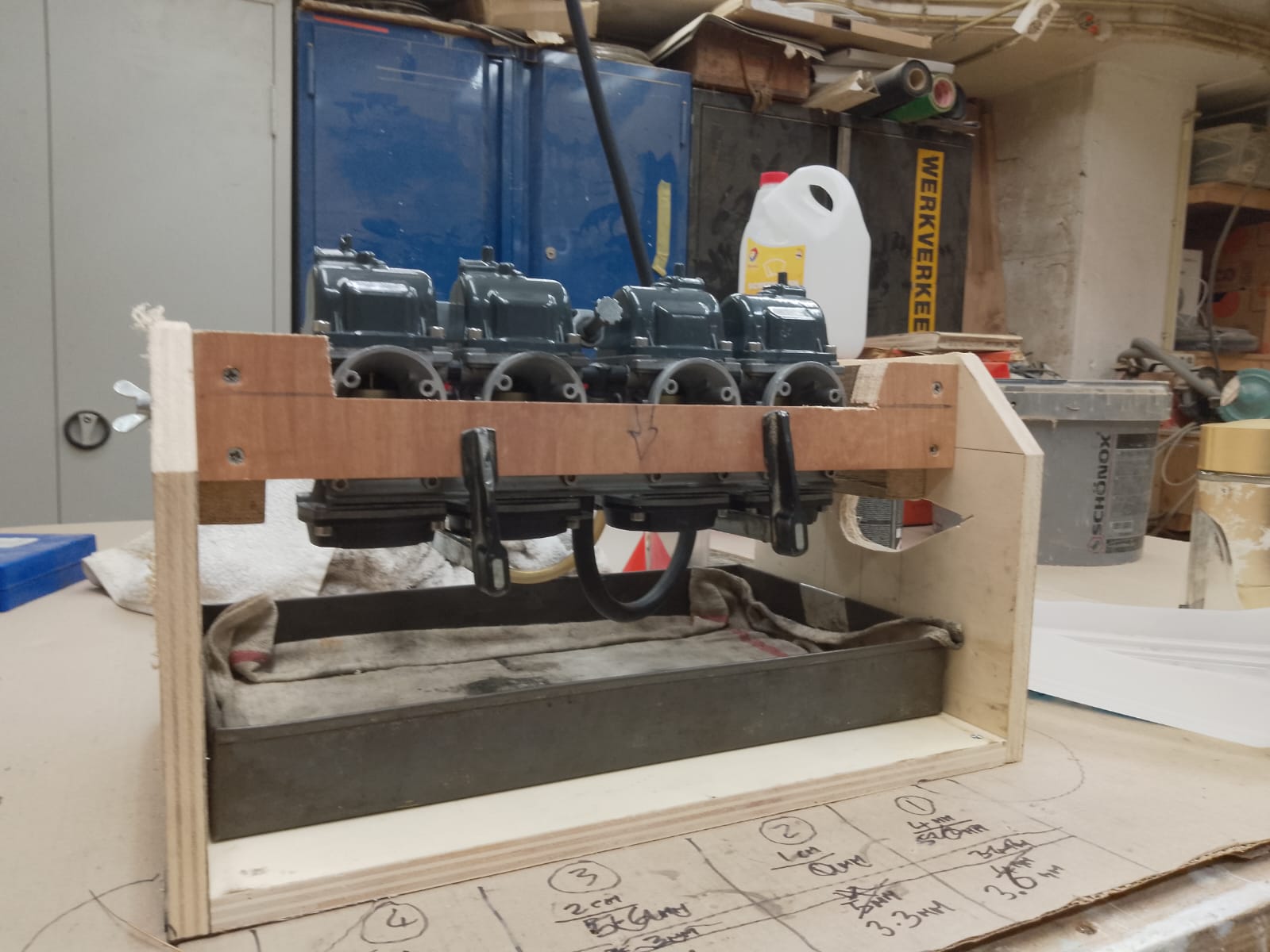

Perhaps you could throw together something like this.

Butchered the carb rack to get the clearance needed for the bowl vents. All went well.Yesterday I got the levels sorted on No.1 & 2. Today I did 3 & 4. No leaks,fuel levels sorted,carbs ready to go back on the bike (weather permitting).
Thanks again for everyones input and remember, if you build a rack to hold your carbs........!

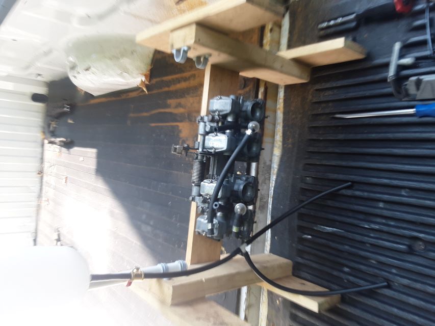

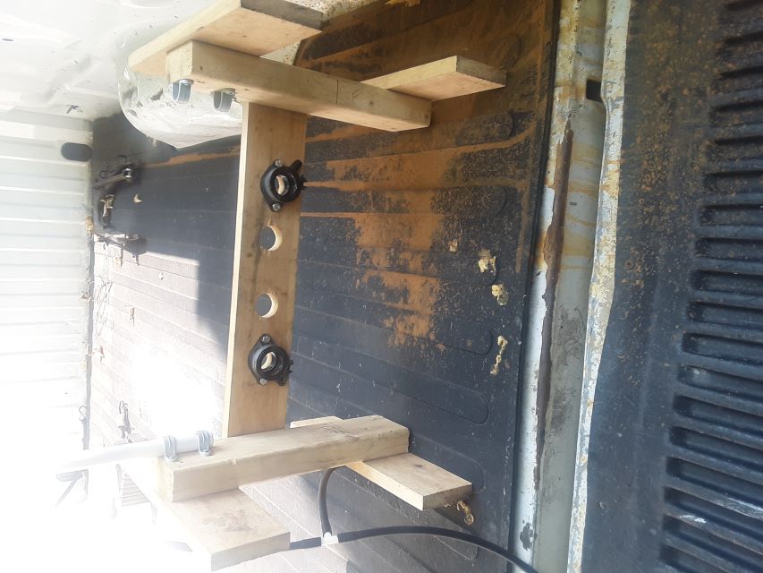

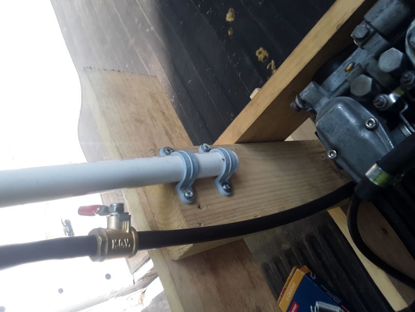

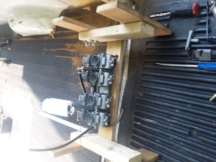

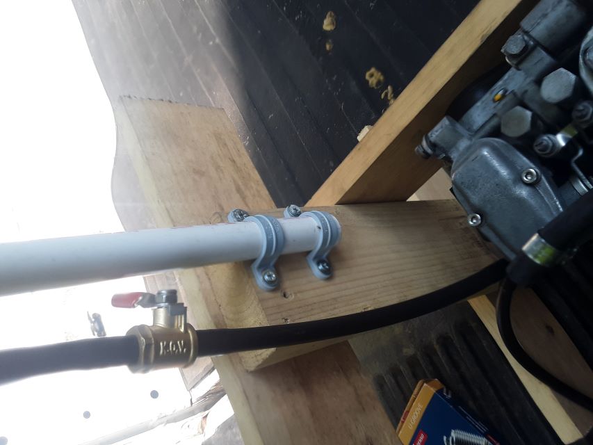

Hey davido.
I attached some photos of my carb rack after some revisions. I had copied a rack that Mikaw had made and added some more features. The legs are set up so you can position the rack in any of 4 positions, holes for bench sync, access for jet and needle changes, remote fuel to set floats. The tank is supported by a length of 1/2" pvc pipe in conduit clamps and the carbs are held with an old pair of manifolds.
About the only thing it won't do is decide what jets to use!
Attachment not found
