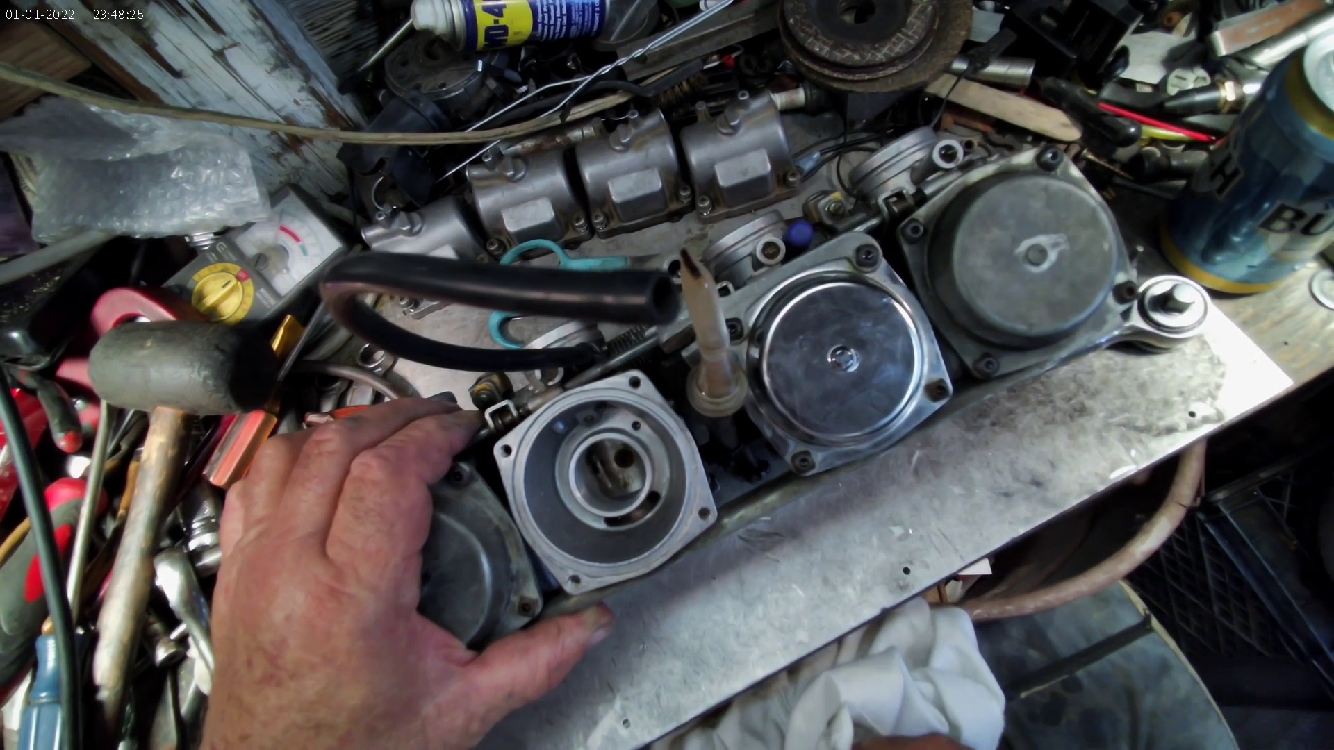

The 94 KZP I'm working on has an adjustable pull cable at both ends but the return cable has only one at the throttle and the other slips into a solid boss. They aren't interchangeable.

They only go one way with these carbs.
rumble.com/v4sw5nc-carbs-back-on.html
