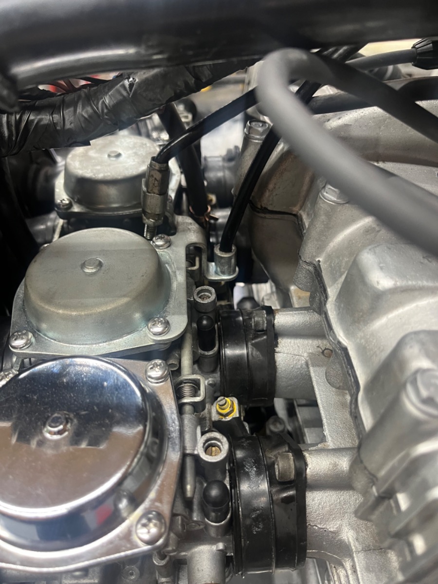

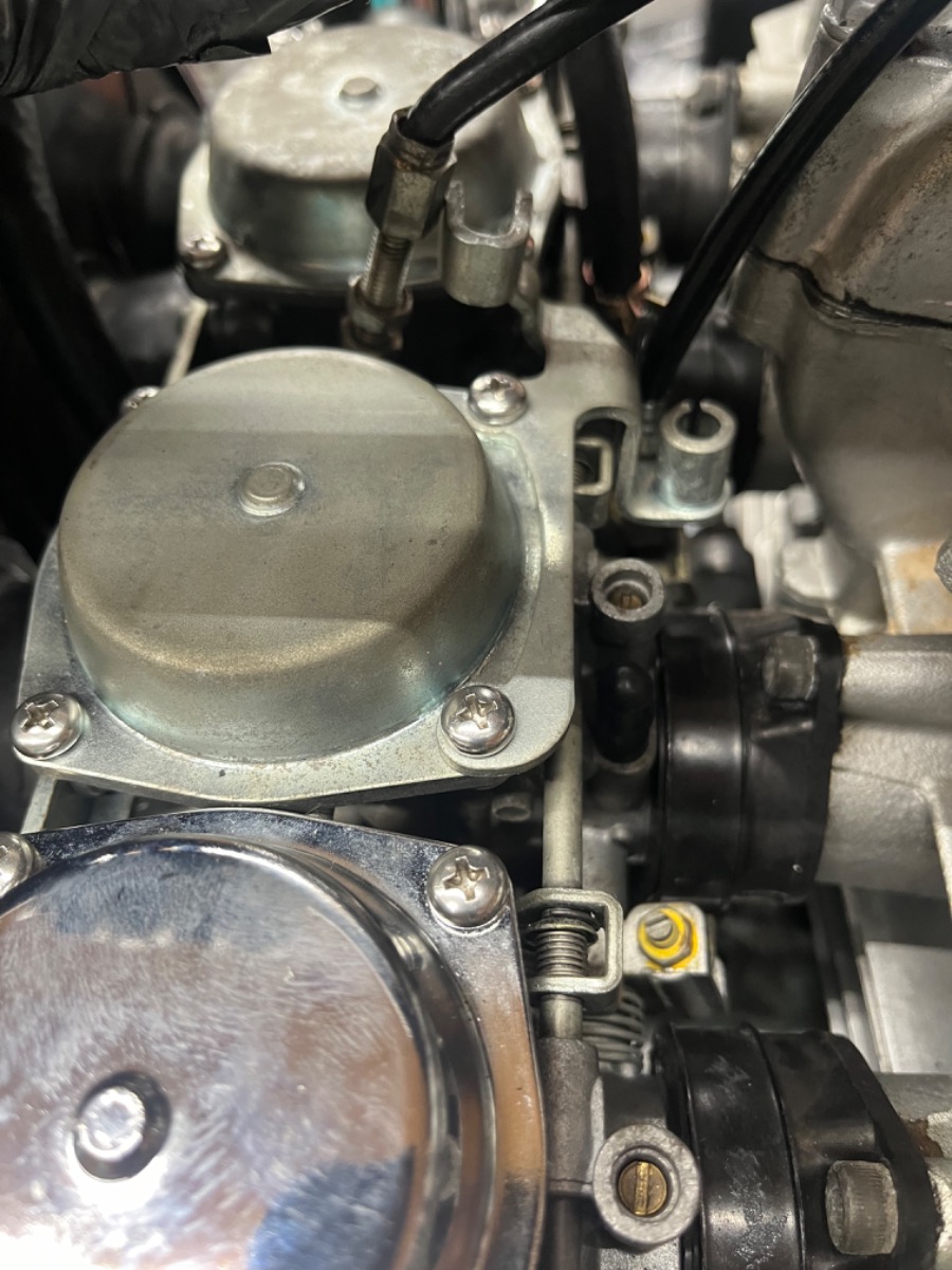

Does anyone have a source for the return throttle cable for the (2002) KZ1000P, part number 54012-0044, or possibly an alternative cable as the originals appear to no longer be available? I have been looking but have had no luck. Thanks in advance.

I’ll give it a look and see if that’s a possibility. My cables are still intact and are definitely different on the carb ends, although they are the same length. Thanks.

The 94 KZP I'm working on has an adjustable pull cable at both ends but the return cable has only one at the throttle and the other slips into a solid boss. They aren't interchangeable.

Are you sure that it’s not the return cable that has the adjuster on both ends? On my bike the pull cable 54012-0043 has the adjuster only at the handlebar and costs about $43. The return cable 54012-0044 has the two adjusters and costs $27 and is no longer available. I assumed it is a lighter cable for return and cheaper because of that. I’ll have to recheck to be sure now.

They only go one way with these carbs.
