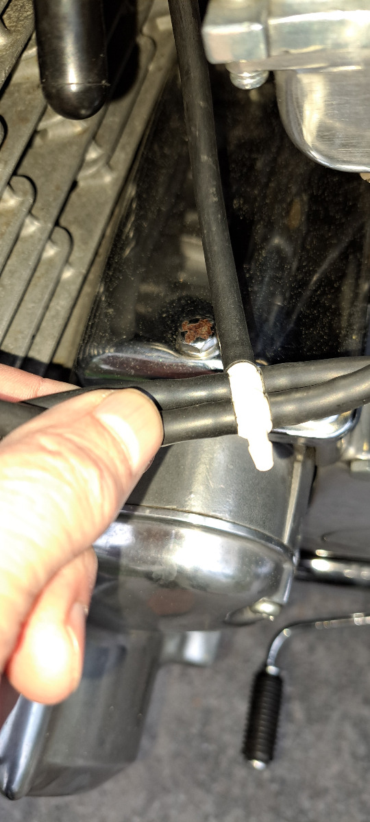

Thanks for answers .I have been thinking more about the dribling fuel out of synch rubber boots.The boots are sitting at about 4- 5 o clock not at 6
i mean they are not at the center bottom.Doesent that mean that it has to be a little more fuel in there than expected?

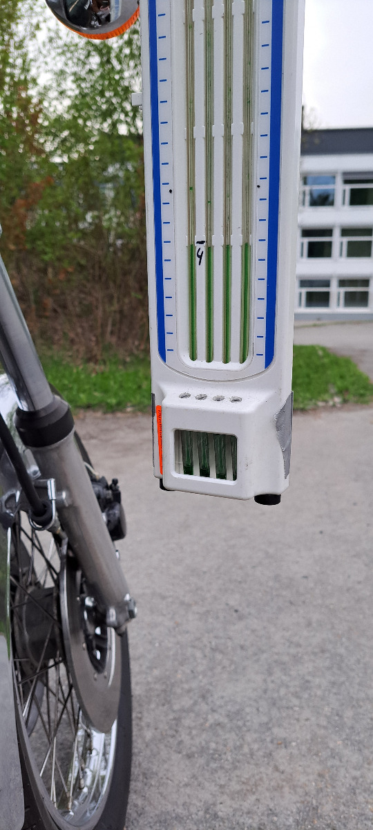

I tried to synch the carbs again and it is not possible the right way with the motion pro tool i have.If i connect all 4 hoses the fluid gets sucked in to engine at low idle.So i just connected the main calibrating hose from the tool and connected one carb in order.That way one carb has to pull on all 4
straws on the tool.The carbs are pulling the same amount of vacuum this way so did not made any adjustments. I will try to find some air restriction
valves and put on the hoses or buy a morgan carbtool later.

Fuel in the rubber vac caps is normal.
They are subject to vacuum when the engine is running and once the engine stops the negative pressure draws in any fuel mixture that is in the inlet tract.
Their vertical or horizontal position doesn't affect the amount fuel mixture they will draw in and unless the manifolds were mounted 180 degrees with the caps pointing upwards they will always hold fuel for a while until it evaporates.
As for the emulsion tubes, they are not subject to wear so won't need replacing and unless the carbs have done a million miles the needles and needle jets shouldn't have suffered enough wear to be significant.
