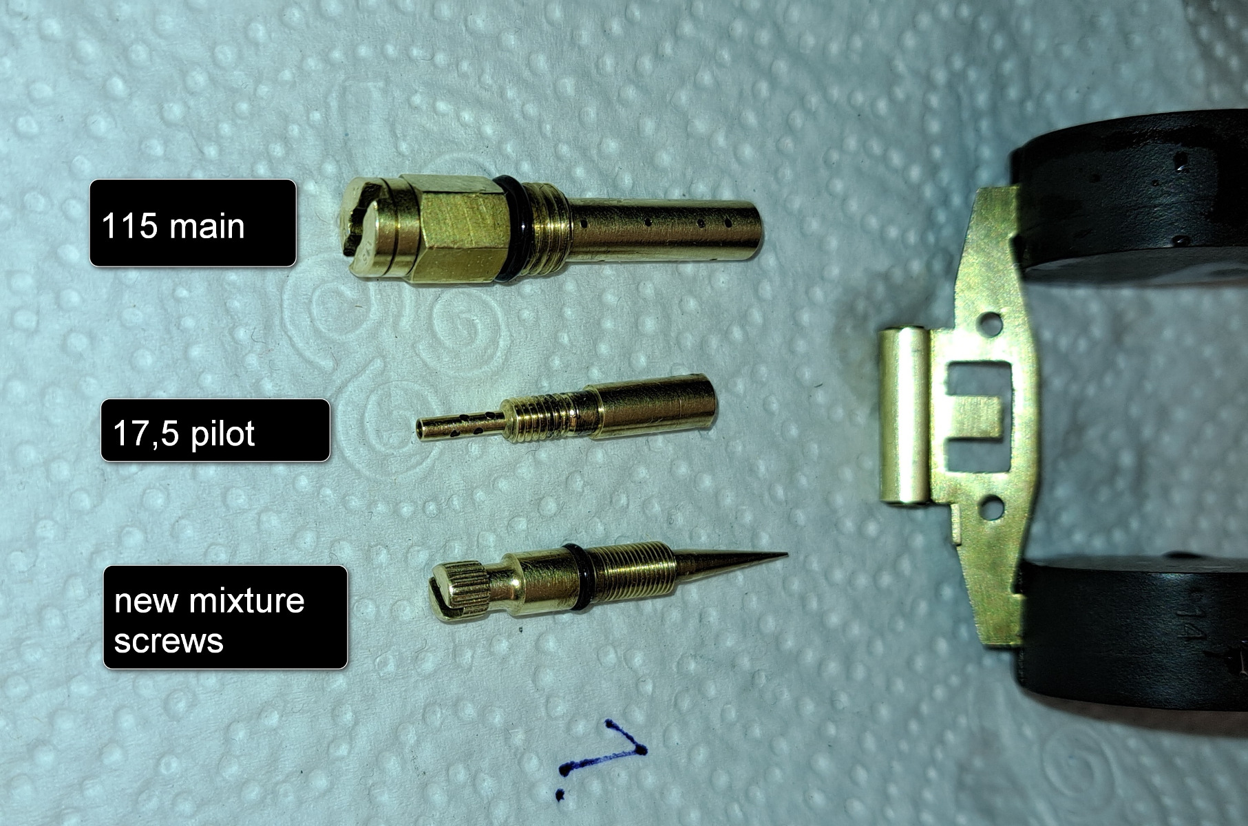

Just discovered something strange .I have been tuning the mixturescrews last days/weeks and bike runs good ,but also sot the plugs after using choke at startups.Then when riding it harder with high revs it clears off the sot. Today i was going to sync the carbs and dicovered that when pulled off the rubber boot on the sync tubes fuel dribled out.That cant be right?? the fuel level was checked with clear tube and also tested the floatvalves for leaks this winter they dont leak or overflow the bowls even under a little pressure. The carbs was totally rebuildt this winter and all o-rings was replaced and new viton bowl gaskets. The plugs also sotted down back in august/sept when i just have bought the bike So this must be the jetneedle sitting to high. Is it possible to adjust the jet needle when carbs are in the bike?

What position are the needles set? Pilot jet and main jet sizes?

only thing i did not chech was the position of the needle clips .the jets are 115 main and 17,5 pilot
