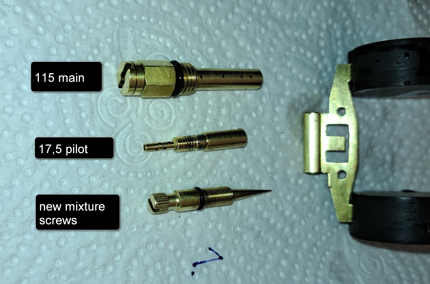

only thing i did not chech was the position of the needle clips .the jets are 115 main and 17,5 pilot

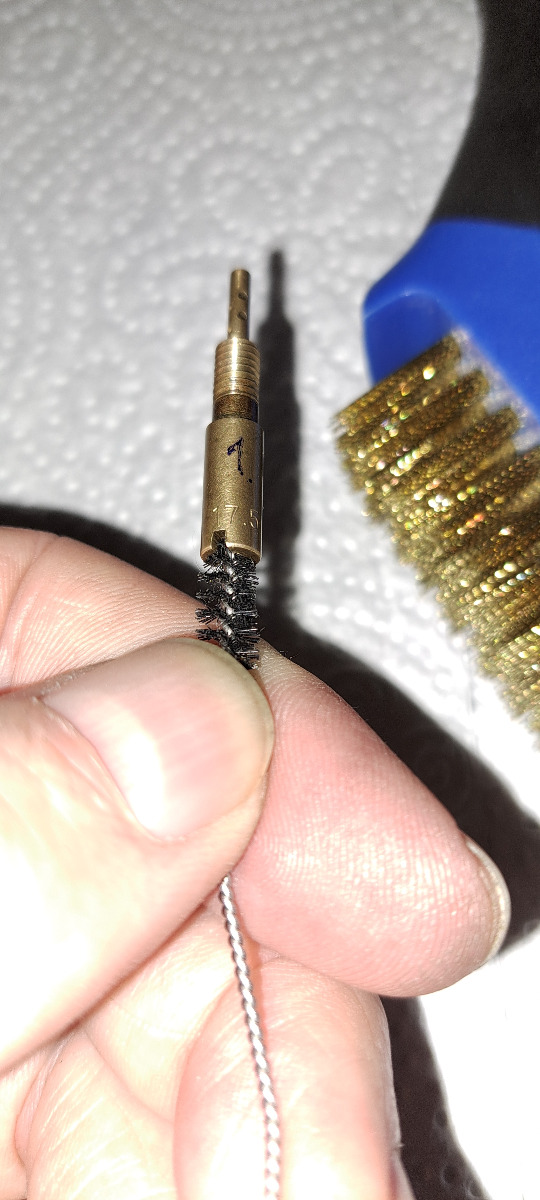

Many of the carbs that I do, the pilot jet opening is so small the only thing I have found to clean them with is a single strand from a bicycle brake cable.... some time in ultrasonic also helps
