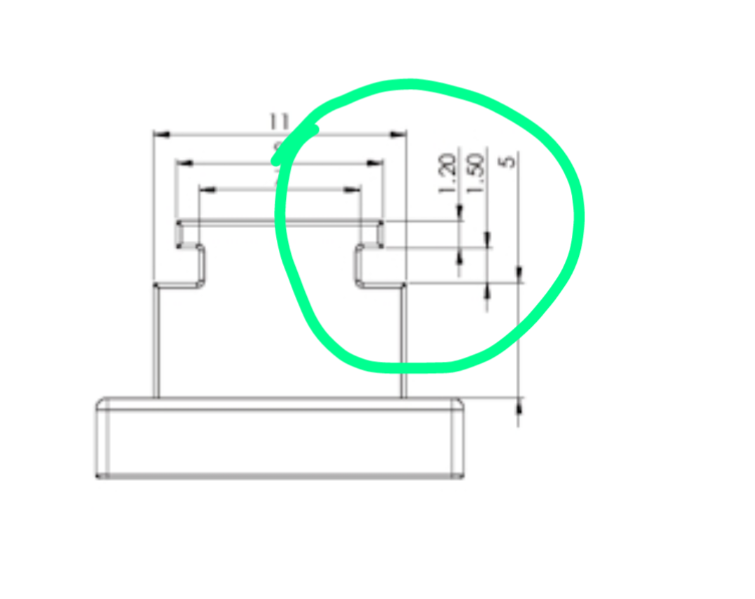

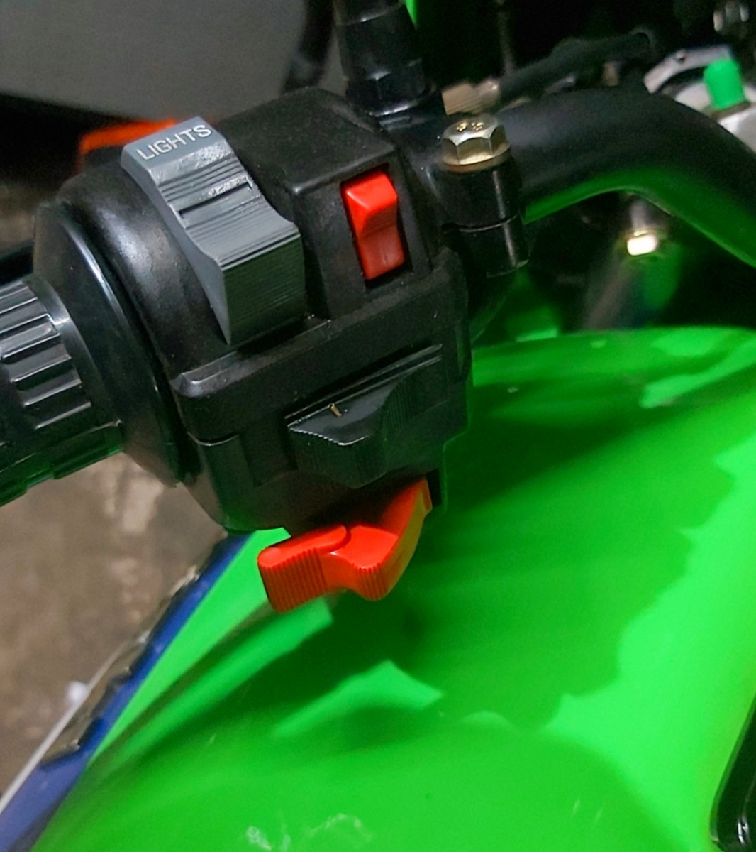

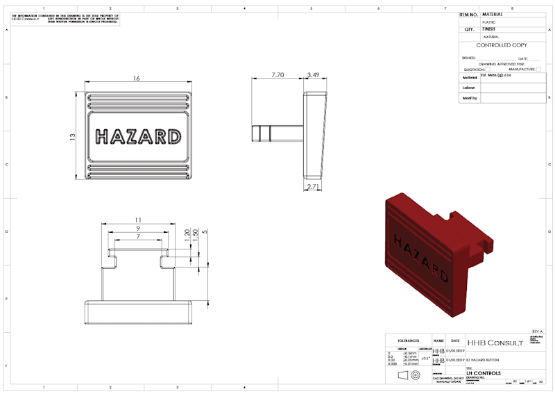

I've drawn the button according to what I see in your pictures, and all dimensions are ASSUMED, for now.
H.

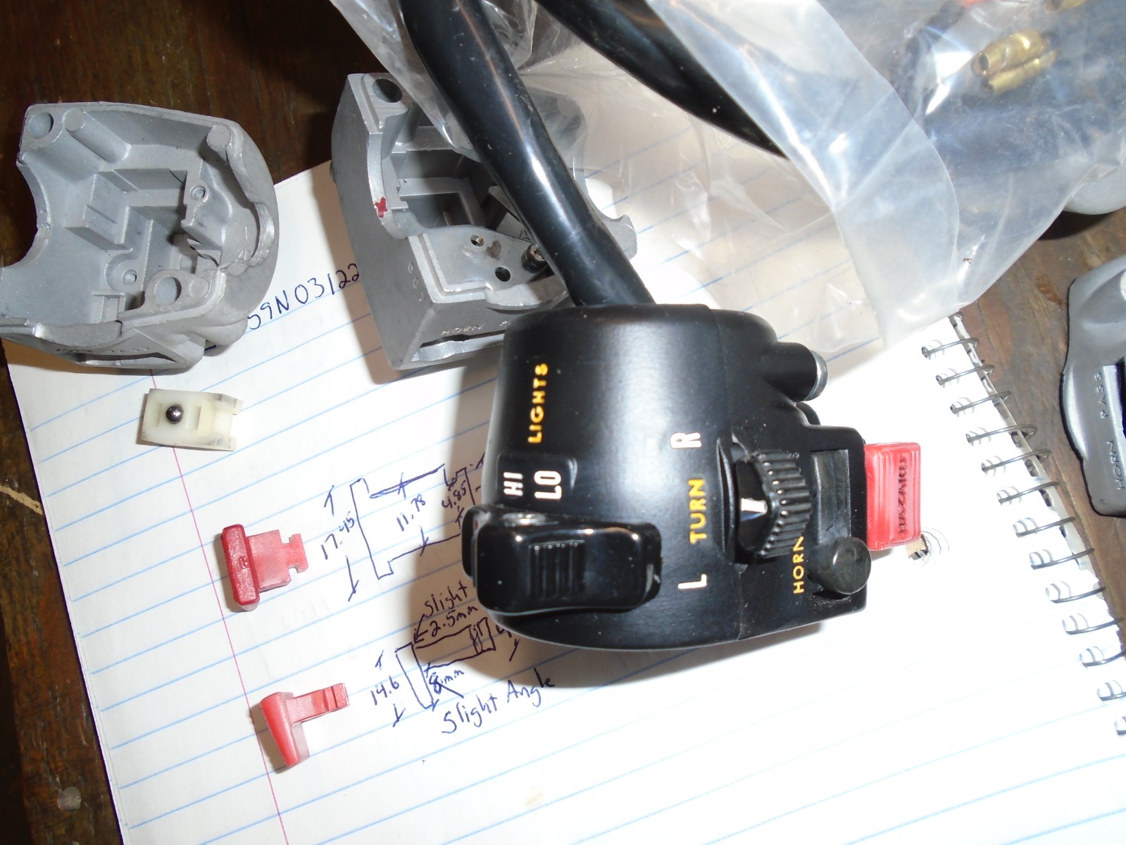

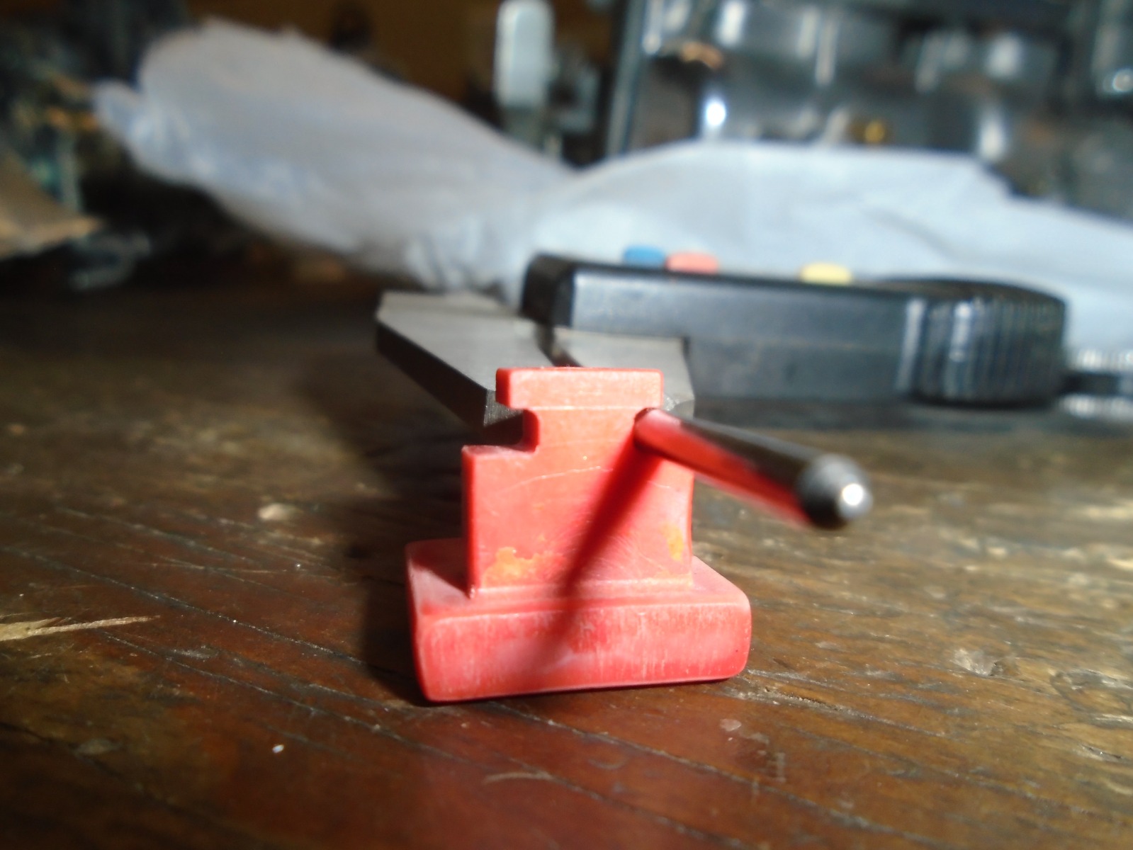

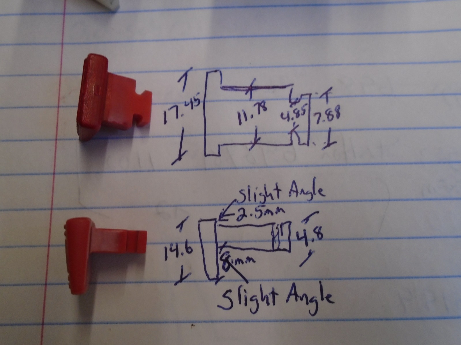

WOW, You have tech i wouldn't have a clue how to use!! Here's the old fashioned way. Note that the plate with the "Hazard" feature isn't perfectly perpendicular, slight angle. Other than that i believe You have it rangled!! Here's a finished "thru bar harness" version for a 1978 LTD 1000 for completeness.

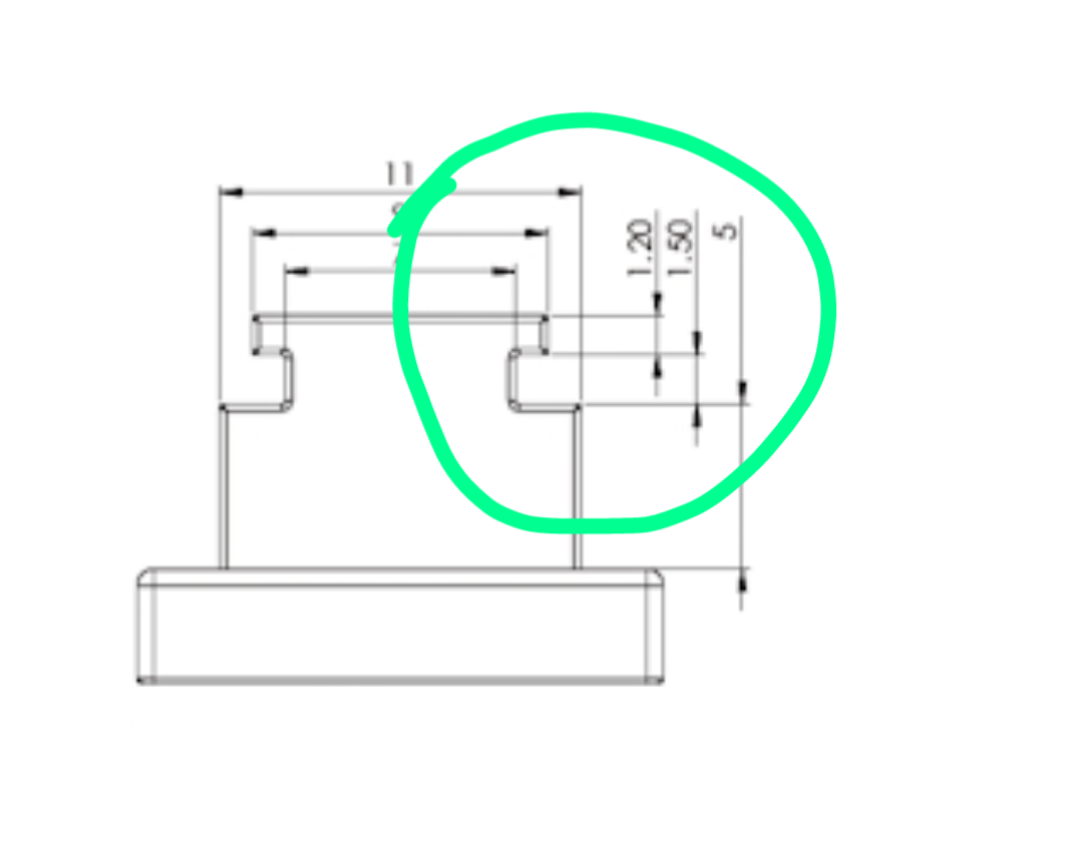

Thanks for those dimensions, this gives me an idea of scale...
Could you measure and correct the dimensions I've circled in green?
It would be helpful if you would correct all my dimensions...
I need to print a few "prototypes" to identify the best way to position the model in the printer for best result.
H.
H.

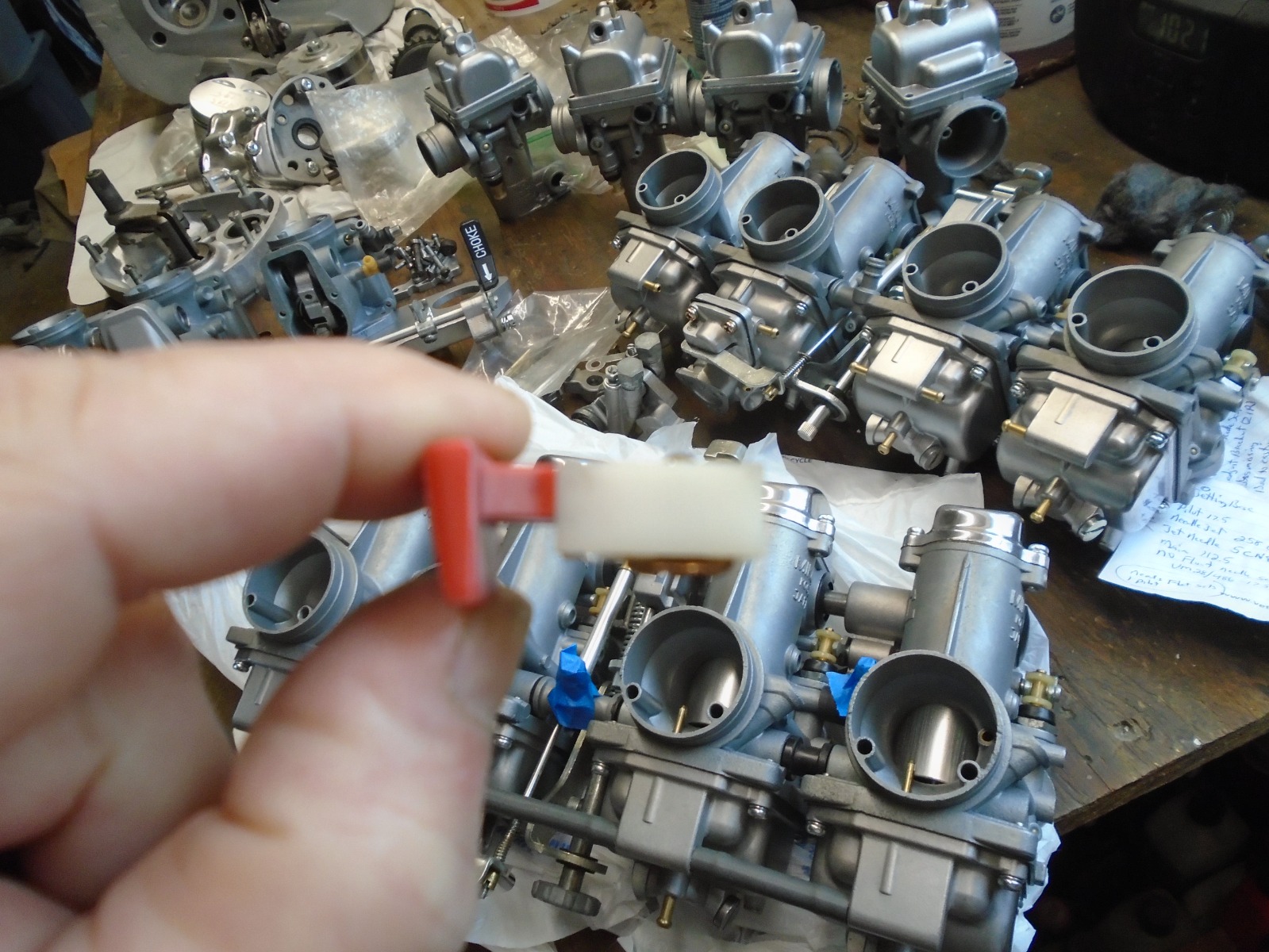

Does this give You any insight? Kinda hard to measure from the curvature or centerline but.. What You relly need is a "hold-in-hand template"! Seems the 3/32" pin is a close approximation of the latching feature which solves that (1.5 you have pictured). So crude measuring shows that the reduced latching area is approx 1.85mm at the leading edge before the plastic reduces and/or Your 1.20 mentioned section. The flat (5 shown) is about 7.10mm. Help??
