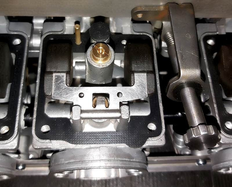

Sprite eye CraZ, yes there is an approx 45degree splice where the ends meet. I purchase this o-ring material in bulk from the O-Ring Store. And Ed I suppose since You might not get up at 3am like i have to but did You get that email concerning shipping the semi complete KZ900 stuff? Regardless, YES i share Your concern pertaining to "creeping" and consistency of torque over a period of time under heat/natural degradation of o-ring stock used and "not" being in a confined land on one side over a useful life. Addressing the "squish-out or creeping, Not an issue. Maintaining enough force. This is accomplished by not ham-fisting down initially but uniformly, You can feel/denote when it's solid using the correct pan head phillips screws, not those often over torqued allen sets. Using the captured split washer panhead screws the tension in the split washer over time compensates for material relaxation. Don't know if You,ve ever been around the old CB160's but the carbs slant foreword and are notorious for being a weeping mess. And that was an early Keihin which used a "flat" rubber gasket like the similiar CBseries back in the day. This procedure quickly resolved the issue with the 160. Slimjim, got all your next publication ready for print yet? And, no commercial/Amazon available for this, all done the artisan way one at a time depending on application.

22 Jan 2024 05:35We've cut gaskets too. At least slmjim has. The Lovely Z1BEBE sez it's too tedious. This from a woman who spends hundreds of hours piecing together king-size quilts from 4" squares arranged just so.You can buy o-ring material and cut to size which is what he has done I believe. I have heard of people doing this with their bowls but haven't tried it yet. I just made a set of gaskets from a rubberized gasket material for the VM28 carbs because I couldn't bring myself to ordering a set. I had one as a guide. They turned out pretty good but we will see once they are on the bike.
If you look at his photo there is a splice

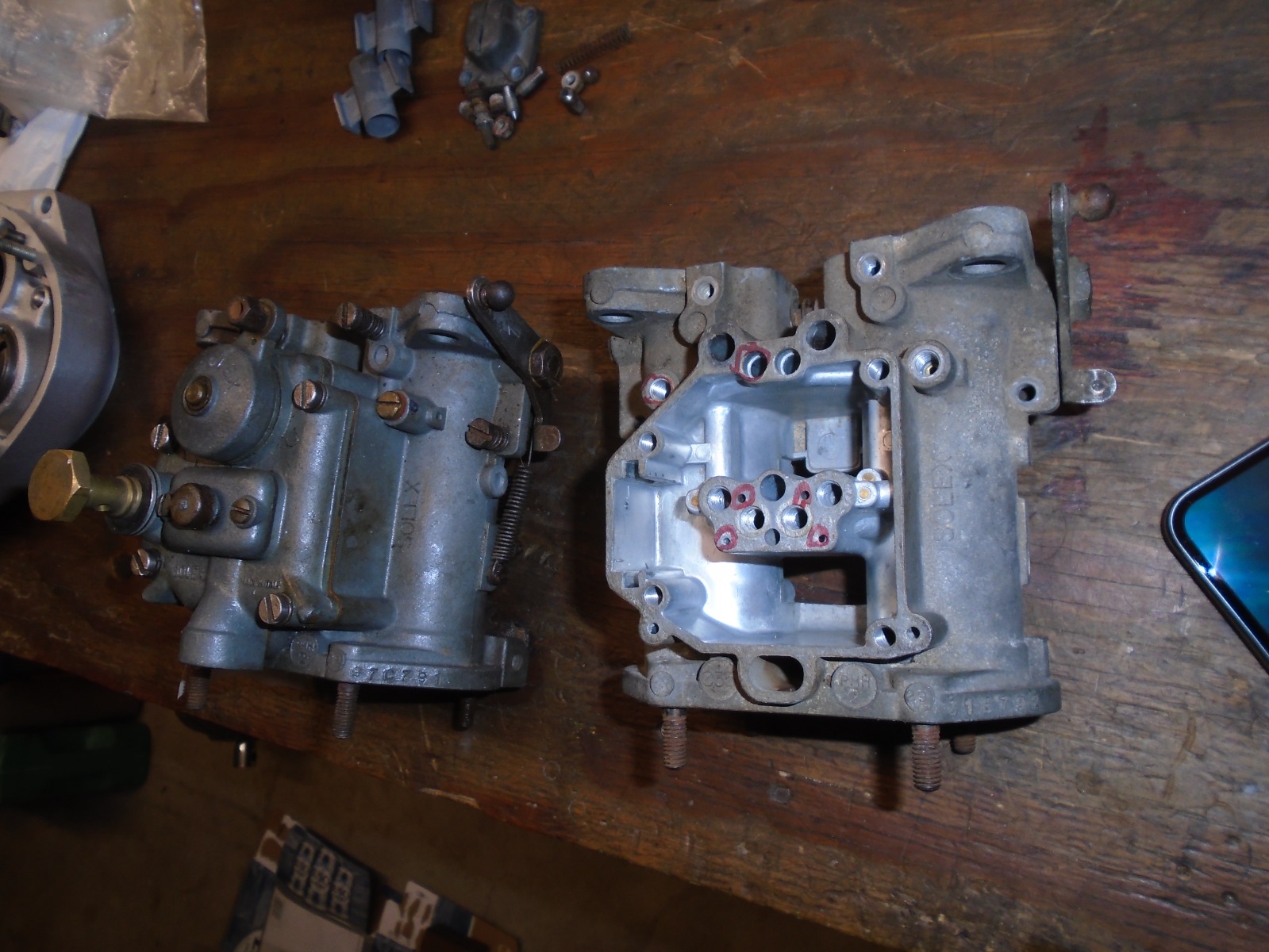

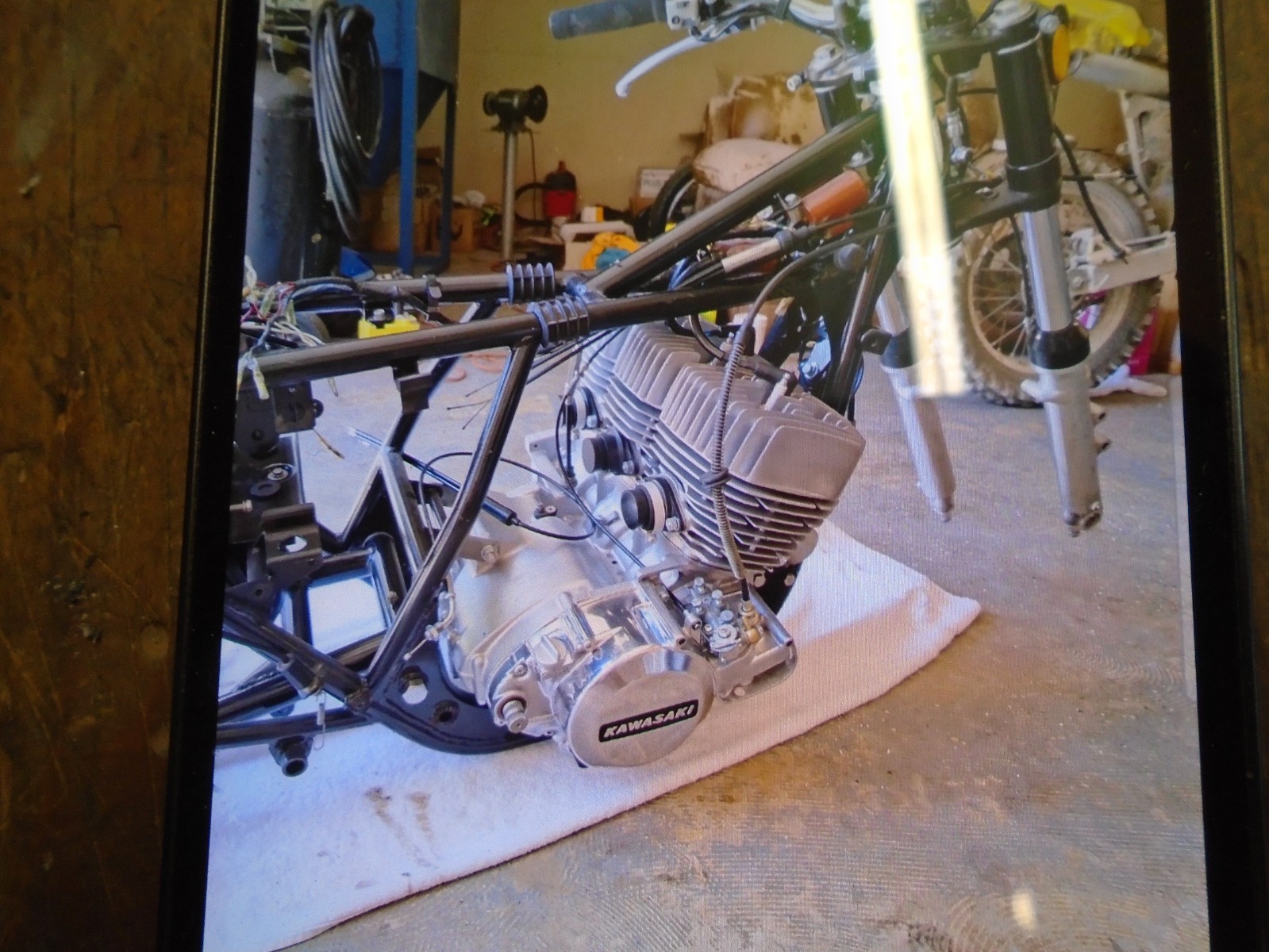

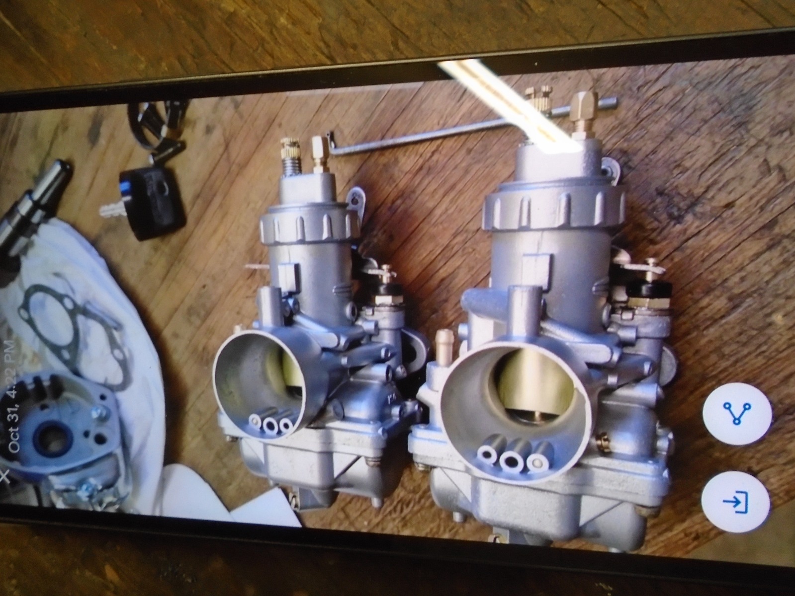

If those Airevalley replacements provide what's needed that's all one needs and i applaud someone's effort/insight and production!! Perhaps my concept is too daunting for the average or even highly competent wrench, not that You couldn't duplicate and/or maybe thought about it? You have to realize i just don't exclusively work on these bikes. So i had to find a "common", practicable, cost effective, expeditious (whereas bits have been long since unavailable) and still be fully functional over a period of time. Here's a set of the early 70's Suzuki T250 carbs and a set of the Solex Lancia Fulvia, everyday is a new adventure, Yeah! And some other stuff i've since completed, everyone is Happy and that's the name of the game.

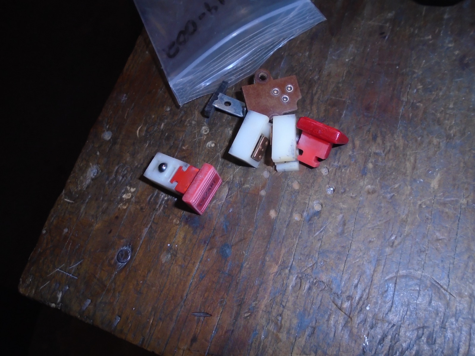

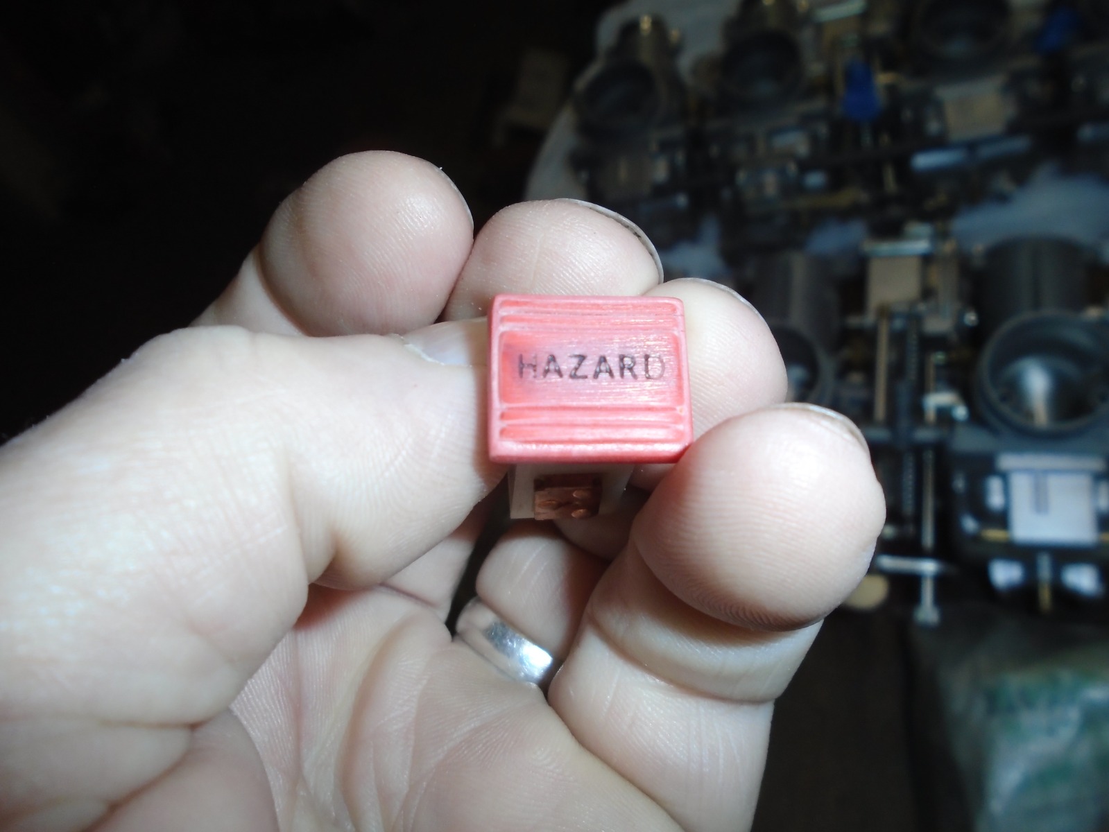

Those "pesky" red push/pull Hazard buttons are a perfect candidate for 3D printing!
If someone could post a few more views of it, and some dimensions, especially the area where it attaches to the white plastic "switch block" that holds the copper contact and spring-ball, I will give it my best shot!
H.

If You choose to take on this "outside the box" thinking, I'll make it simple for You. I'll send You a couple original sets of the lower switchblock castings and parts shown for first-hand inspection. Then experiment! Just will need address for posting.

23 Jan 2024 09:45 - 23 Jan 2024 09:47Would love to have one of these. If anyone could do I'm sure you could Howard !Those "pesky" red push/pull Hazard buttons are a perfect candidate for 3D printing!
