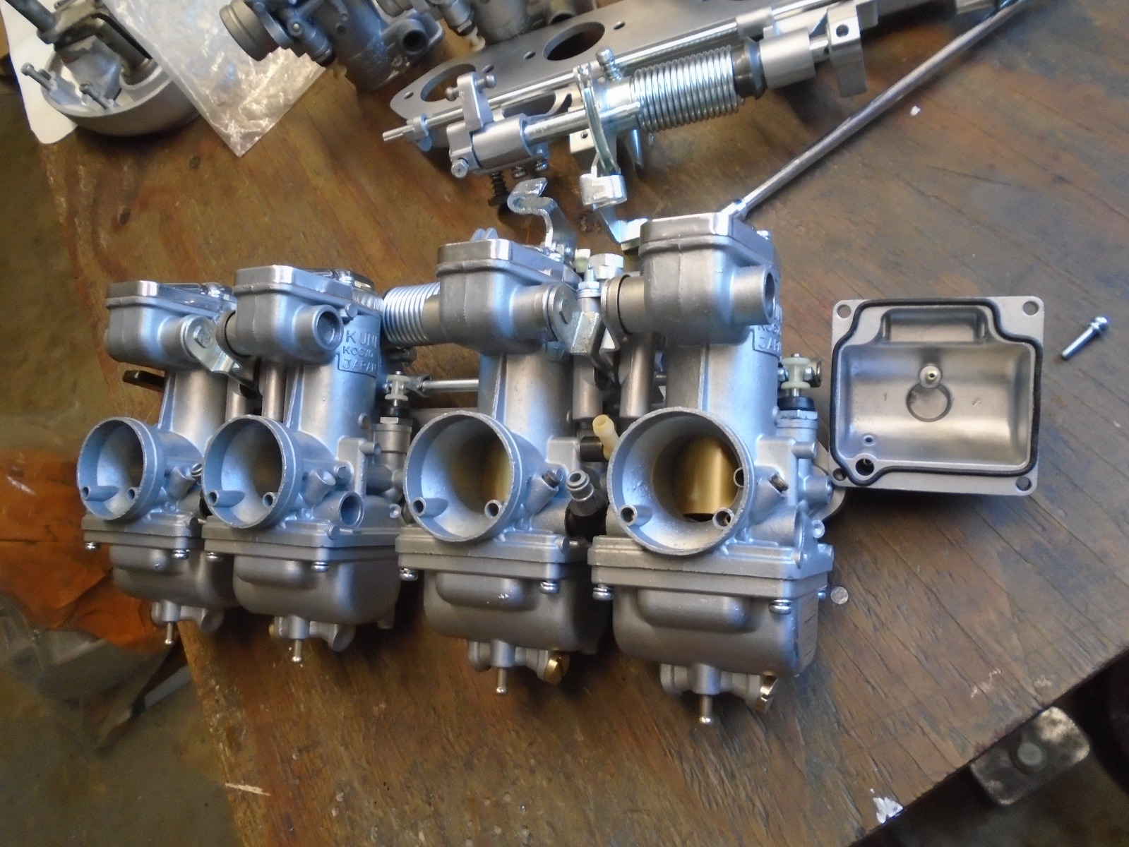

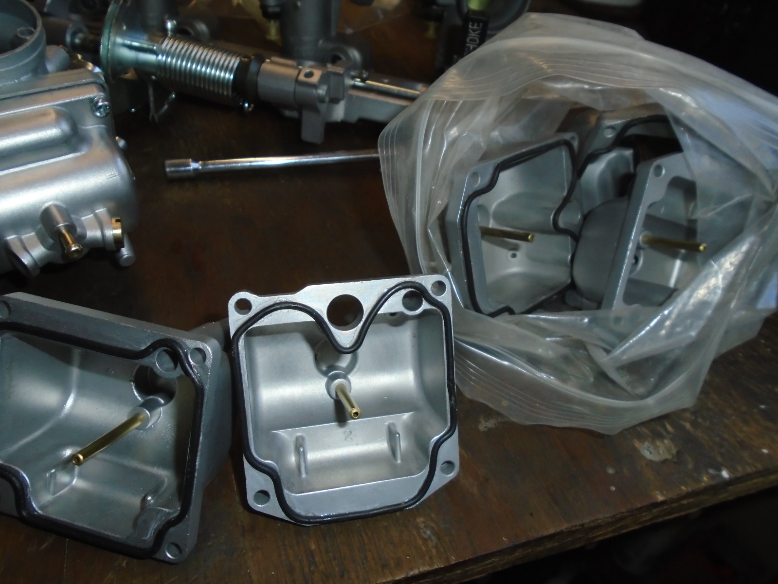

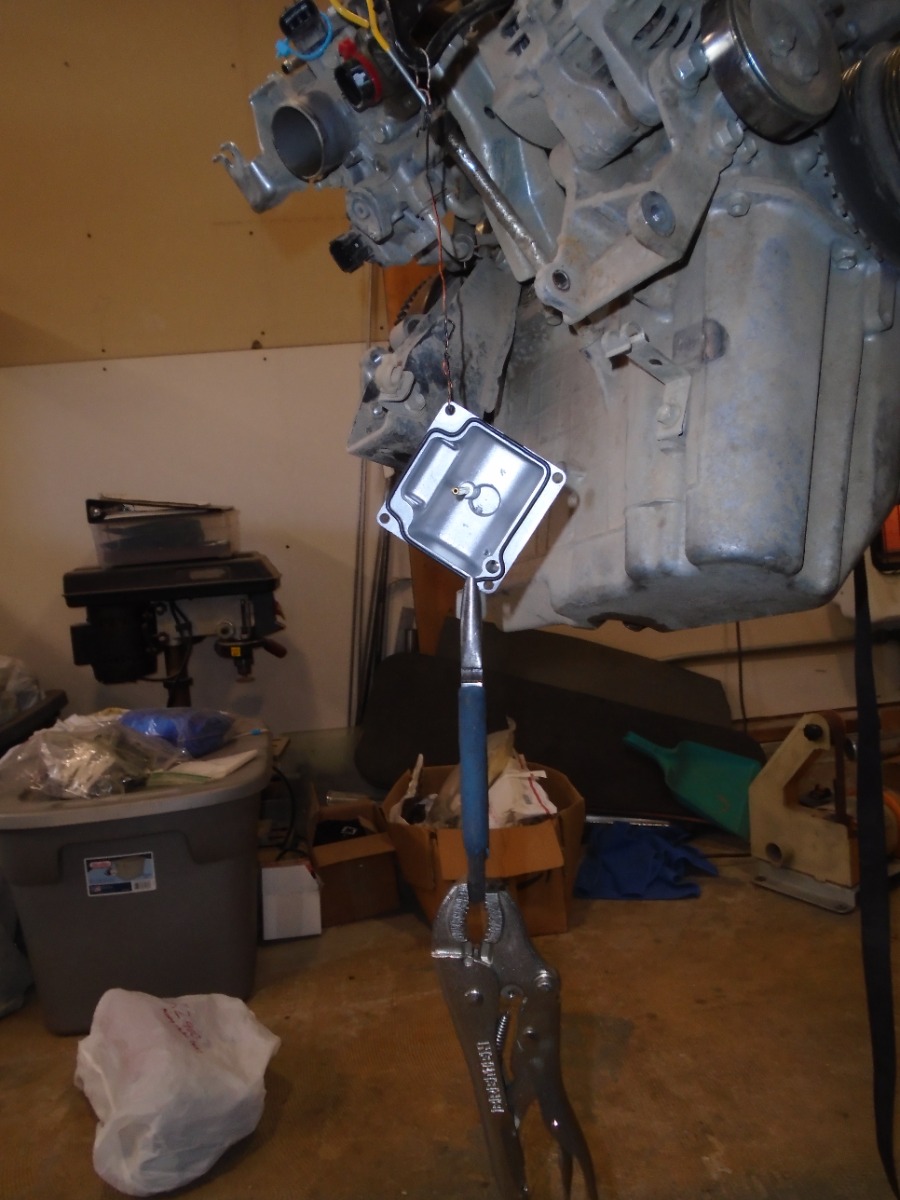

Some info You might find unique but quit hitting that same wall of purchasing Keyster/KL etc, crappy paper gaskets, at some point one will realize none of those either glorified or Chinese replacements WON'T resolve your weeping or flooding between the sealing surfaces between casting and bowl. I often see person's "think" it's the surface flatness of the bowl, super rare if ever the case. It's the Fact that after years your carb castings have submitted to constant pressure from the 4 points where the screws hitch down the corners. Now...think about this for a minute.... When constant pressure is applied to the corners of a pot aluminum beam, what's that going to do to the center of that beam?? It's naturally going to arch under the outward pinch points and leave the centerline of venturi exposed to paper shrinkage, resulting slosh of fuel weeping at best, running out at worst. Also does it on the outsides but not as relevant because the span is not as much. Fella's, think-outside the box regarding this concept!! It works, have been doing it for over 15yrs and still stable. And as far as does the transplant oring migrate out of position, Ed. Last picture is of a hook needlenose plier with a big set of Vicegrips attached to the needle, probaly a good 2LBS. Even with tis weight bearing on one little sector, nothing moves, comparable weight paper would of ripped in half even the Keyster. Just saying, FSM has to be a templet but not the means all to what if efficacy. Have a Great day fellas.

Yes, I was sent a couple sets of those viton gaskets a couple years ago by a friend. They were soo ill fitting i just chucked them in the trash can though. Even tried cutting the corners off around the 4 screws to relieve some of the compressed material surface area in this area to transfer compression to the center where it's needed. Still dumped fuel. These were sent by a Friend that Does carbs for others. Perhaps nobody realizes this issue because when wet testing i've yet to notice anyone mentioning a "tilt-test" when bowls are full of fuel still off bike? On these VM carbs when fuel level is correct it's still below the sealing joint of course. But..still full of fuel tilt the bank foreword maybe 20deg, then back approx the same. Let them stay in both for/aft positions maybe 20minutes each way. Then swipe your finger around the casting joints and smell your finger. There's a joke in there too but i won't expand on that, ha. Anyway, you shouldn't smell any petrol or detect any wetness. This more of a dynamic (real world) test, fuel sloshes ya know. The beauty of the oring thingy is it provides a "pinch-point" rather then relying on the old-world design of flat-on-flat-on-flat. And also completely reusable.

20 Jan 2024 08:36Clarification please. Are the pictured VM28SS O-rings available commercially? If so, from where?Some info You might find unique but quit hitting that same wall of purchasing Keyster/KL etc, crappy paper gaskets, at some point one will realize none of those either glorified or Chinese replacements WON'T resolve your weeping or flooding between the sealing surfaces between casting and bowl. I often see person's "think" it's the surface flatness of the bowl, super rare if ever the case. It's the Fact that after years your carb castings have submitted to constant pressure from the 4 points where the screws hitch down the corners. Now...think about this for a minute.... When constant pressure is applied to the corners of a pot aluminum beam, what's that going to do to the center of that beam?? It's naturally going to arch under the outward pinch points and leave the centerline of venturi exposed to paper shrinkage, resulting slosh of fuel weeping at best, running out at worst. Also does it on the outsides but not as relevant because the span is not as much. Fella's, think-outside the box regarding this concept!! It works, have been doing it for over 15yrs and still stable. And as far as does the transplant oring migrate out of position, Ed. Last picture is of a hook needlenose plier with a big set of Vicegrips attached to the needle, probaly a good 2LBS. Even with tis weight bearing on one little sector, nothing moves, comparable weight paper would of ripped in half even the Keyster. Just saying, FSM has to be a templet but not the means all to what if efficacy. Have a Great day fellas.

You can buy o-ring material and cut to size which is what he has done I believe. I have heard of people doing this with their bowls but haven't tried it yet. I just made a set of gaskets from a rubberized gasket material for the VM28 carbs because I couldn't bring myself to ordering a set. I had one as a guide. They turned out pretty good but we will see once they are on the bike.
If you look at his photo there is a splice
