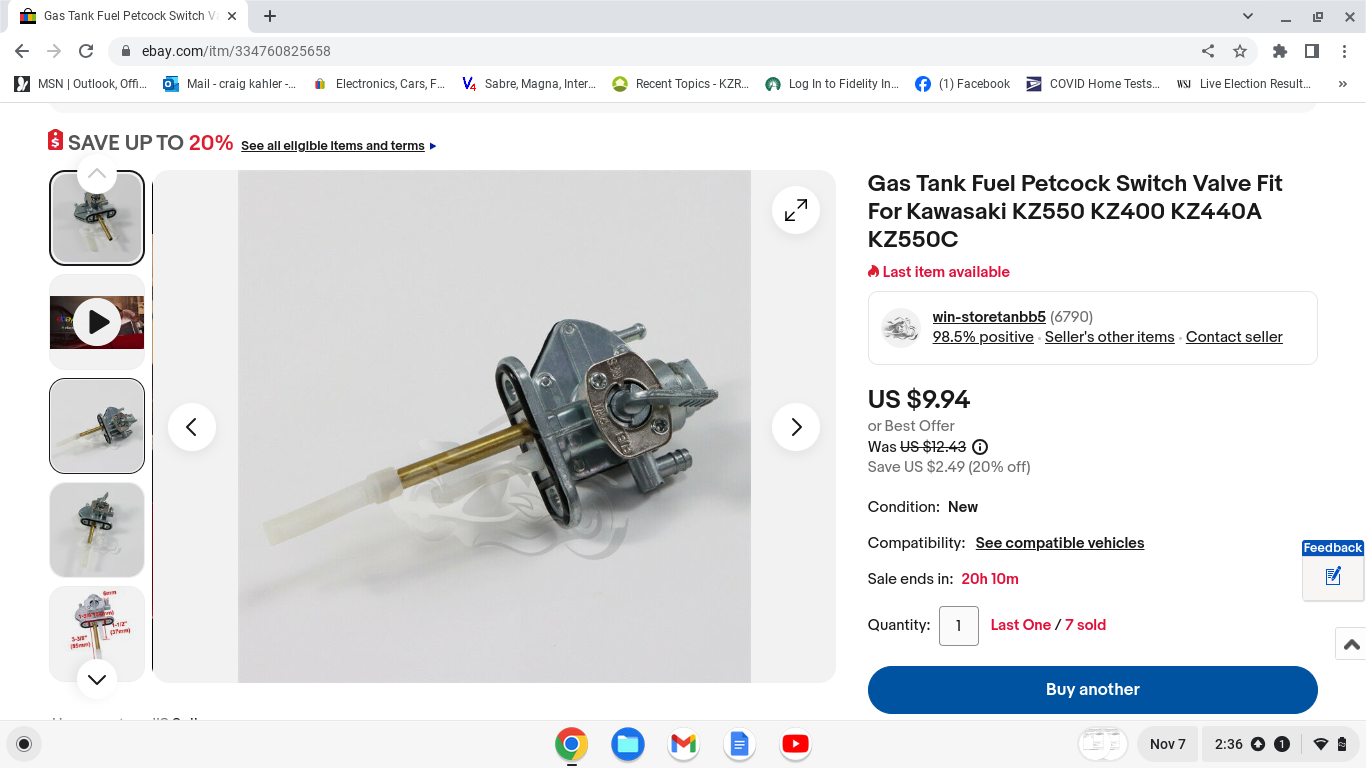

I bought this petcock for my KZ400. It actually works well, now that I have it figured out.
It is listed as a ON-RES-PRI petcock, but is actually ON-OFF-PRI
The face plate is labled wrong. The position marked "RES" Is to the left, where the selector lever can't even go, and pushed to the right the petcock is off.
By grounding off the word "RES", I now really like the function of this petcock.
Down is on (when vacuum is applied), horizontal to the left is "OFF", and up serves as both "PRI" and "RES".
