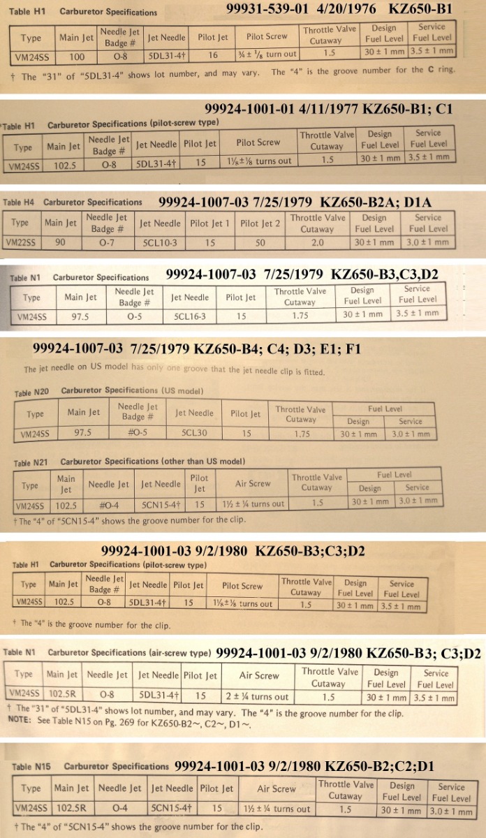

Here are some of the carb tables from some FSMs which show both design and service levels for float/fuel level.
1977 KZ650 B1

According to the info in the previous post your fuel level should be 3 mm plus or minus 1 mm. Stated another way...between 2 mm and 4 mm.
