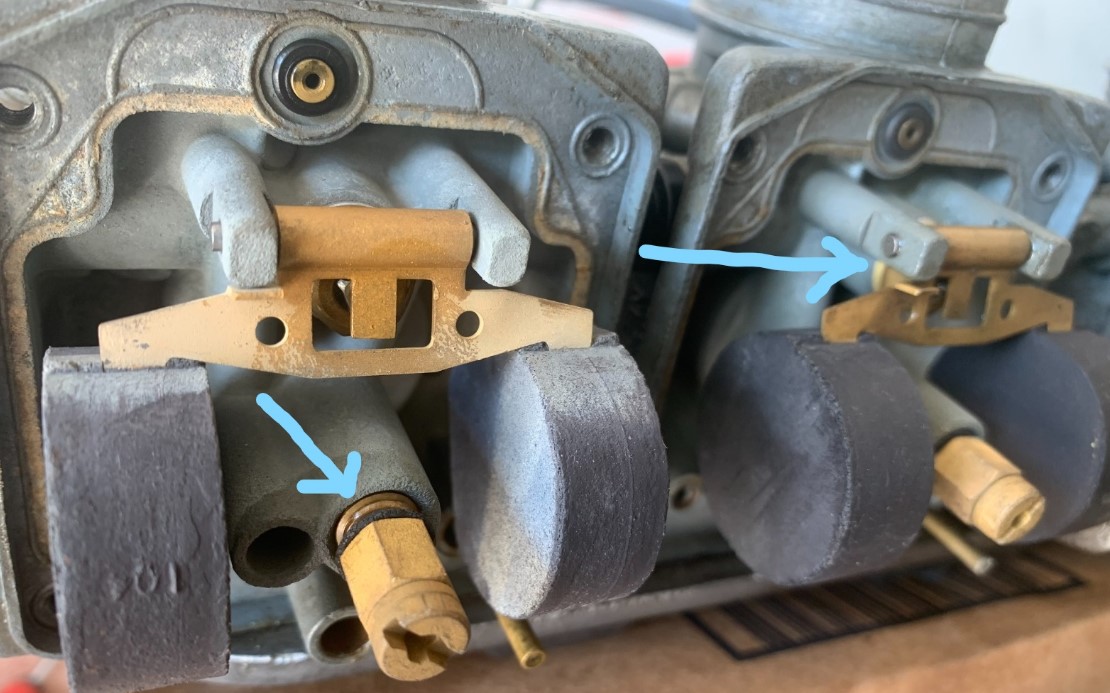

This morning I pulled the carbs. Number two is completely dry. (I'm old and couldn't get the drain plug out previously)One, Three and Four all have gas in the bowl. Here are pictures of the carbs. Let me know what you see and what I should be checking. Note: the valve needle on carb two does not appear to be stuck. Thanks!

I have to be honest, if these have been "gone through" I would ask for my money back. Ref the arrows on the picture - why are the jets hanging out of 1&4 with what look like very perished "O" rings and why is 2 not sitting on the stop like the others (is the float sticking?)

I agree with Wookie they sure don't like they've been cleaned or rebuilt. Sometimes like the old saying goes if you want something done right you need to do it yourself. I hope they didn't charge you much, I would demand my money back and never do business with them again.

They definately saw you coming, at least two emulsion tubes are hanging by a thread or two and why is there no balance tubes between the bowls?
Vm24 pumper have the bowls linked and if the floats are set so low that they don't piss fuel out the balance pipes and its 1 & 4 which have the emulsion tubes undone then that's why it's only running on those two. 2 & 3 can't draw fuel from anywhere.
That doesn't explain why one bowl doesn't get fuel though. There must be a blockage on that carb fuel feed supply.
Can you post a picture from each end of the carb rack so we can see the airscrews please. I wouldn't put it past them to have reassembled the carbs into the incorrect positions on the mount rail and seeing the airscrew positions will confirm either way.
