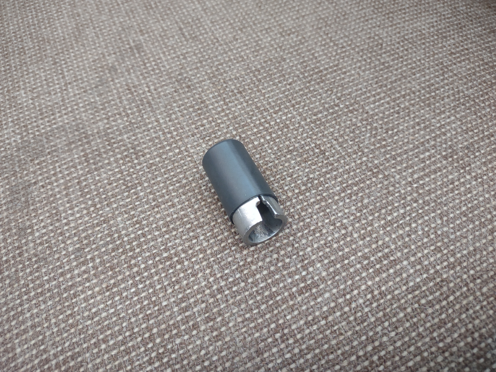

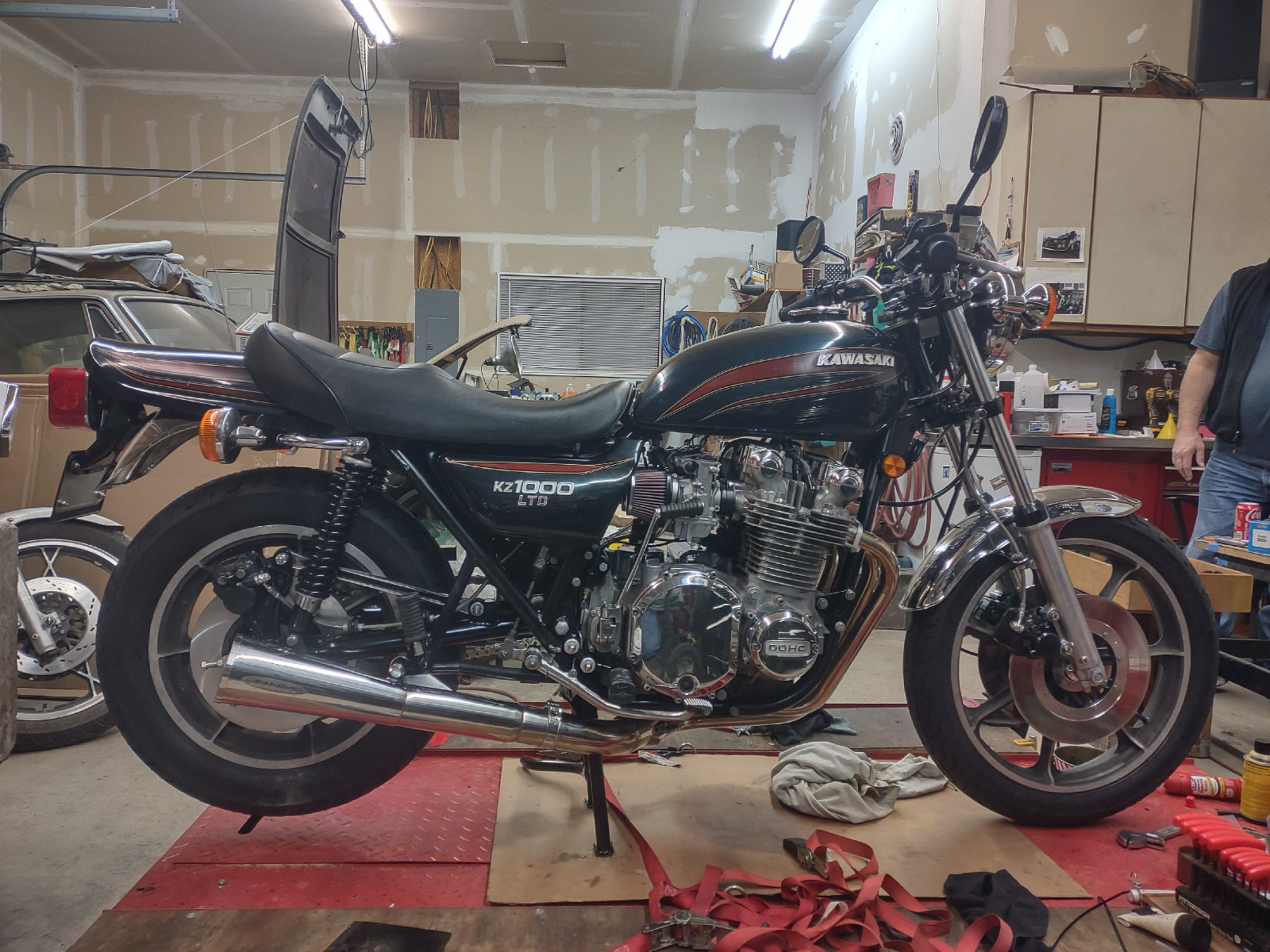

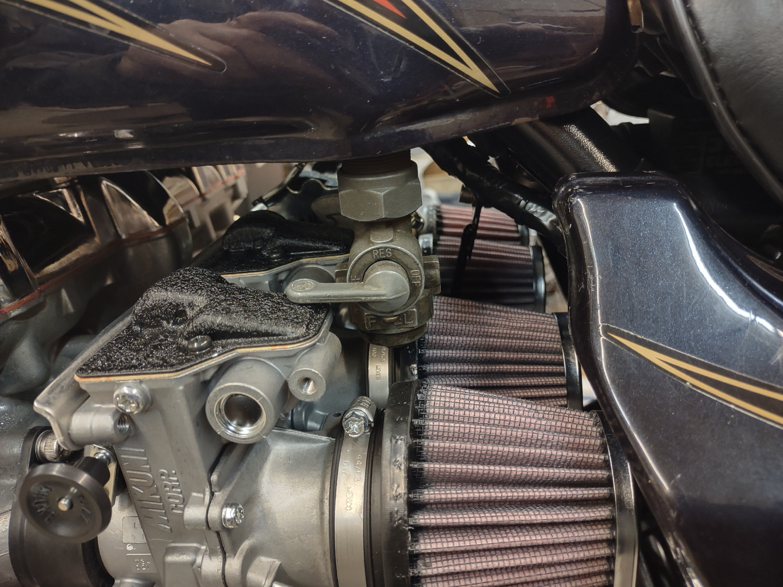

We just installed a set of RS 34's and a Delkevik stainless 4 into 1 on my 77' KZ 1000LTD and am very happy with the results. I think my buddy got them straight from Mikuni. We told them the set up (pipe, K&N pods, stock motor) and they come jetted properly. We've also put the same combo on the 80' Suzuki GS 1100E with similar results. You'll need to make a carb support and a second set of hands helps with assembly of the Delkevik exhaust system.
The only problem is the fuel petcock handle hits the #1 carb top with the LTD tank, I'm not sure of the other models. So I made a key for it from an old shock sleeve after I trimmed the handle.
