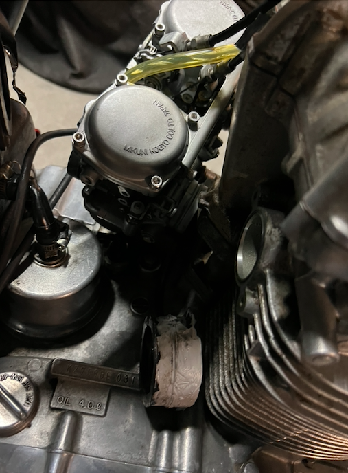

Thank you for posting. Btw I'm changing the carb boots on my KZ75.

Was pretty easy. Didnt even have to totally remove the carbs, just slid them to the side and put the new boots on.

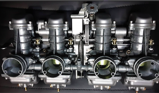

as Ive mentioned two bikes in this post, the carbs of which I speak are on the 650. The 750's i changed the other day had a leak on the manifold side boots. On the 650 the Carb boots on both sides are brand new, engine/cylinder cover are all tight, no leaks. Issue was dried O rings - ethanol related over time.
Carbs were gone through and will go back on the bike when the tank and rear fairing paint are done this week. Cant wait to post a pic in the appropriate area of the forum. These are the carbs off. So pretty I think.
Thanks again for the "leak" reminder
