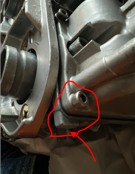

Stripped screw/carb body problem.
That is, the screw is fine, but where it screws into on the carb body is stripped. Any quick fix for this?

30 Mar 2023 07:43 - 30 Mar 2023 07:45Where it screws into the carb body. This screw. For example, I can pull it out with my finger. It doesnt tighten so its stripped in the carb body that the screw screws into.Which screw ??If it's the float bowl or carb top i helicoil them.Another alternative is to use a longer screw and nut or tap them out to M5..

30 Mar 2023 07:50I was updating the attachment. Its where it screws into the carb body thats stripped. See below. I can pull this screw out with my fingers!!Ok! It's the float bowl.. So the alternatives are as in my reply listed above.Where it screws into the carb body. This screw. For example, I can pull it out with my finger. It doesnt tighten so its stripped in the carb body that the screw screws into.Which screw ??

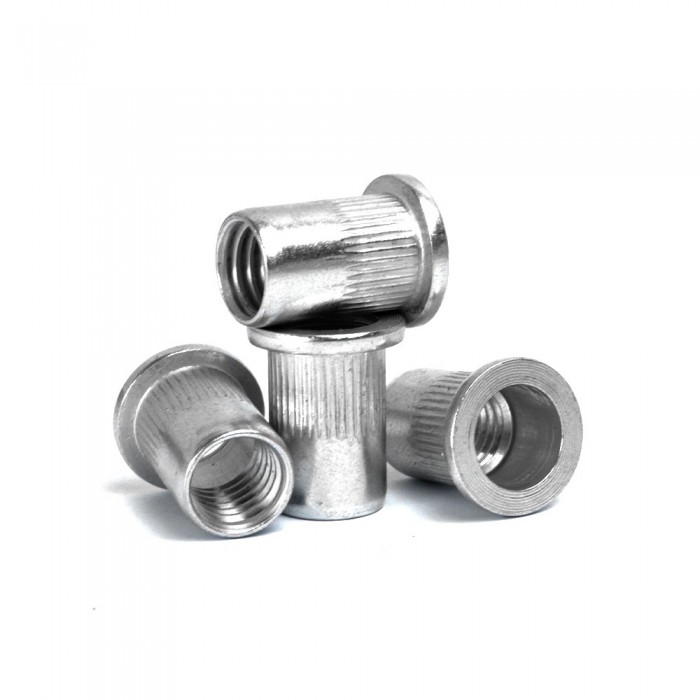

I've used 4mm Rivnuts in this situation on dozens of carb sets over the years.it pulls into the carb body as far as the lip and the knurled portion grips the carb. A stripped 4mm thread is the perfect size to grip the knurl so don't even need to drill the hole bigger.
Can't pull through, can't spin, you end up steel/steel threads not steel/soft cast ally.
simple and effective.
Simple fix.
Picture for illustration
Simple fix.

30 Mar 2023 13:23 - 31 Mar 2023 02:08I've done dozens of them Scirocco. Never had one crack yet. The metal is quite thick there and has the extra thickness of the external rim. The way to do it is to use a bowl screw with a washer on. Put it up through the striped thread from underneath without the bowl in place. Screw the Rivnuts on with the flange uppermost then slowly wind the screw up which pulls the Rivnuts down into the cab body. Once it's seated is not going anywhere and the screw force is spread over the surface diameter of the lip rather than a few alloy threads.I would try to glue a M4 nut on top of the carb body with JB weld first, it´s non inversive and removeable.
Rivets can crack the zinc carb body easy and can cause more damage and trouble you didn´t want.
The trick is knowing what your doing and the skill to do it.
