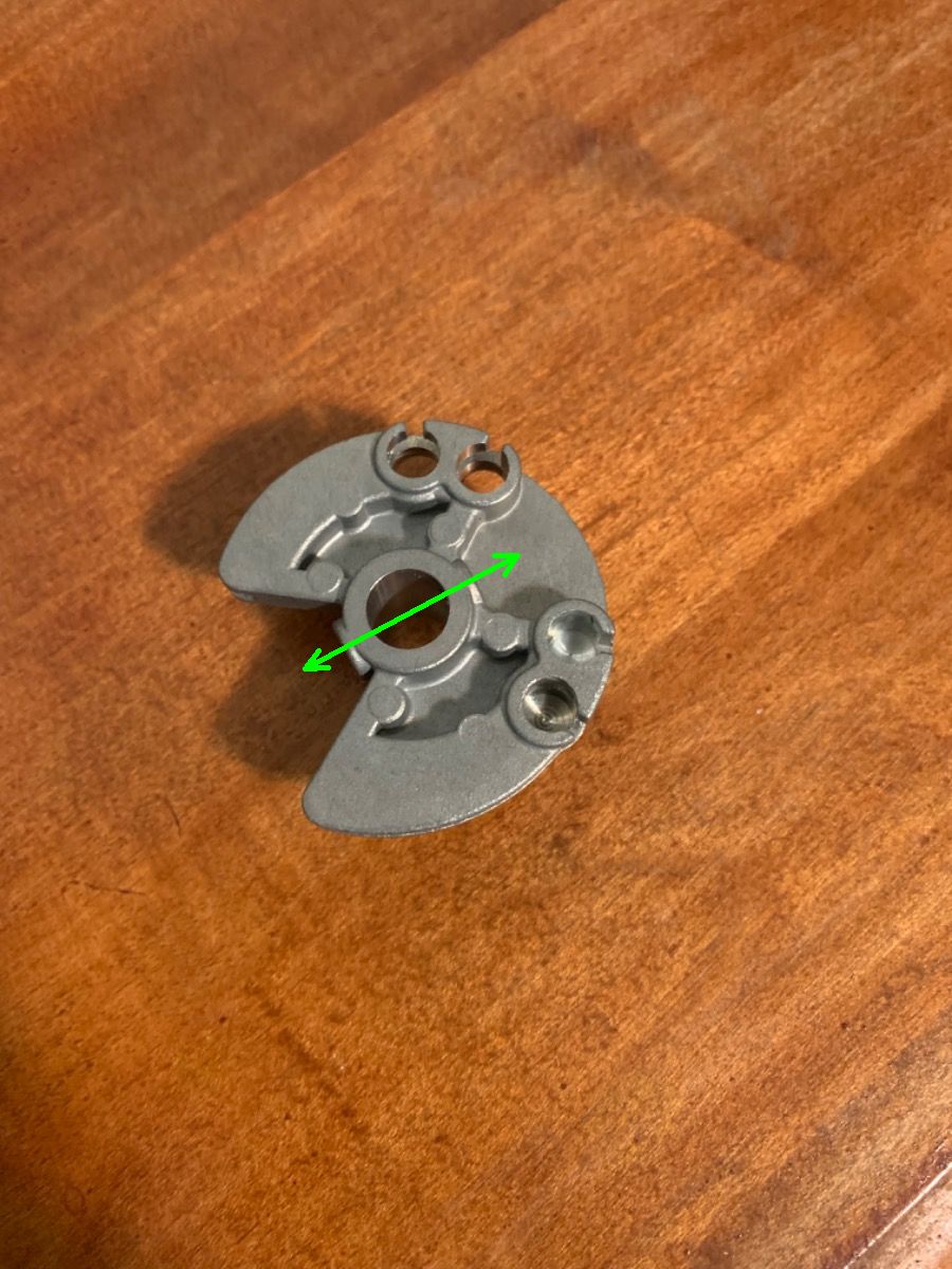

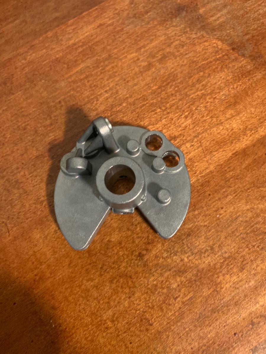

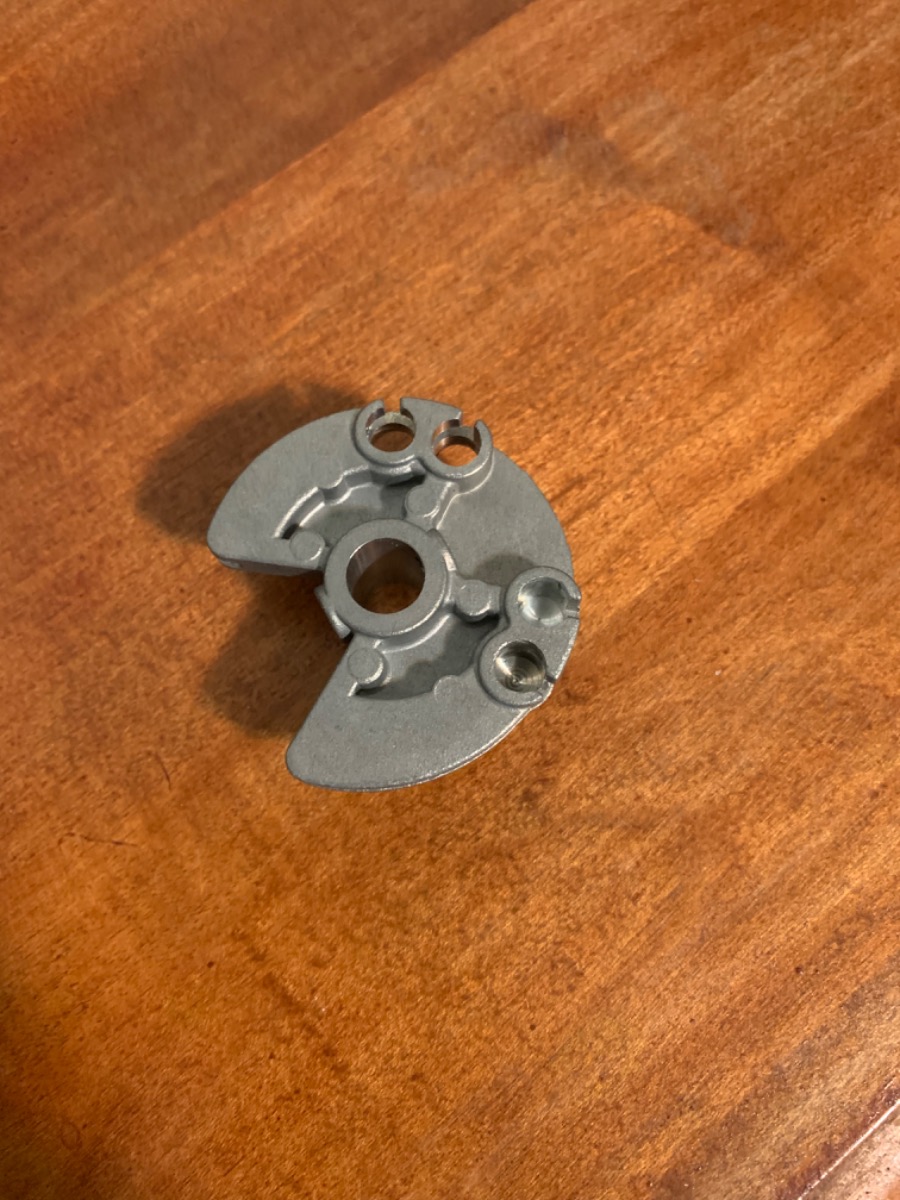

I am looking for recomendations for someone to replace a bell crank wheel on a brand new set of Mikuni 34 Flatslides, Carbs have less than 5 miles on them and I noticed after first ride. I have the brand new part supplied by Mikuni, I suspect a bad cast on the original. Carbs have been drained of fuel. Unfortunately no one local to me can do it. Would prefer your recomendation and someone you have used before. Appreciate the help in advance. Thanks, Joe

Any pics of the bad bell crank wheel would help?

The crack is right where the throttle cable attaches to position two. If I take carbs off bike I will try to get a picture. Thanks.

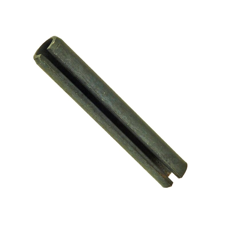

There is also a roll pin on the throttle return spring holder.
I can't give any recommendations on people who could replace that bell crank for you. The only place that comes to mind is W.G. Carbs - Never used them as I do all my own carb work.
Not sure why you could not do it on your own? The throttle shaft once free of all the bolts, and roll pins, just slides out the side of the carb body (rubber cap on the return spring end) you don't have to take the carbs off the mount rails to do it. You don't even need to take the slides out of the bodies.
