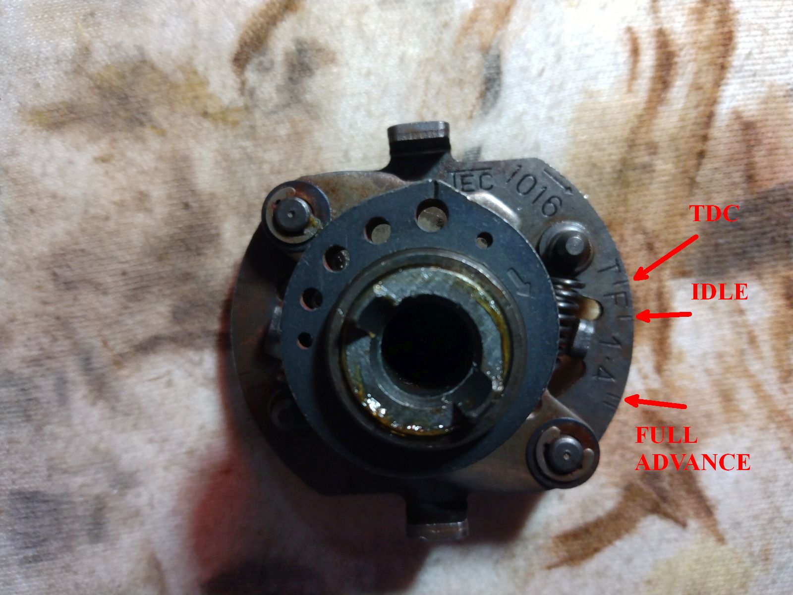

If you have a TDC timing mark. probe #1 spark plug hole and get the piston to TDC. Check if the timing mark is on TDC.
Is there a full advance timing mark? When you checked with a timing light, did it move there when reving?

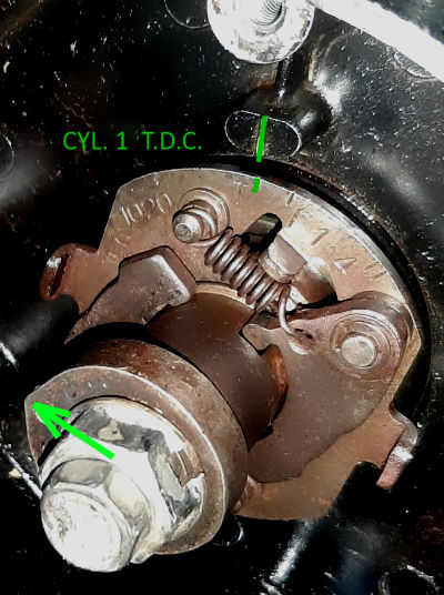

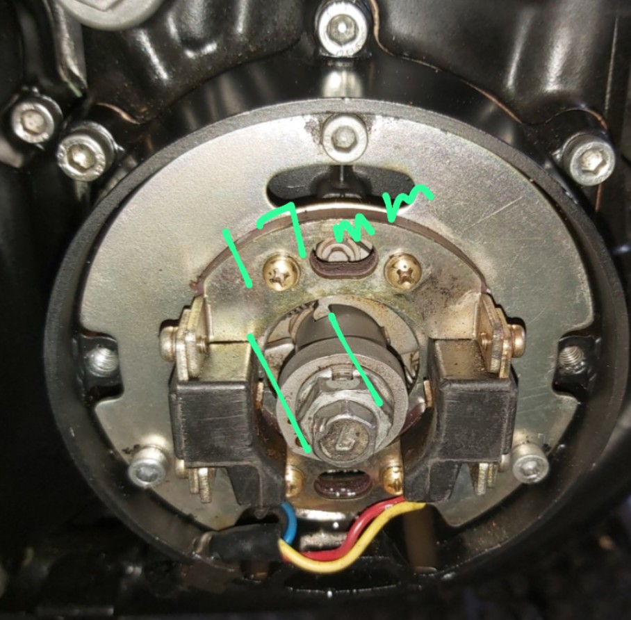

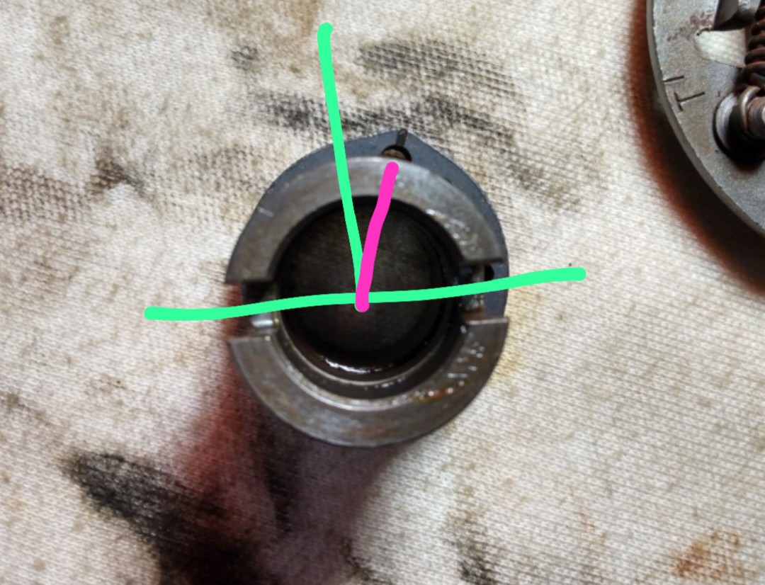

It is possible that the advancer could have been reassembled 180 degrees off... the trigger point is not symmetrical. (the "raised" point on the trigger cam lobe)

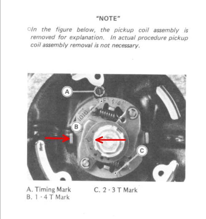

14 Feb 2023 16:09 - 14 Feb 2023 16:12We have not checked the timing yet, may be a few days until we can check it. We will check TDC and go from there. How do we turn the motor by hand? The labeled pictures are great, the manual is a bit unclear on these marks.It is possible that the advancer could have been reassembled 180 degrees off... the trigger point is not symmetrical. (the "raised" point on the trigger cam lobe)
As the Rotor is not truly pointing at the TEC mark, I was not sure if something was installed wrong nor if the raised point was originally pressed on symmetrical as is questioned by edits on the pictures.
Seems if the timing marks line up at the correct rpm, then ignition is not the issue.

To check the correct advancer assembly AND installation...
1. Turn the engine so that the timing mark "T" on the advancer plate lines up with the mark on the engine casing.
(To ensure the advancer is assembled correctly: Make sure that the timing cam lobe is pointing to the rear of the motorcycle, see pic attached)
2.Remove spark plug #1 (left-hand side of the engine) and ensure that the piston is at the top.
H.
H.
