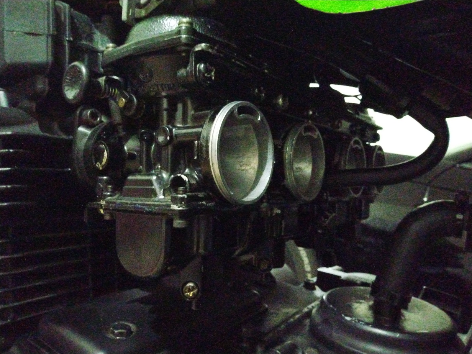

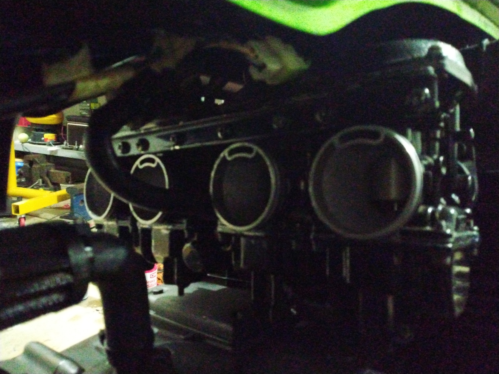

Do you have a photo of the carbs installed?

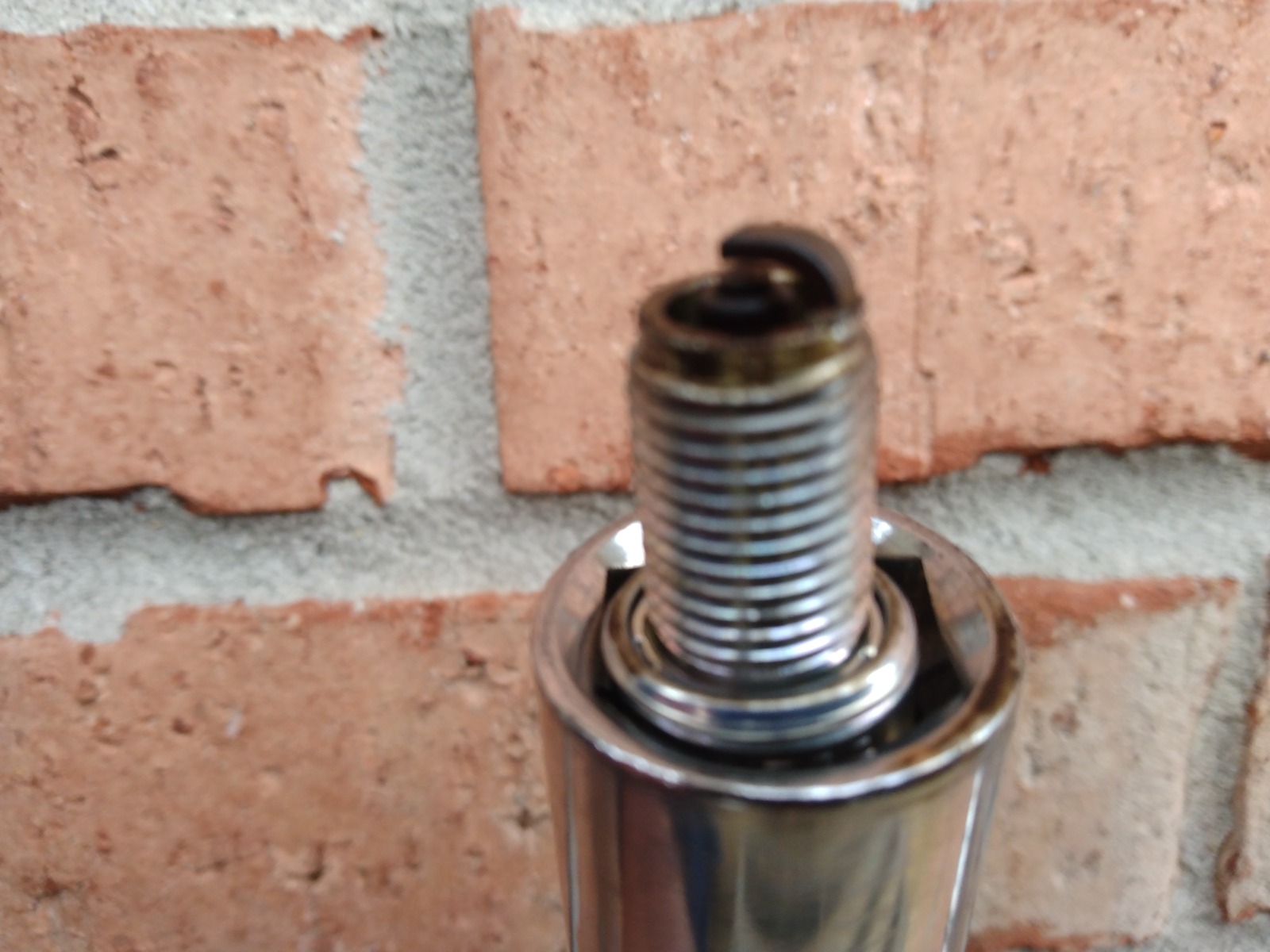

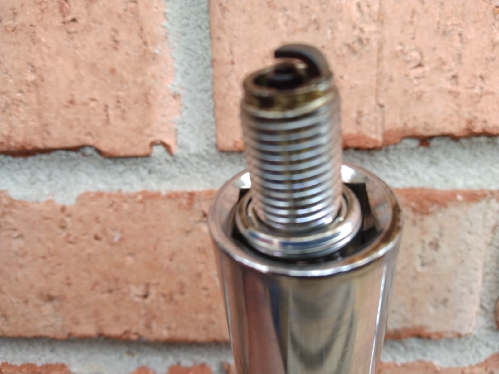

Not great pictures but these spark plugs have 15 minutes on them, bought new today. The old ones smell like gas when pulled out.
