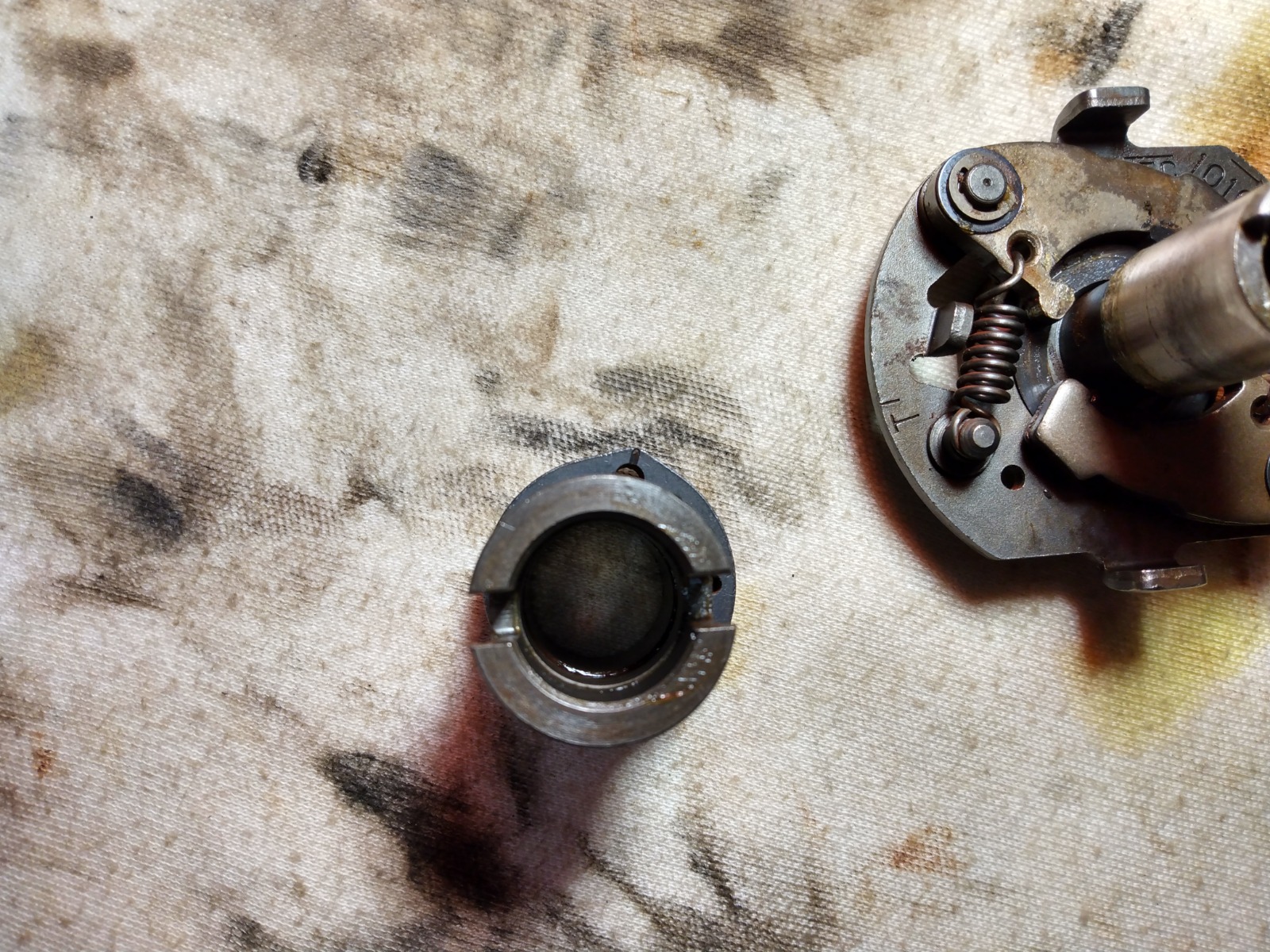

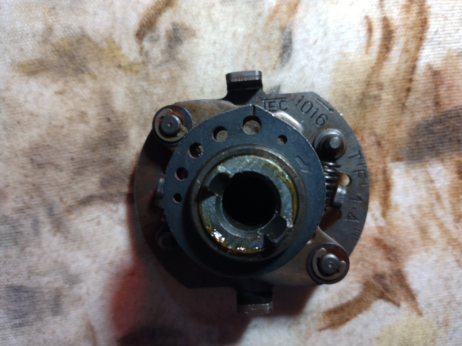

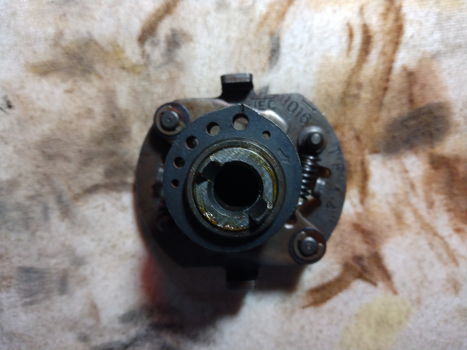

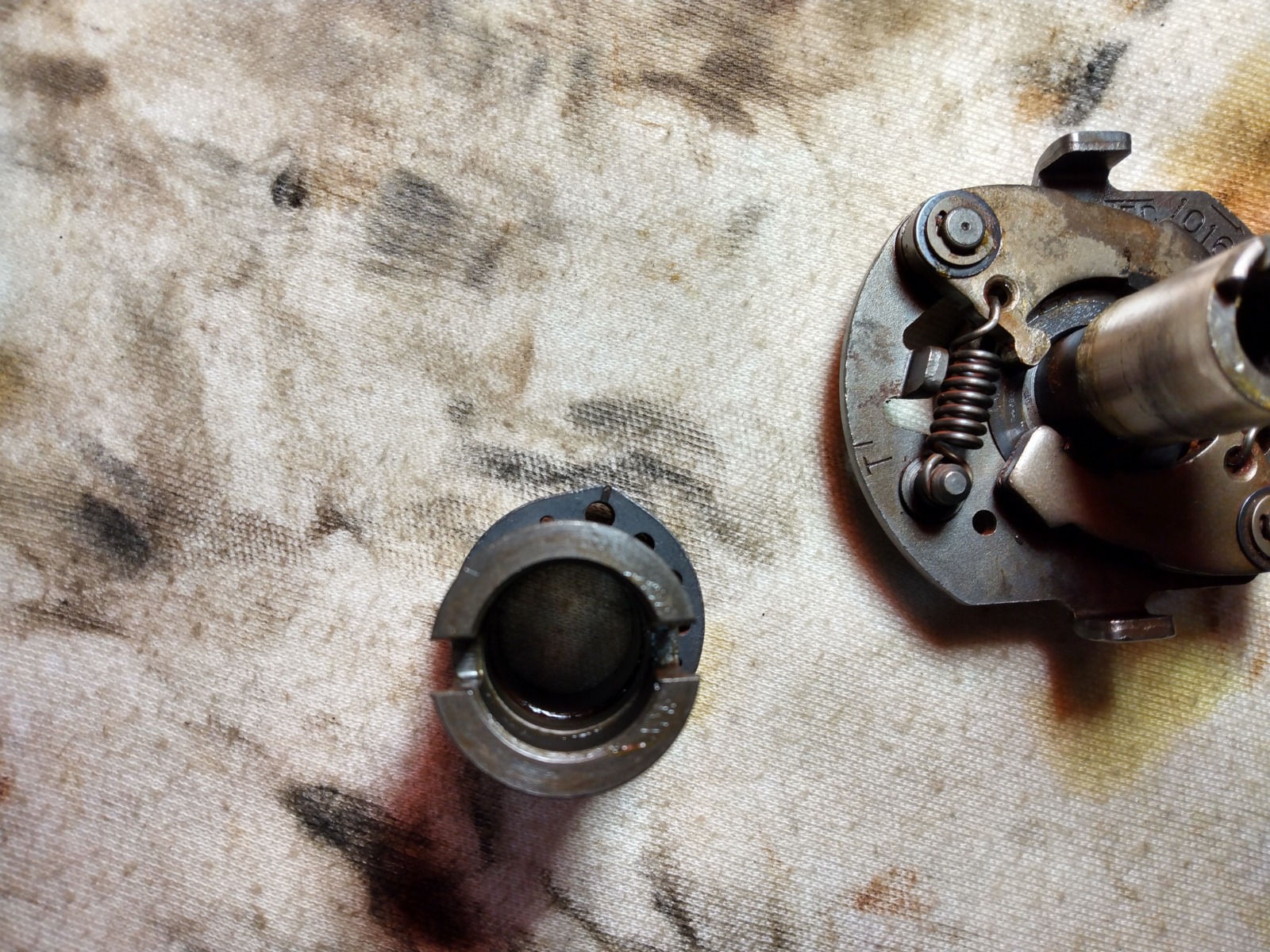

We took apart the timing cover side. Pick-up coils tested good, right in the center of the resistance range.
The Timing Rotor does not really line up with the "TEC" mark. Pictures also of the Rotor seen from the mounting "notches" side.
Thank you for all of the replies!!

Does the Timing Rotor position matter if the timing marks line up when we test with a strobe light?
