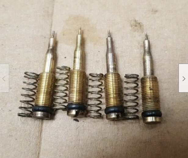

Okay, dang it, now I need help with the pilot screw O-ring size for the Mikuni CV carbs. I'm used to the Suzuki variant, which uses small O-rings on the tip of the screw. But, the KZ variant uses O-rings at the other end.
Edit: looks like 1.5 x 2.5mm Gotta get some of these now...
