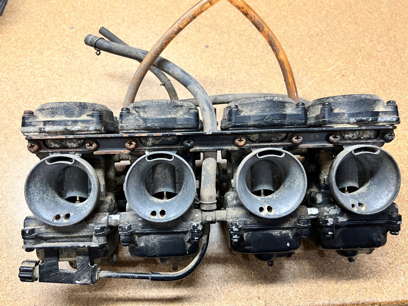

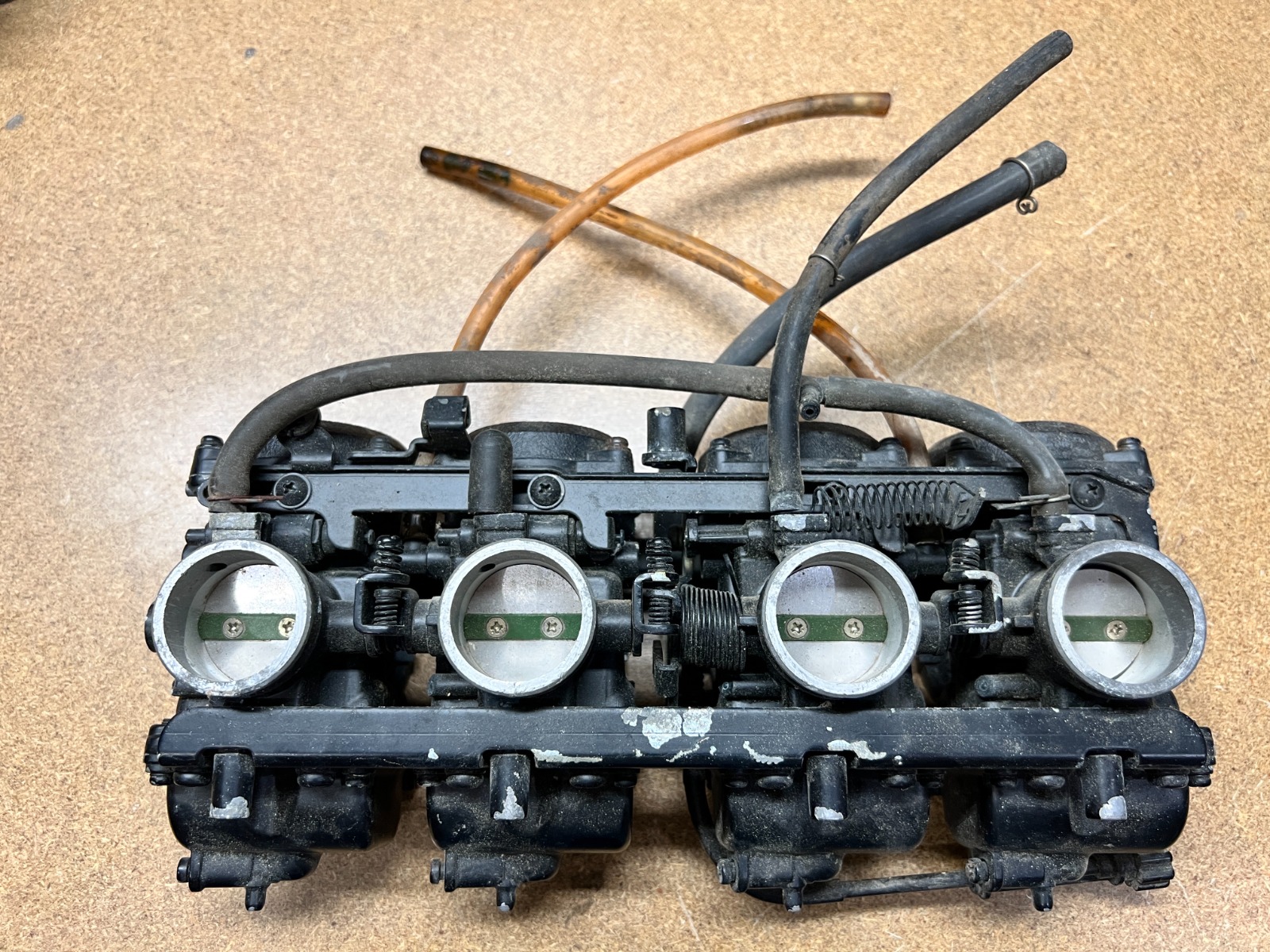

Any clue what the yellow hoses are for?
These are Keihin CVK carbs from 1985 ZL750 Kawasaki Eliminator.

Take this with a grain of salt so to speak. I am not an expert on the CVK carbs at all. But to my way of thinking there are 2 options for the lines in question. They are either vents for the float bowls or overflow hoses, I tend to lean to vents but can not say 100% that is what they are. I am sure others will chime in who do know more.

Vent lines.
