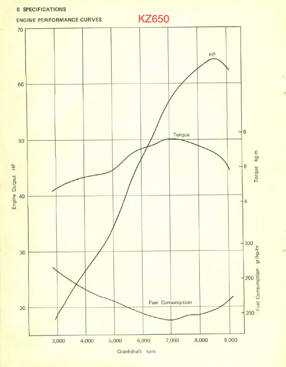

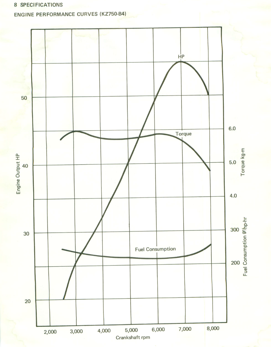

14 Jul 2022 03:04The outright torque number is uninteresting. The interesting point is the torque curve and where in the rev range torque is available. The kz750-4 sure has good torque, but it is way up in the rev range.The KZ750 twin has 55HP,and 44.8 ft-lbs of torque , the KZ 650 has 66HP and almost the same torque, the KZ750 four has 74HP and about the same torque, {2 or 3 ft-lb difference}, you'd be going backwards with the twin...
Unfortunately I haven’t seen many torque graphs for the 750 twin or for that matter the other parallel twins of the era like XS650 and T140.

14 Jul 2022 16:40The outright torque number is uninteresting. The interesting point is the torque curve and where in the rev range torque is available. The kz750-4 sure has good torque, but it is way up in the rev range.The KZ750 twin has 55HP,and 44.8 ft-lbs of torque , the KZ 650 has 66HP and almost the same torque, the KZ750 four has 74HP and about the same torque, {2 or 3 ft-lb difference}, you'd be going backwards with the twin...
If you look at the graphs Doc posted, the KZ650's torque starts just above where the 650's is at, a couple of hundred revs higher, where the twin virtually stays the same, the 650's keeps climbing , I would put my money on the 650 being faster everywhere than the 750 Twin, with 100cc less, the 750/4 is faster again. I'm riding my sons KZ650 every day and it has ample torque, not as much as my old GSXR1100, or any of the other {around 30}, larger bikes I've owned, but plenty for the street , and I don't have to rev the balls out of it to use it either, it would eat those heavy old twins for dinner, the KZ750/4 has more power again. How many of these bikes have you owned or ridden ?
Look at Docs modified figures for the twin below, after all that work, my 1982 GPZ 750 has virtually the same HP stock, with a few tweeks , and a lot less money, i'll be around 100HP..

14 Jul 2022 22:31I am a little surprised it did not show a bigger difference down low, but it is still there.The outright torque number is uninteresting. The interesting point is the torque curve and where in the rev range torque is available. The kz750-4 sure has good torque, but it is way up in the rev range.The KZ750 twin has 55HP,and 44.8 ft-lbs of torque , the KZ 650 has 66HP and almost the same torque, the KZ750 four has 74HP and about the same torque, {2 or 3 ft-lb difference}, you'd be going backwards with the twin...
