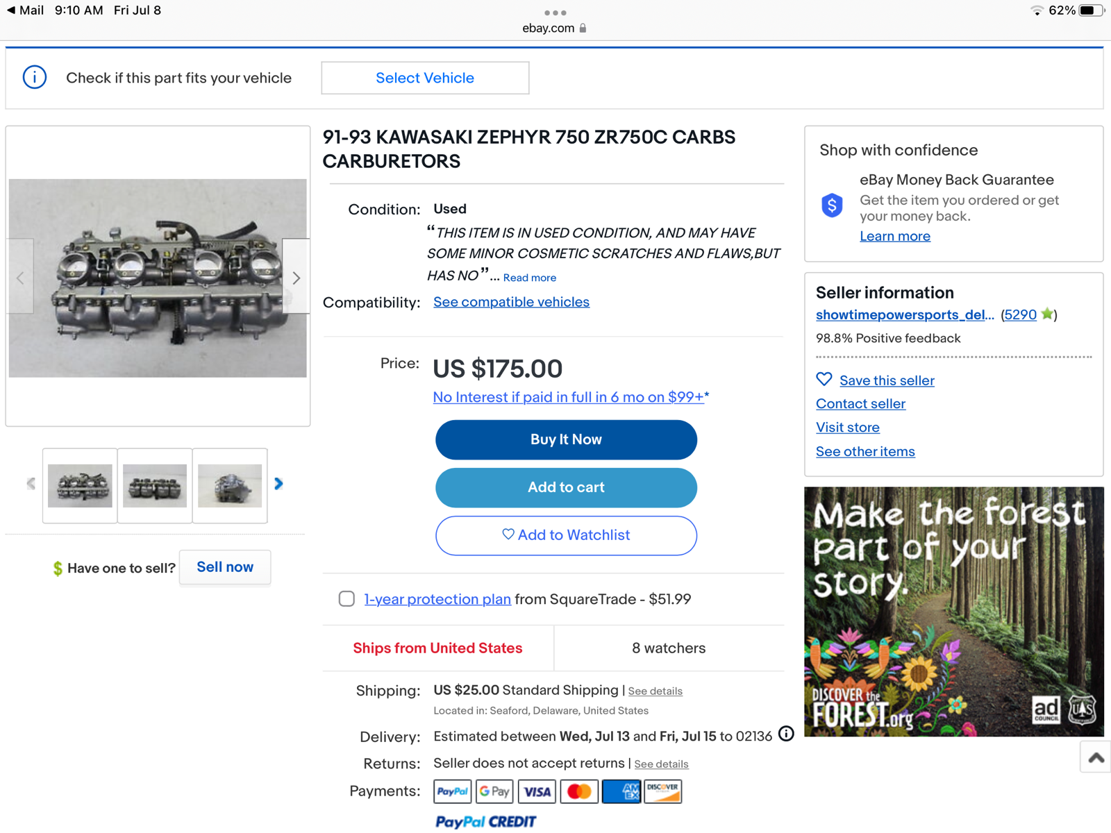

No eBay APP ID and/or Cert ID defined in Kunena configurationThese would probably bolt right on. I believe they are 32mm.

08 Jul 2022 07:20
But thanks a lot for thinking about me and linking. That is really kind of you.
Thanks a lot. I think however I will find some 26-28mm if I decide to go that route. 2mm smaller will probably not be that big of a change.

08 Jul 2022 11:18Do you have the factory pipes and air filter? Those are restrictive but good for low-mid torque.These would probably bolt right on. I believe they are 32mm.

Those Zephyr carbs would likely flow more air than the Keihin's because they don't have choke flaps hanging in the airflow.
