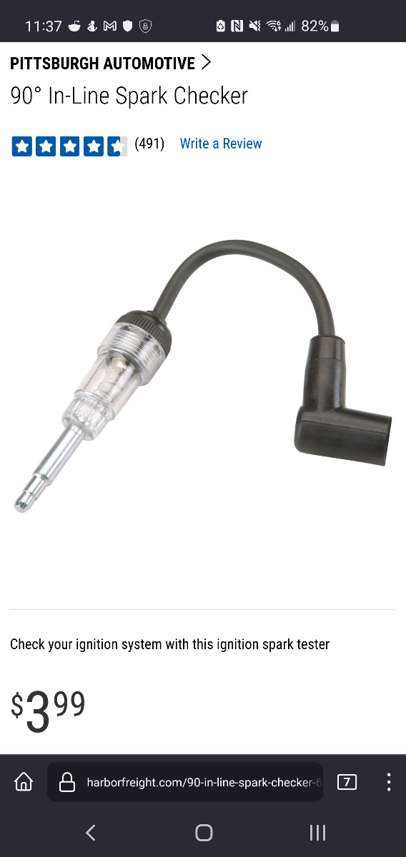

Re: KZ200 - kickstart only - won’t start
17 Apr 2022 08:39

- andrewlafkas
- Posts: 13
17 Apr 2022 08:43
No, just the old fashion way with the plug held against the block. I’m getting multiple sparks that way..
17 Apr 2022 09:41 - 17 Apr 2022 10:12
It harder for a plug to fire under cylinder pressure. The tester will allow you to see if the plug is firing under cylinder pressure.
