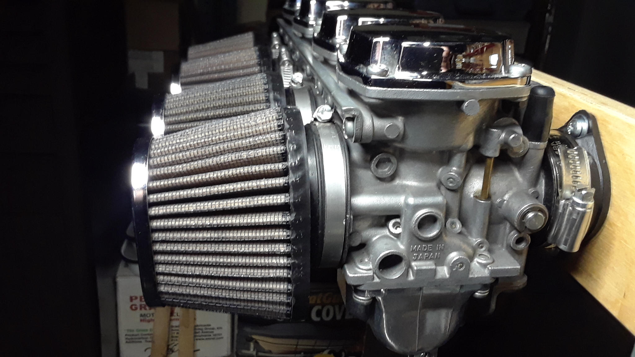

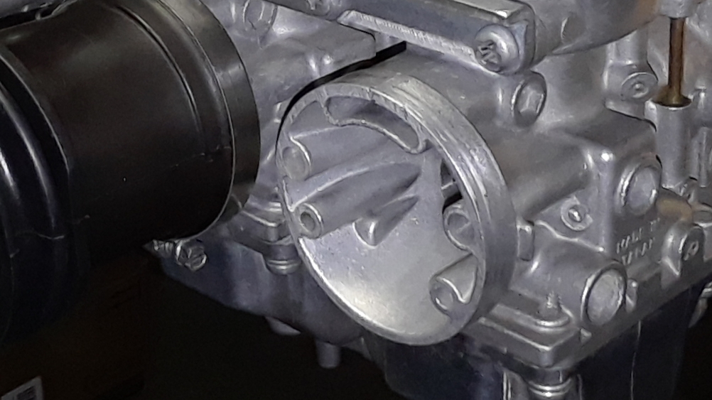

Hoping to be tuning finely later this week!
Not that I would ever-ever consider using them, me pods fit much better without those silly little nibs.
Until that happens the rest of us will do the best we can.

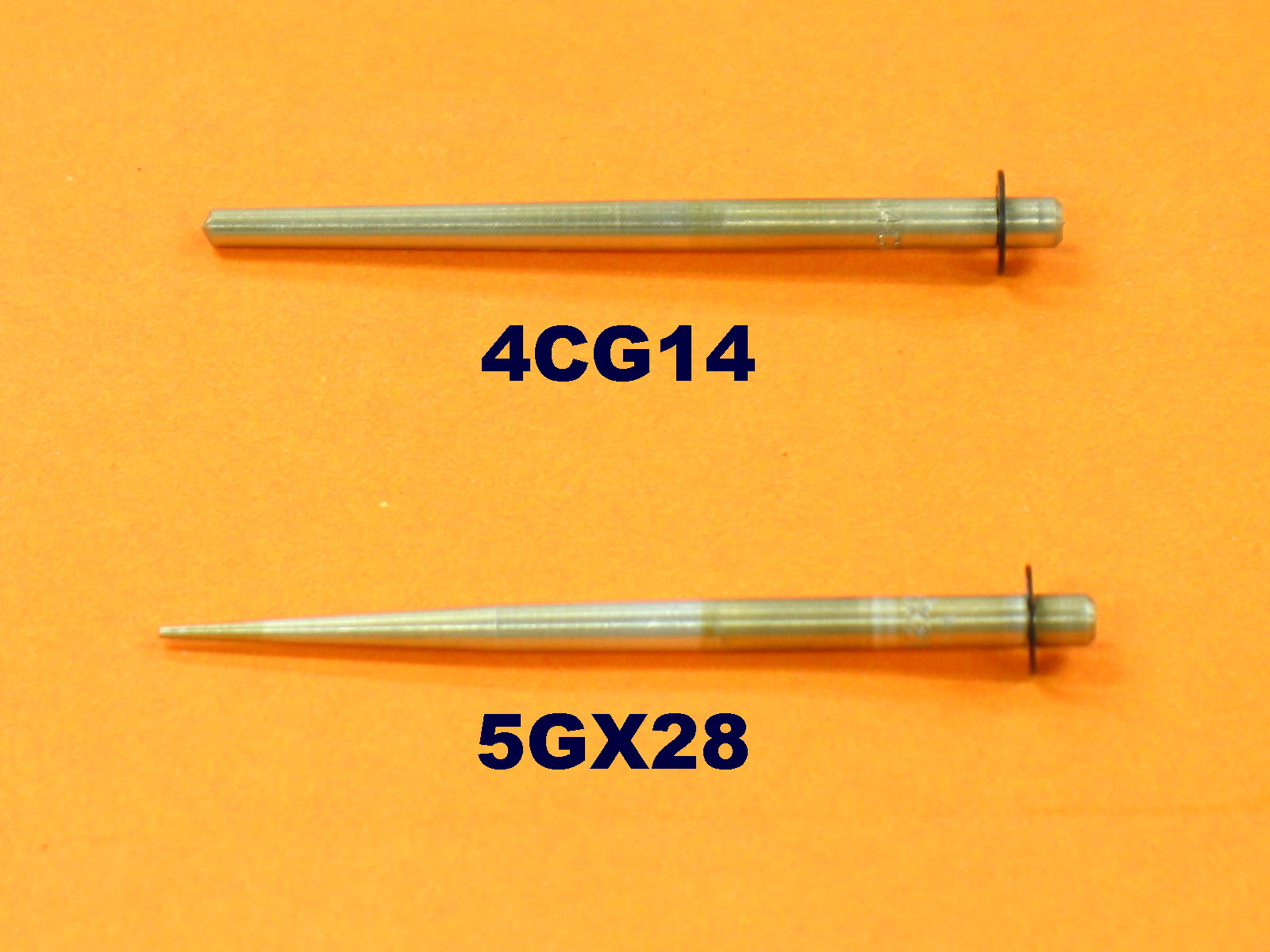

Ok then, back to carb tuning suggestions.
Six years ago the BS34's were stuffed in a box, so I expect some re-jetting will be needed with the recent head work and 1135 engine setup.
I have a set of 5GX28 jet needles that might help some...

13 Mar 2022 10:26Ok then, back to carb tuning suggestions.
That's quite a difference. What did the carbs come off of? CV carbs are self regulating so just a jet change might do it.

18 Mar 2022 10:57 - 18 Mar 2022 10:59The 4CG14 (16009-1107) needles came with the 1982 KZ1100D1 Spectre BS34 carbs, and 5GX28 (16009-1064) came in the 1982 KZ1100-A2 carbs on the bike that I have.Ok then, back to carb tuning suggestions.
Seems the later might be the sportier needle of the two, but it would no-doubt pass more gas.
Regardless of gas cost, I've decided to not swap carbs for now, since the RS34's are way better suited for less conservative riding.
But if that changes I will definitely be following up.

18 Mar 2022 14:24
The 4CG14 needle looks like the one I got with the stage 3 dynojet kit for my BS34's...
