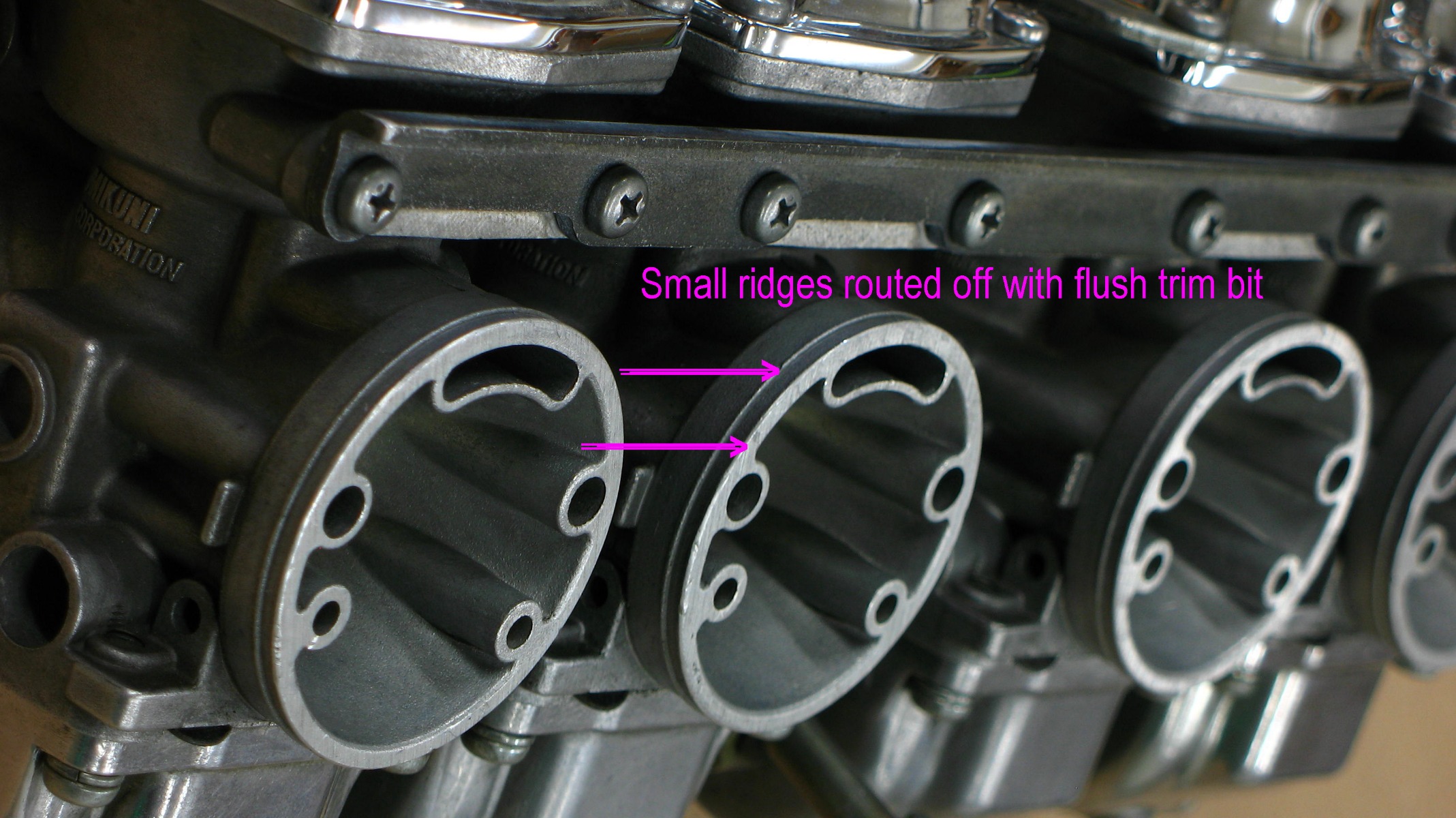

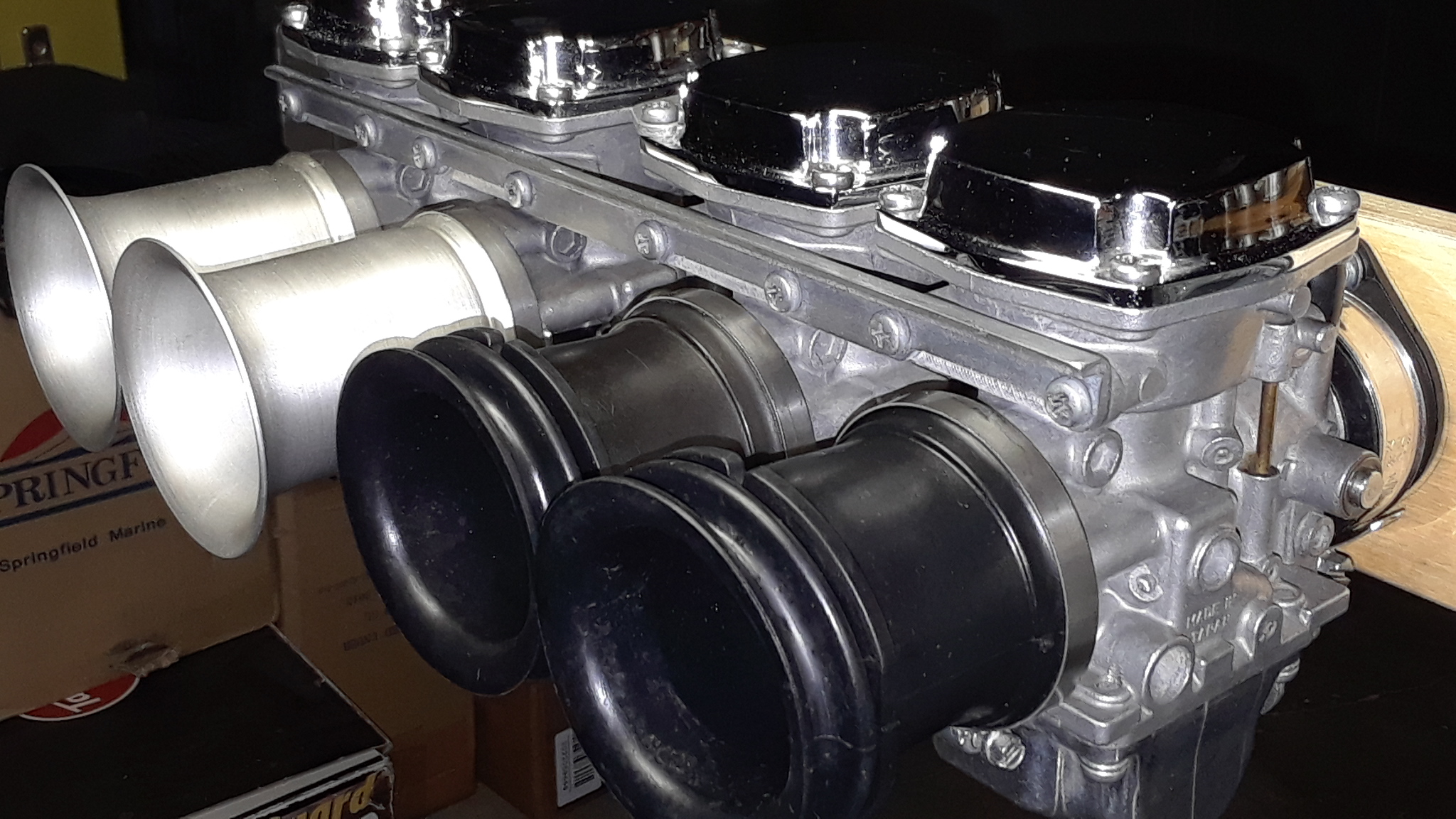

Spent some time fitting my Mikuni velocity stacks to the BS34 CV carbs today, so I can use the widened air box and RamAir filters with these carbs too.
Decided to machine off the two tiny useless ribs from the outside of each bell mouth to make them 55mm like the RS34'S.
The stacks fit nicely, and I can still utilize the original air box with PITA rubber boots another day.
