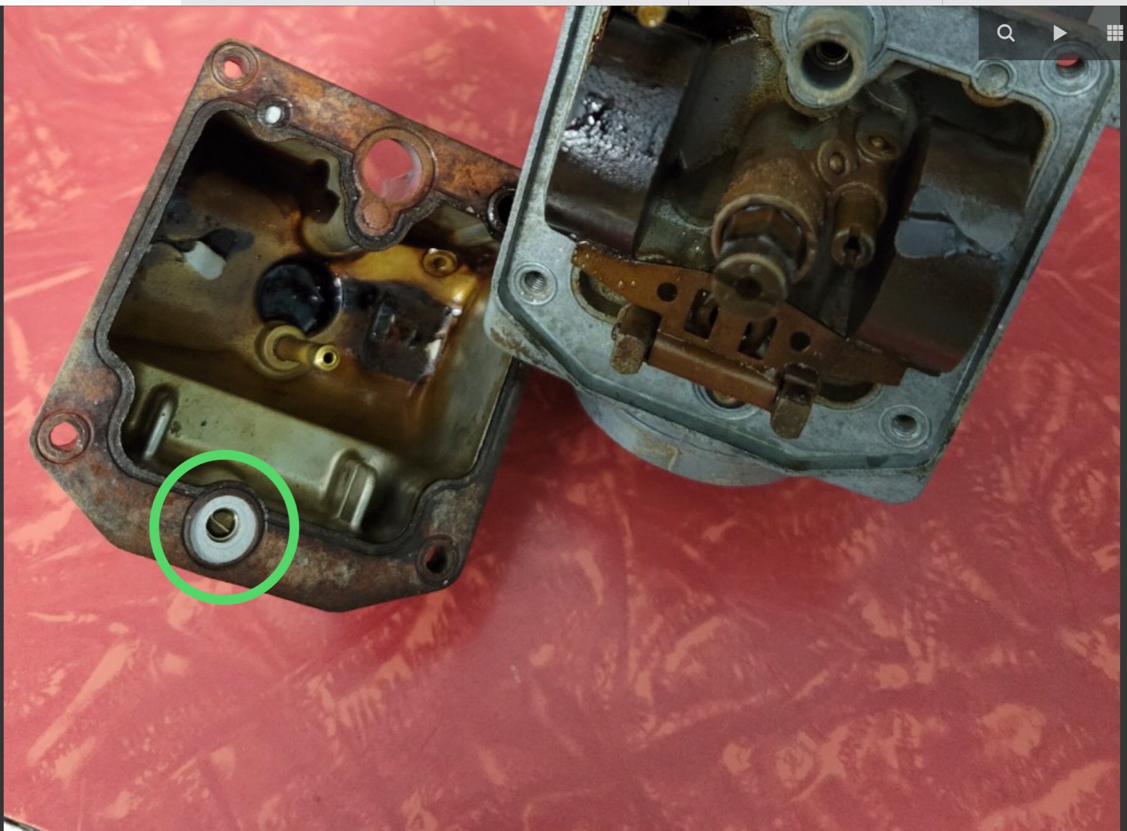

That isn’t that bad. Just gas that’s all varnished up… white corrosion is bad. If the other 3 are similar you’ll be ok.
In this bore is a spring retention clip, a cylinder shaped weight and a ball bearing, remove them carefully and don’t lose them. See green circle

Re: Which carbs are these? 1979 KZ1000 LTD
08 Dec 2021 18:33
Thanks for that! The clip and pin came right out, but had to spray some carb cleaner in there and let it sit for a while to get the ball out. I have also ordered the Berryman Chem dip carb cleaner...thanks.

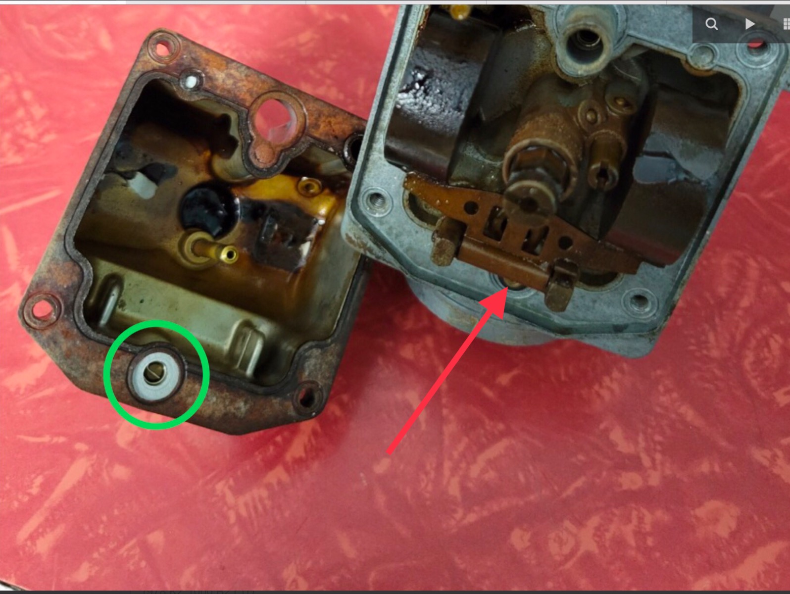

09 Dec 2021 07:26
See red arrow. This is a very critical ORing. The only place I have been able to find the correct replacement is Redline Cycle in Illinois. Jets-r-us might be another source as long as it OEM Mikuni. The ORings in the Keyster kits are correct also but they are about $38 each kit,
Kind of expenses to buy just to get the ORing.
09 Dec 2021 10:51See red arrow. This is a very critical ORing. The only place I have been able to find the correct replacement is Redline Cycle in Illinois. Jets-r-us might be another source as long as it OEM Mikuni. The ORings in the Keyster kits are correct also but they are about $38 each kit,
Well, I live in Illinois so that's a good thing (from the O-ring perspective, anyway! Ha!). Is that something that should be replaced by default?
Thanks for these tips! Super helpful!
09 Dec 2021 11:58
Replacing all ORings and gaskets are default to a proper rebuild.
