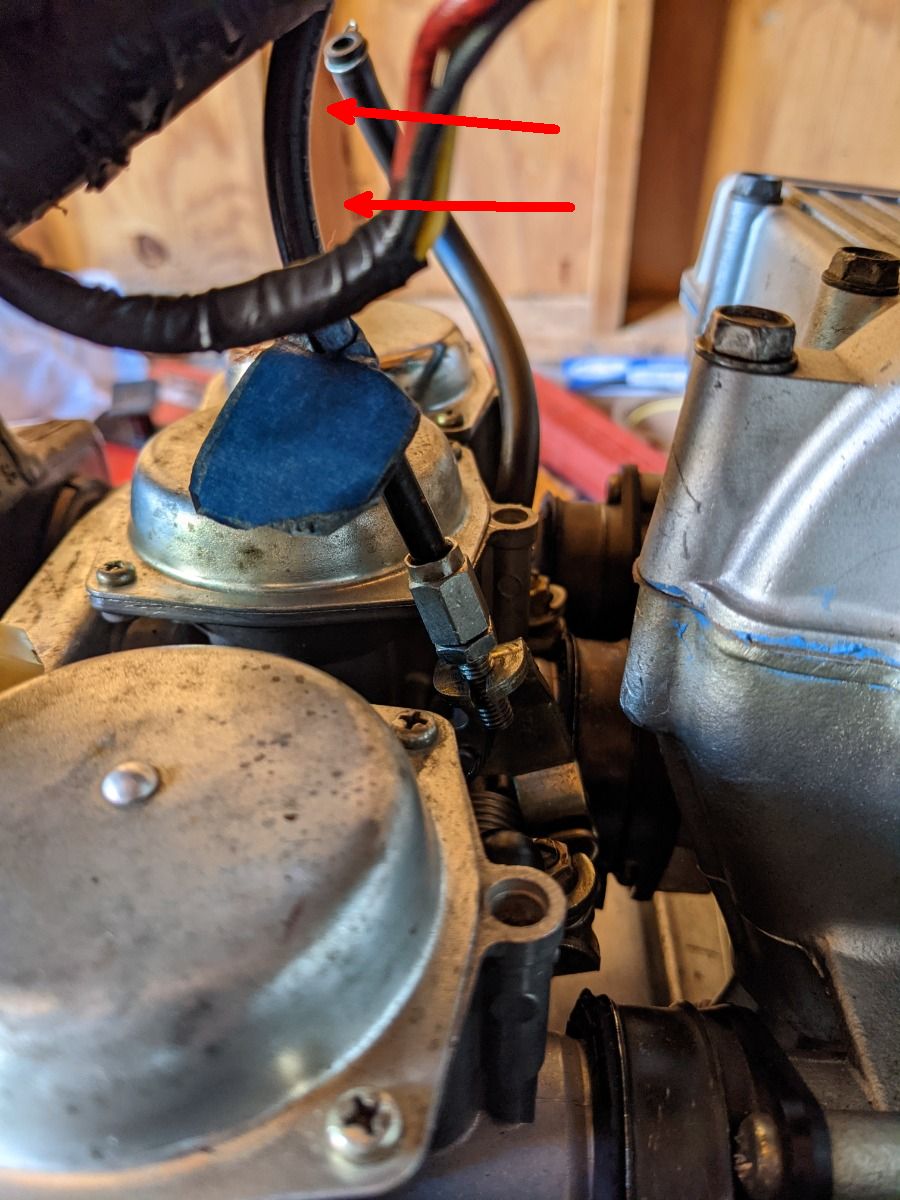

Have you guys seen a throttle cable like this? I'm trying to buy a new one and cannot for the life of me find one with that sort of circular lip that comes out just before the curve.

Looks like Honda
The following user(s) said Thank You: Jakob

All right, sorry for being so needy I'm still a newbie, is that cable the push/pull and mine the opposite?
Trying to find one with threads on the other end.
Here's a pic attached.

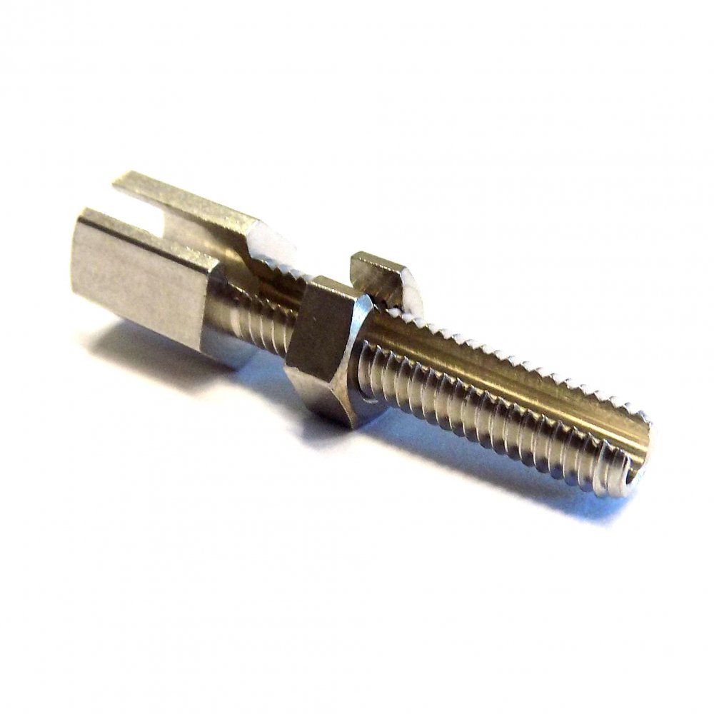

22 Jun 2021 13:26 - 22 Jun 2021 13:27Your bike/carb/RH throttle is a pull only cable driven. Try to read the part# that is print on. It make the search much easier for all of us.All right, sorry for being so needy I'm still a newbie, is that cable the push/pull and mine the opposite?
Alternative you can buy a slotted adjustment screw.
