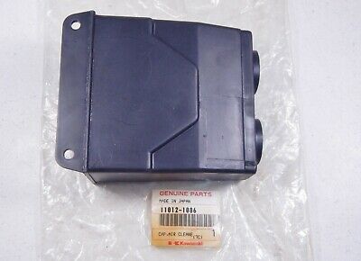

I'm refering to the snorkel that attaches to the air box. I've always referred to it as a snot box for some reason. I have an OE air filter in it now.

Got a little bit of time in the garage this afternoon. I fired up Rusty, let her get all nice and warm, and played with the air box a bit. Resting my hand over the snorkel the idle smoothed out and the RPMs were mostly smooth too. I tried a little bit of foam padding and that seemed to work too. So I decided to take a spin.
With the extra foam, she bogged and stalled out so I tossed them away. Test ride#2 she ran good! Got up to 45 mph and 3rd gear! I'm pretty sure she could go faster but not doing that in my neighborhood. Rode her down to the gas station to reward her with some fresh fuel too. I did realize that the idle is kinda low all I'm gonna fix that later.

Just to be sure, you do have parts 2, 3, and 4 in the diagram? The snorkel fits snugly, does not flop up and down, and seals well against the main assembly? The carbs will be sensitive to anything out of order there.

18 May 2021 07:03 - 18 May 2021 07:04Correct. I do not, however, have a factory seal on the filter case OR the tube on the bottom of the air box (#14). I used some 1/4" sticky foam I had laying around on the air box. I might remove that and try putting it on the filter case.Just to be sure, you do have parts 2, 3, and 4 in the diagram? The snorkel fits snugly, does not flop up and down, and seals well against the main assembly? The carbs will be sensitive to anything out of order there.
