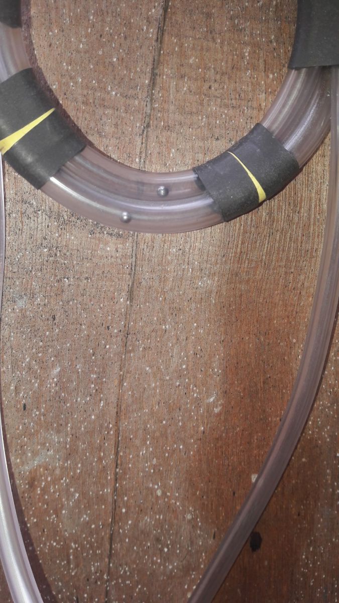

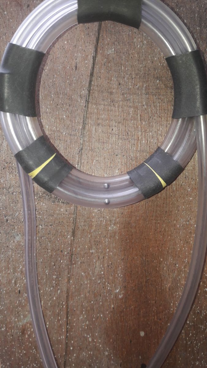

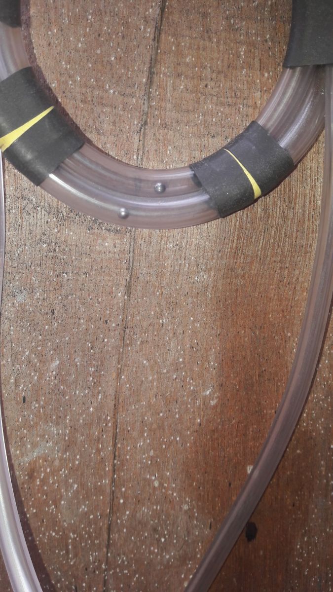

Below is a post I made in that thread. Cheap as chips and 100% accurate.
"Guys, as I said I only borrowed the carb tune pro out of curiosity to see if they were as accurate as I remember the mercury ones being. They dont appear to be so without some trial and error set up. I moved onto the ball bearing hoop method after my original set died.
If anyone is unaware of this method I will explain with the aid of some pics.
The inner ring is sealed and the ball bearing hangs centrally under gravity and is your datum point. Pic 1
The outer ring is open at both ends. Attach one end to the base setting carb, normally number three. Attach the other end to carb one. Start the engine and adjust the idle to about 1500 /2000 rpm. If carb one is out of balance to carb 3 the outer ring ball bearing will swing to one side or the other depending on wether there is more or less vacuum. Pic 2.
Adjust your slide so that the outer ring ball bearing is back centrally directly under the ball bearing in the inner ring. As in Pic 1.
Do the same for carb 2 & 3 and 4 & 3. Your carbs are now perfectly in sync. Beautifully simple and 100%
Accurate."

Interesting. Need to make sure the ball bearing is big enough that it won't go through the vacuum port (sucking a ball bearing into the cylinder wouldn't be fun).
- Warren3200gt
- Posts: 1775
- Thanks: 957
Re: Best carb synch tool on a budget please?
10 Sep 2020 01:03
There is a piece of tube inside either side of the indicator ball bearing tube which has a smaller internal dimension than the ball bearing so the indicator ball bearing can not come out of the central portion of the outer indicator tube.
The inner tube is sealed and the ball bearing in the inner tube is just the datum indicator.
