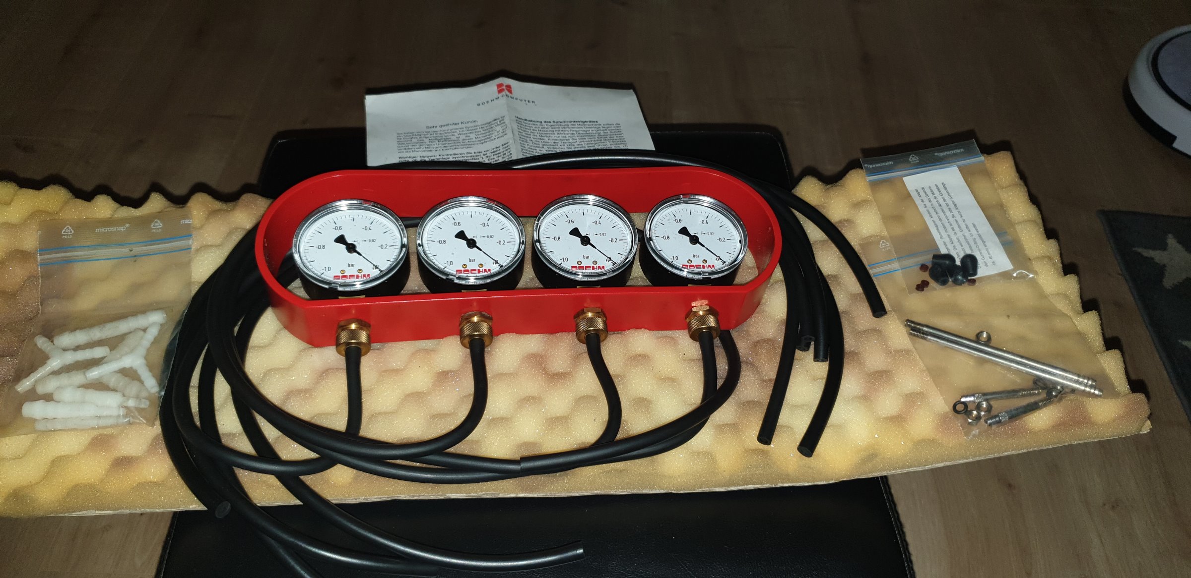

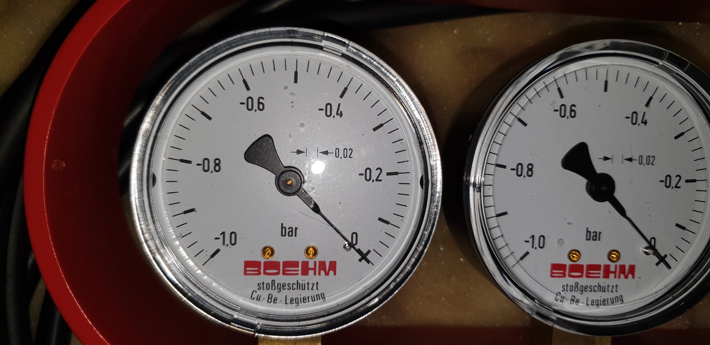

These are the gauges I use. They seem to be quite accurate (at least, they are very accurate for comparing the values, I have no idea how accurate the actual values are). I didn't even manage to mess up the calibration by dropping them about 15-20cm onto a wooden floor :ohmy: The outer casing is pretty flexible though and as Rick said, even if I had messed them up they can be calibrated individually with a small flat head screwdriver.

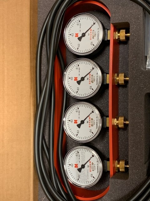

I am working with my Boehm gauges for over twenty five years and it´s worth the money i paid for it. It´s a precision measuring tool made in Germany that last for ever over your life span. Did over 200´s of carb syncs and engine diagnostics (compression loss/vaccum leaks), buy cheap buy twice, your choice.
