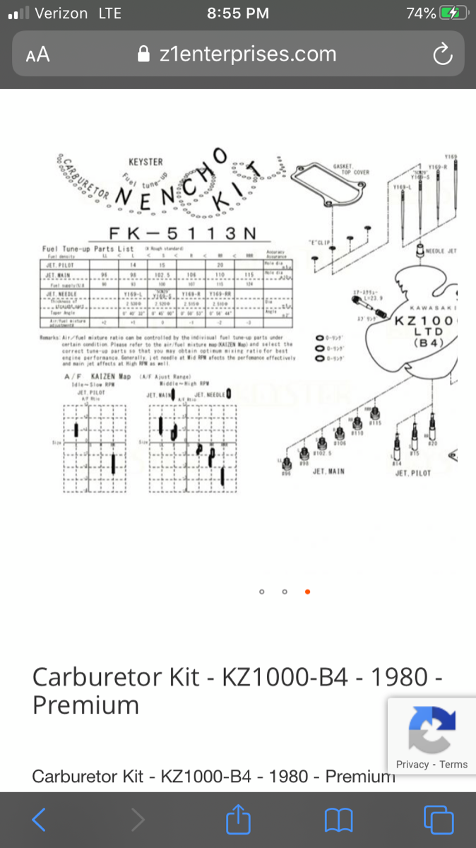

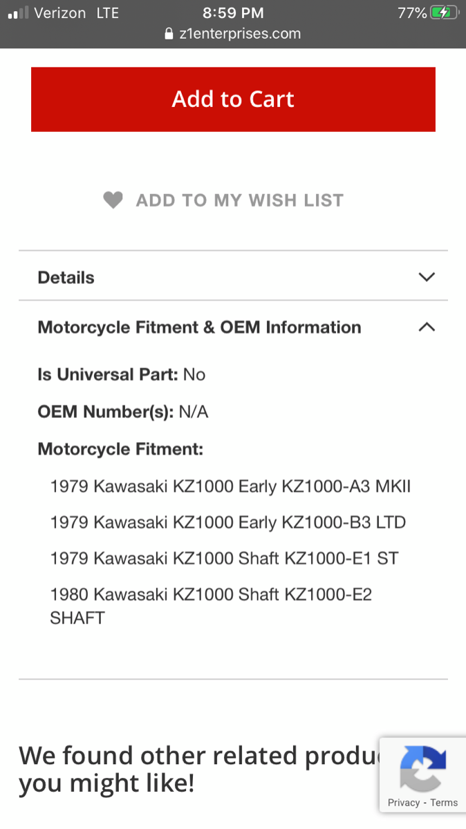

Hello everybody. I have a set of VM 28mm carbs not sure what year or off what bike. I looked on partzilla and used what I thought was the carb diagram for those carbs to order a Keyster kit form Z1 Enterprises mainly for the gaskets and the needle jets. So they came and the needle jets won’t fit my carbs and I believe the ones in my carb said P-4. I was wanting to change them cause there egg shaped. Is there a place I can just get those. Thanks for reading.

did you order the FK 5394N kits.
this should be the breakdown you need.
www.partzilla.com/catalog/kawasaki/motor...etor-parts-kz1000-b4

The 5437n is listed for the Kz1000 A1 which is the 1977, they came with VM26mm carbs with the fuel pilot screws. not sure that's the right kit. You rebuild a set of VM28mm with the accelerator pumps. You need to get kits for the 1980 Kz1000 B4 or the Z1R D3 5202 I think will work also. Listed as KK that's not a Kester number where did you buy them.
EDIT, Your jet should be stamped with 0-4
Z1, short term memory sorry. did the rest of the parts fit.

Well now I cant find where I found the 5437N kit listed not sure I'm correct.

I got the kits from z1 enterprises and they say Keyster on the box it’s a red and blue box made in Japan. I’m trying to get the number off one but it’s hard even with a magnifying glass. Lol

It is stamped 0-4. The gaskets fit and the air/fuel mixture screw was the right fit . I didn’t use the jets or the needles .

What is the Z1 stock number. I couldn't find the 5437N listed at Z1. Did the bowl gasket have the hole in it for the pumper check valve?

Part number is 200-1161. Yea the gasket was correct, everything lined up.

Is the needle jet the wrong OD to fit in the carb body?
