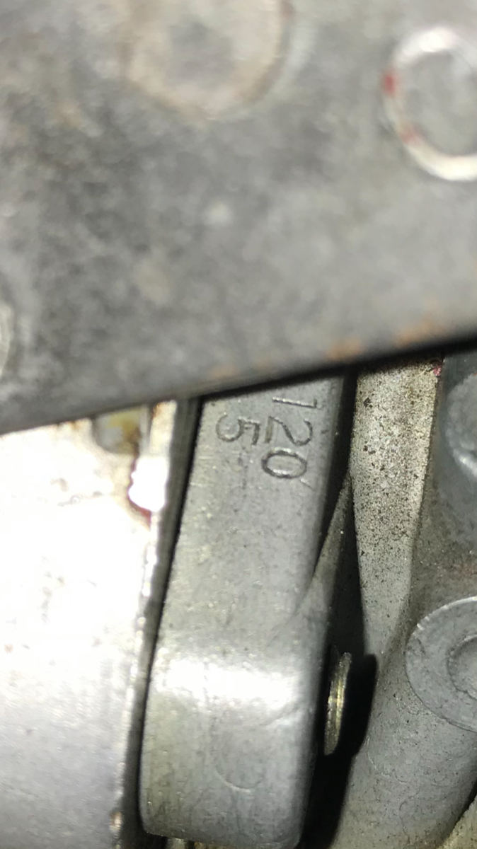

In one of the pics you posted earlier you show the flange with the ID stamp. But I can not see what it is. If you post what the ID is I may be able to provide more info on what the set of carbs are and model year they may of come from. Making no promises.

  • Zilla
  • Zilla's Avatar Topic Author
  • Posts: 171
  • Thanks: 11
Re: VM 28mm
25 Sep 2020 18:57
#835663
Ok, I’m at work now but I’ll get some better pics posted in the morning.

  • Zilla
  • Posts: 171
  • Thanks: 11
Re: VM 28mm
27 Sep 2020 12:17
#835730
Under the choke. There’s something on the opposite side same place can’t get a good pic that makes it out.

Re: VM 28mm
27 Sep 2020 13:41 - 27 Sep 2020 15:03
#835738
First I must apologize as you had posted the ID number early in this post. Did not see that until I re read the post, 120/5. I have some info that indicates a 120/1 were stock on1979 or 1980 KZ1000 A. I can not say if the 120/5 came on the same year or not. Of the ID marks I have gathered I do not have the 120/5. But will add that from the info on IDs I have found all of the 12x/x other than 120/2 are vm28ss carbs. The 120/2 is a vm26ss carb

Re: VM 28mm
27 Sep 2020 15:09
#835743
Dumb me, I mixed up 102 and 120. I edited my last post to fix this, but still not sure which model or year the 120/5 came on. I do have info of 1201 on a 79 or 80 KZ1000A

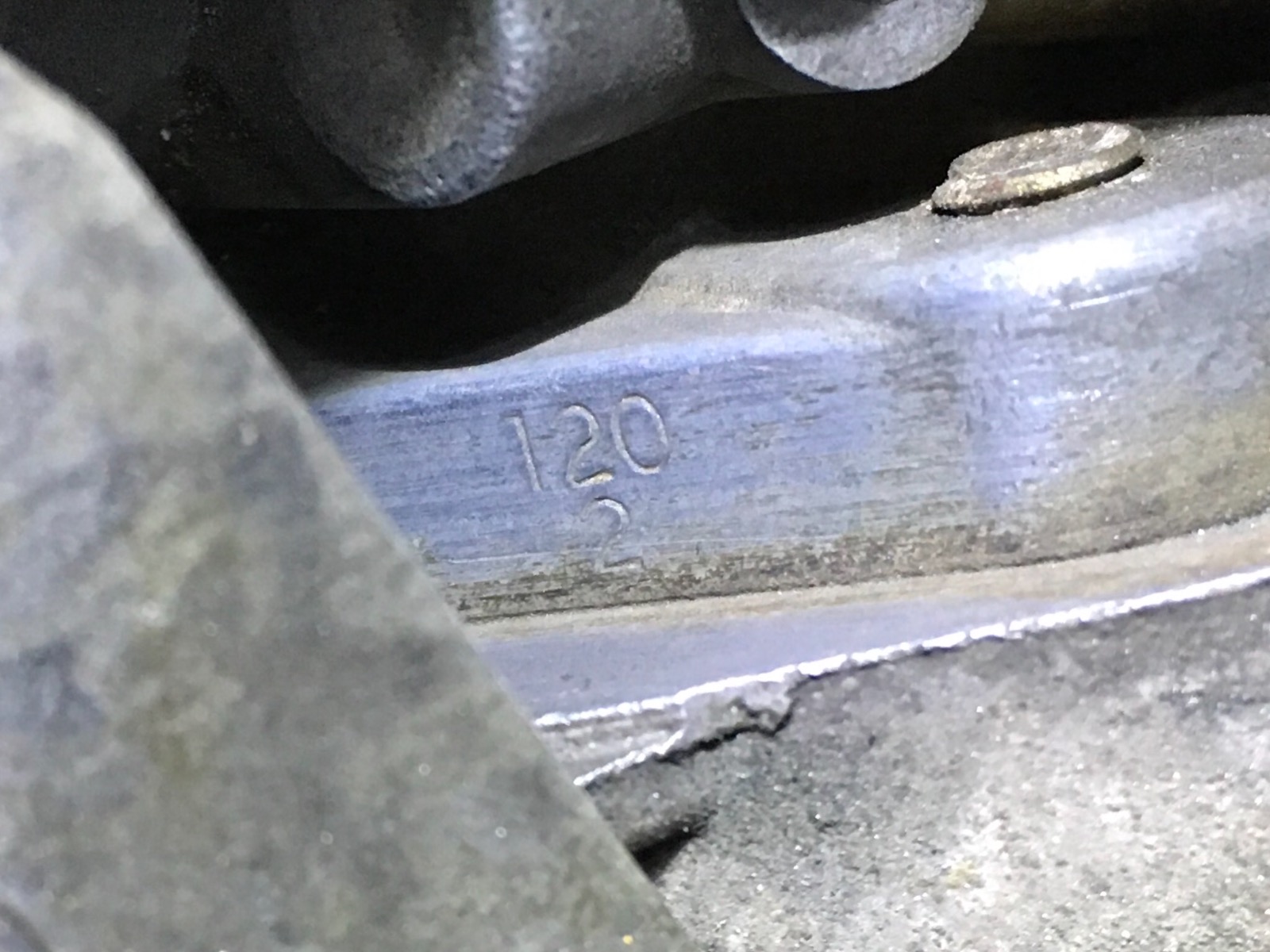

  • Mikaw
  • Mikaw's Avatar
  • Posts: 4836
  • Thanks: 1851
Re: VM 28mm
28 Sep 2020 10:21
#835780
gd4now wrote: Dumb me, I mixed up 102 and 120. I edited my last post to fix this, but still not sure which model or year the 120/5 came on. I do have info of 1201 on a 79 or 80 KZ1000A
Just FYI
To the best I figure based on Partzilla and internal parts my set is from a 1980 Kz1000 LTD. see photo of stamped number on the flange

Re: VM 28mm
29 Sep 2020 14:17
#835882
I do not claim this to be correct but info I have would indicate that 1202 is a vm26 carb that came stock on the LTD models.
Again not claiming any accurate info on this, just some of the data I have collected.
It is rather confusing as some carb assemblies have been superseded by other part numbers. I do not have access to early part lists, only later ones which leave much to be disrered.
