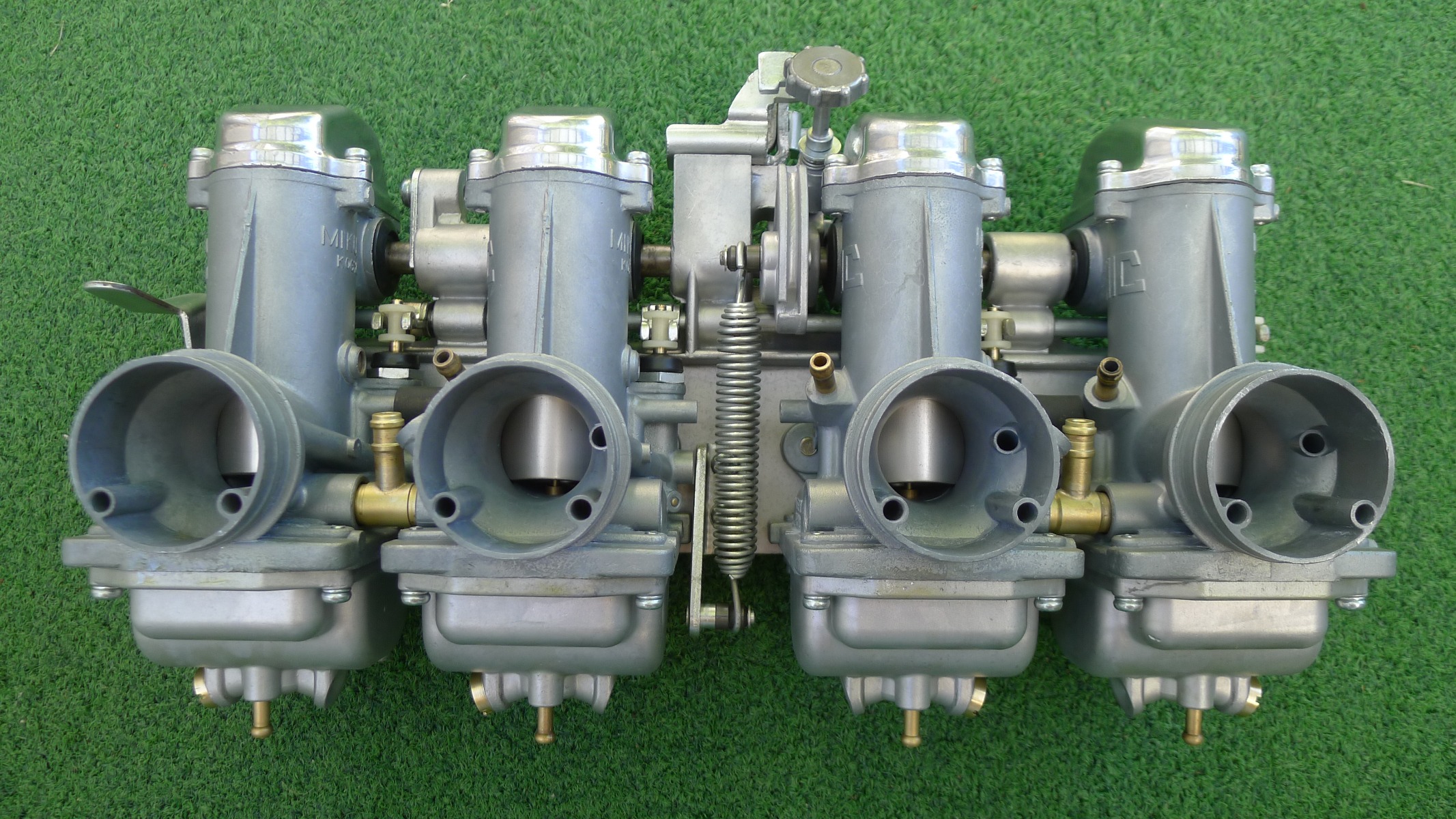

06 Jul 2020 08:39I have a '79 KZ1000 LTD that I recently purchased. The bike ran good, but would not idle when cold without having to give it gas with the throttle. I took the carbs apart and cleaned them in a heated ultrasonic cleaner with simple green cleaner. They were very dirty and came out spotless inside and out after cleaning. I blew all the holes out with compressed air. I replaced the float valves and seats, but kept all of the original jets, which were removed for cleaning and reinstalled. I also replaced the fuel petcock on the tank at the same time. I did not mess with the choke assemblies, but now it seems like the choke lever will only go about half way and then jams. The bike does not even try to start now. I also set all fuel screws to 1 1/2 turns off fully seated. These are the 28mm carbs with the accelerator pump. I took one of the spark plugs out after trying to start it and they seem dry, so I think I am not getting fuel to the cylinders, but not sure why. I put in about a gallon of new gas and put the petcock on reserve so it should be getting gas. I loosened the bowl drain screws and fuel started to drip out of each one so there is fuel in the bowls. Any ideas on what to check next?

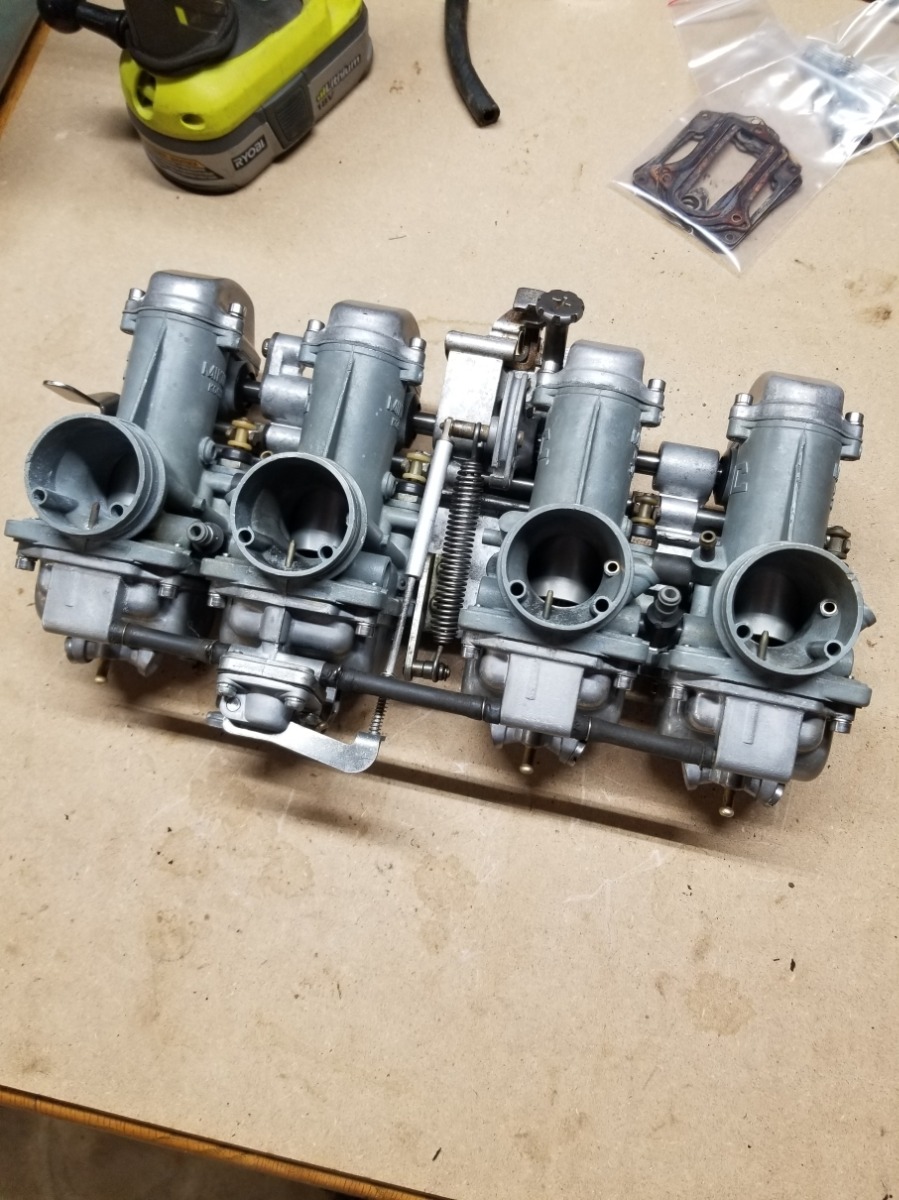

Something looks unusual with the throttle return spring. Appears really steched out yet slides appear closed. Did you ungang the carbs for cleaning

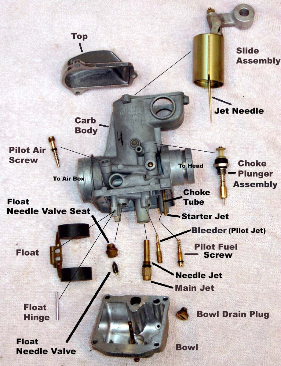

All internal carb parts has to be cleaned seperatly. not as an single carb unit.
enricher circuit fuel ports
Last edit: 06 Jul 2020 11:10 by Scirocco.
Re: KZ1000 won't start after carb cleaning
06 Jul 2020 11:14
Scirocco, great exploded photo.

One other question, there are two brass nipples on carbs number 1 and 4. You can see the one on number 4 in the photo in post 1 between carbs 3 and 4. Is this a vacuum line? What should it hook up to?

Re: the vents...these are normally connected to the smog ports along with a hose from your airbox to the exhaust side of the valve cover. A lot of people have taken all of the hoses off and blocked off the ports.
These are vent ports to the atmosphere and should not attached to the airbox or any vaccum.
The only tubes attached to the airbox are the tube from the engine case vent and the secondary air vent tube to the smog valve cover reed valve unit.
06 Jul 2020 16:39 - 06 Jul 2020 16:44
hardrockminer has you started in the correct direction. The brass nipples should be on 2&4. Not 1&4 as you noted... as Scirocco says they are vented to atmosphere, really don’t need anything on then. Sounds like the best route would be to pull them follow hardrocks advice. Also do a bench sync before your install them. Carbs rarely work correct when a partial rebuild is done.
Edit: I’m still wondering why the throttle return spring is so stretched out. Investigate the area also

Yes, the spring looks like more stretched but it is dependent to the length of the lower monting point on later carbs!!!
