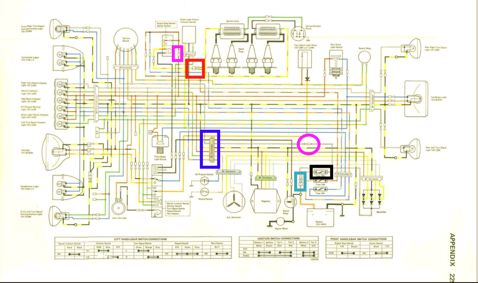

Retest the connector in the teal box.
Do not disconnect the connector.(you will have to back probe the connector)
All of the fuses in.
ignition on/engine off
meter DC V
Red meter probe- positive battery post
Black meter probe-both sides of connector( there will be 3 readings as the connector has 2 connectors out,1 connector in)
meter DC V

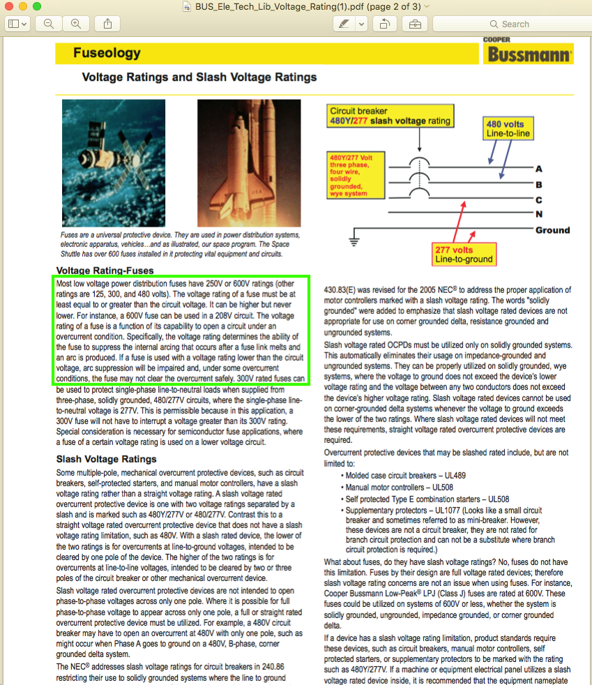

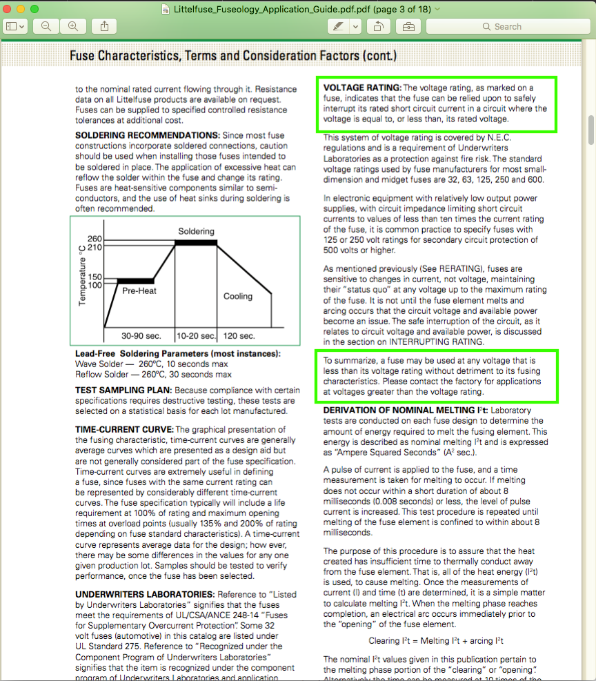

10 Jul 2020 11:59 - 10 Jul 2020 12:09magilla wrote: Yes, I mean the fuses do not have any amp ratings on them.
I don't know where your fuses came from, but I just looked thru a bunch of NOS automotive fuses that I have and they all have amp ratings on them, not one has voltage rating. I suppose installing a 32 volt fuse is okay if the amperage is the same or slightly above, but to my way of thinking that's playing with fire. If a fuse says 32V on it I still don't have any idea what the amps are. What if the amperage on that 32V fuse is two or three times greater than the circuit should carry?

10 Jul 2020 12:58 - 10 Jul 2020 13:04F64 wrote: Getting a 32 volt fuse is fine. You either want a higher voltage or equal voltage never a lower voltage.
I must say I totally disagree.
Regardless of the electrical theory, would it not make sense to install the fuses that the manufacturer of the machine specified rather than using different fuses? Do you believe that the engineer that designed the bike's electrical system knew what he was doing when he specified a particular fuse, or do you believe that he had no idea of what he was doing when he designed the bike's electrical system? I know you probably have a different opinion than mine, so be it, but regardless of the ability of a 32v fuse to serve as a substitute for a 12v fuse I am firmly of the opinion that one should follow the advice of the engineer who designed the machine rather than installing components that do not match the engineer's specifications. Ed
