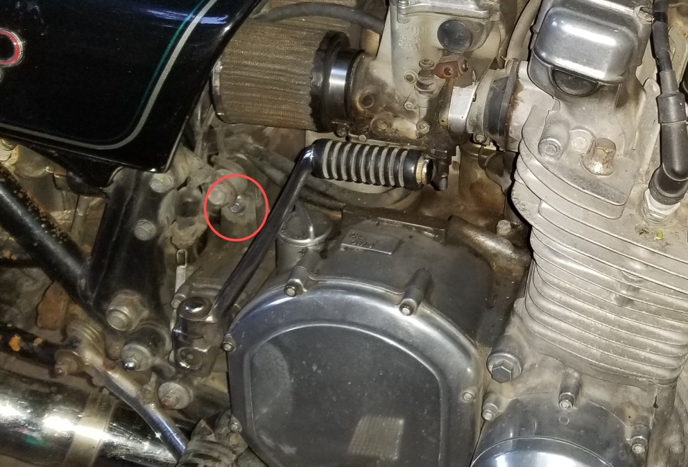

Not really sure on the mounting point.
What is more important----is it a good ground electrically?

Yes that’s were battery negative is landed. Pull it and clean..,
I’m interpreting the “kill switch “ as the off/run switch on the Rh control. I don’t think he has addressed the ignition switch... I’ve heard of lots of problems with voltage caused within the ignition.
