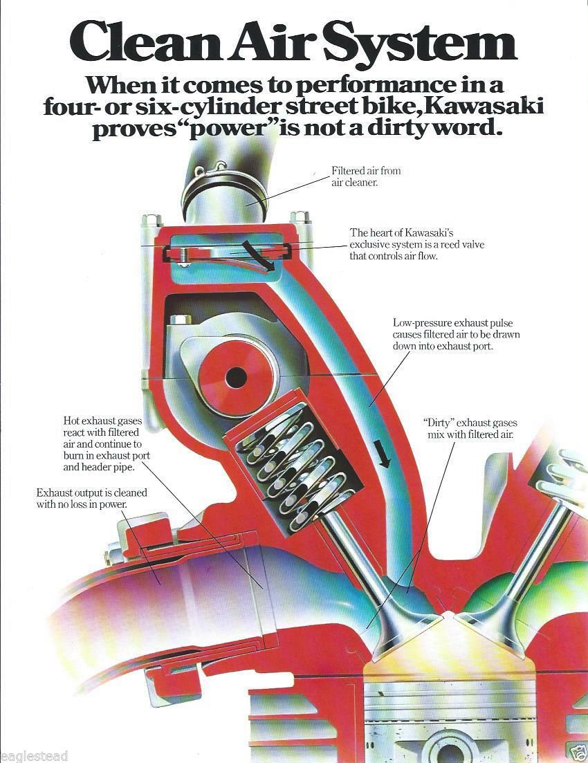

Ok, I'll bite what is the CASS?

22 Aug 2019 15:58 - 22 Aug 2019 16:04
Last edit: 22 Aug 2019 16:04 by Scirocco.
The following user(s) said Thank You: old_kaw

There is absolutely zero gain in removing the CAS system It uses zero HP to operate, and by drawing filtered air into the exhaust system, it causes a after burn of unburnt hydrocarbons in the exhaust system. That said.. there are plenty of things that are done intentionally that DO rob these bikes of HP and cause / give poor performance, none being the CAS.
