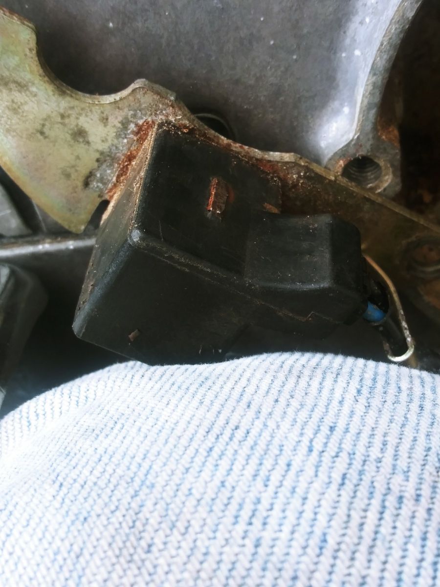

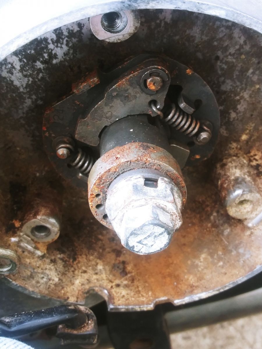

I have attached a picture of the electronic ignition to see if anyone sees a problem with that. I cleaned the advance before I put it in storage because the spring were so rusted they would not move. It is still the original advance springs and they seem real soft but my only reference for advance springs is a small block Chevy. I have not found how to check if the timing is advancing in the FSM yet.

Looks like you're missing the little rubber pieces on the advancer arms. Does it move freely? I'd clean off all the rust on the pickup too.

That advancer needs some love. If it only runs on full choke the carbs are still clogged up especially the pilot circuits.

Swest, I looked at the parts diagram and could not see any rubber pieces on the advance arms. Yes the arms move freely. What would be the best thing to use to get rid of the rust? I have some Evaporust, which I think is safe for rubber and plastic.

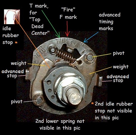

This picture is for an inline-four motor, but it shows the "idle rubber stops". Yours appear to be missing.
This will alter the advance timing. As a work-around, you can use a timing light to set the timing on the double lines when the bike is revved. Then the timing at idle will be off a bit from the "F" mark. But it will be safer to run the motor.
If you're lucky, the rubber bits will just be laying inside the ignition housing. They just look like little bits of dirt.

When I got the bike orginally it had been sitting for a longtime and the ignition advanced was so rusted that it was siezed up and the springs were full of rust ( that is why I was asking about springs also).
