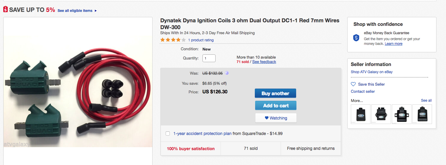

Here are the correct coils according to the manufacturer.
dynaonline.com/dynatek-products.aspx?mk=1144&mdl=2379&yr=2383

12 Mar 2019 07:38 - 12 Mar 2019 07:42TexasKZ wrote: Here are the correct coils according to the manufacturer.
The ones you linked are the same model as the ones my sons ordered DC1-1. . I called Dynatek this morning.
As SWest said "its the green ones."

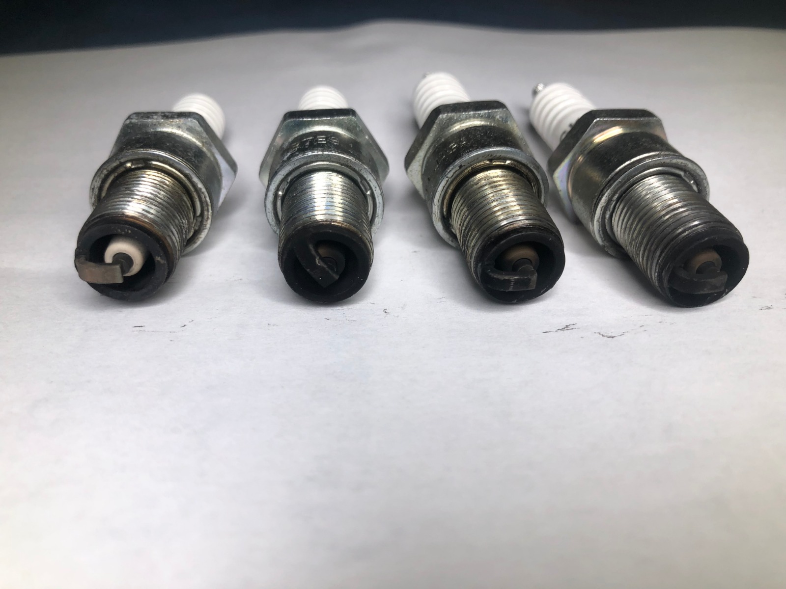

12 Mar 2019 08:37Warren3200gt wrote: vacuum leak from the CARB to the MANIFOLD suggest the clips if fitted at all, are not tight. Is the Manifold split? where exactly is the leak? Does it actually need new manifolds? A leak in one carb rubber will not affect other cylinders. If anything, that one cylinder will run weak not rich. Or.... you could just throw some more money at it in the hope it will work rather than diagnosing and resolving the actual issue !:whistle:
BTW this is what the plugs looked like

12 Mar 2019 08:57
Looks like carboration to me. Too bad we didn't see this sooner.

Re: Carb to Manifold Boots installation.
12 Mar 2019 09:21Thats a carburation issue. If it was coils, either all 4 would look like the 3 do or they would be pairs, 2 good 2 not good.WarrensKZ wrote:Warren3200gt wrote: vacuum leak from the CARB to the MANIFOLD suggest the clips if fitted at all, are not tight. Is the Manifold split? where exactly is the leak? Does it actually need new manifolds? A leak in one carb rubber will not affect other cylinders. If anything, that one cylinder will run weak not rich. Or.... you could just throw some more money at it in the hope it will work rather than diagnosing and resolving the actual issue !:whistle:
You have a spare set of carbs, set them up properly whilst off the bike. Swop them onto the bike, fine tune them by vacuum syncing them and colourtuning them, verify your float heights are still good then go enjoy the road. 2 hours work max with very little cost saving your or your sons hard earned for fuel.

12 Mar 2019 09:56 - 12 Mar 2019 10:27Warren3200gt wrote:Thats a carburation issue. If it was coils, either all 4 would look like the 3 do or they would be pairs, 2 good 2 not good.WarrensKZ wrote:Warren3200gt wrote: vacuum leak from the CARB to the MANIFOLD suggest the clips if fitted at all, are not tight. Is the Manifold split? where exactly is the leak? Does it actually need new manifolds? A leak in one carb rubber will not affect other cylinders. If anything, that one cylinder will run weak not rich. Or.... you could just throw some more money at it in the hope it will work rather than diagnosing and resolving the actual issue !:whistle:
Thanks Warren
Only issue is, I have no idea what the person who sold the carbs to me did to them. he lied and said they were stock. Wasnt true, they are jetted for pods, and as others mentioned here the tangs are bent way beyond what they should be so no I have to figure out how to get them back to spec. Its kind of annoying.
