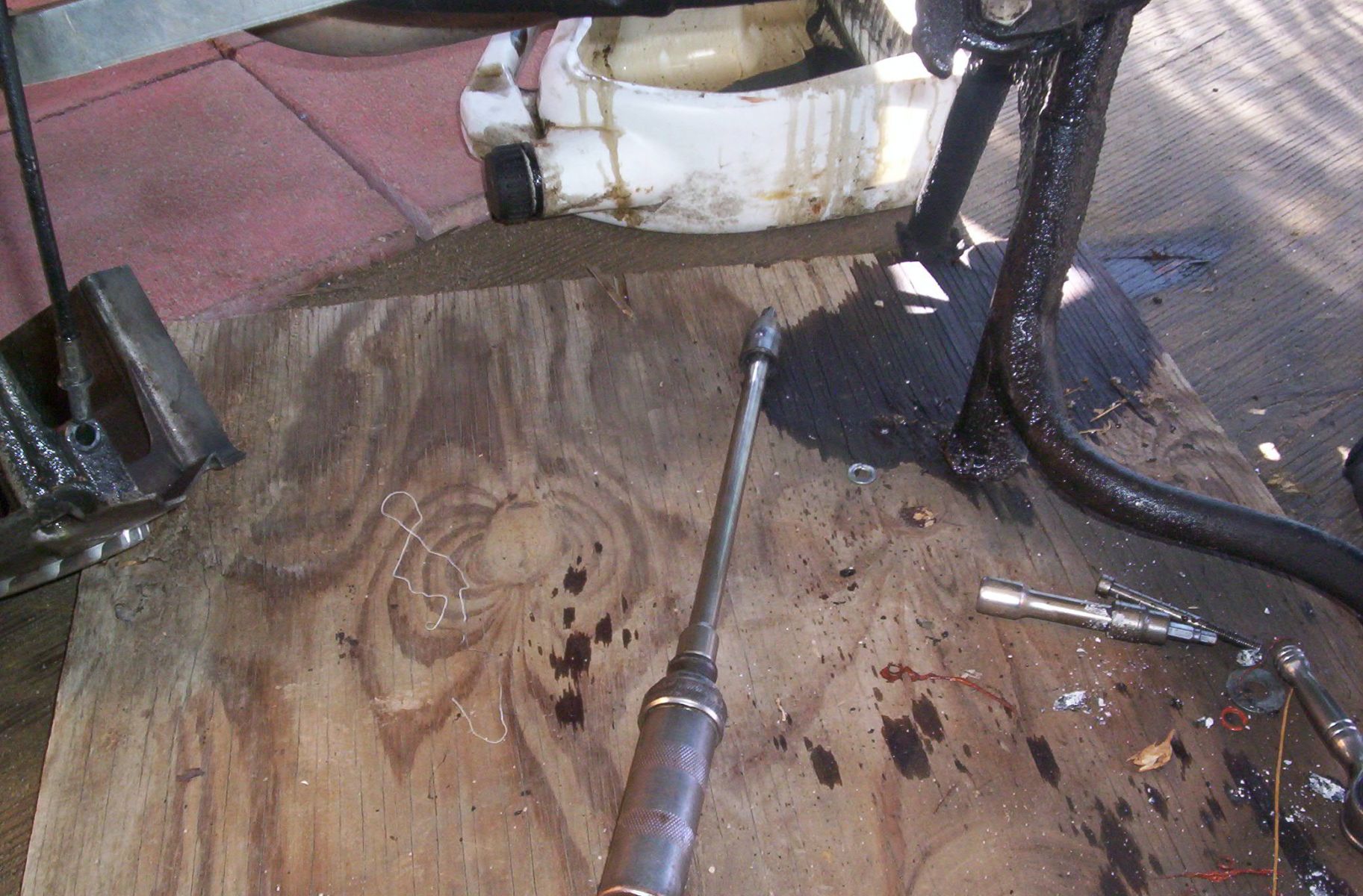

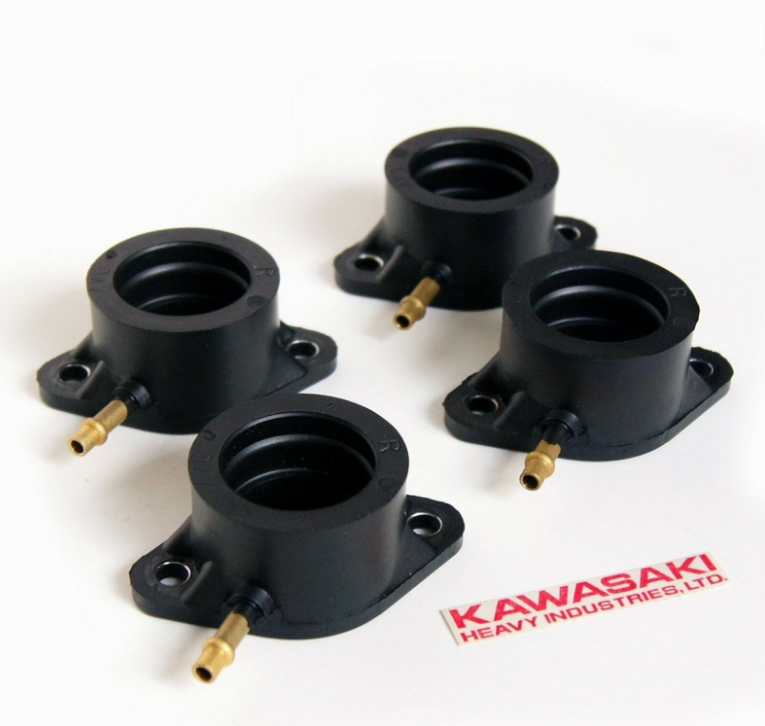

How difficult is it to change the Carb-To-Manifold boots on a KZ650 with the carbs still on the bike?
Do the carbs need to come off completely?
I found a vacuum leak in the cylinder #2 connection boot from the carb to the manifold, which has been the source of plug fouling across all the cylinders, and poor fuel economy.

I'd pull the carbs so you can get an impact driver aimed at the screws. They can be a real bear to remove. A #3 phillips will get er done. You just need to find/make room to swing the hammer.

vacuum leak from the CARB to the MANIFOLD suggest the clips if fitted at all, are not tight. Is the Manifold split? where exactly is the leak? Does it actually need new manifolds? A leak in one carb rubber will not affect other cylinders. If anything, that one cylinder will run weak not rich. Or.... you could just throw some more money at it in the hope it will work rather than diagnosing and resolving the actual issue !:whistle:

Pull the airbox too. You might be able to use a universal attachment on the driver head and a long extension to get in there. It would help to have an extra set of hands to hold the bit snugly on the screw while you wack it.
