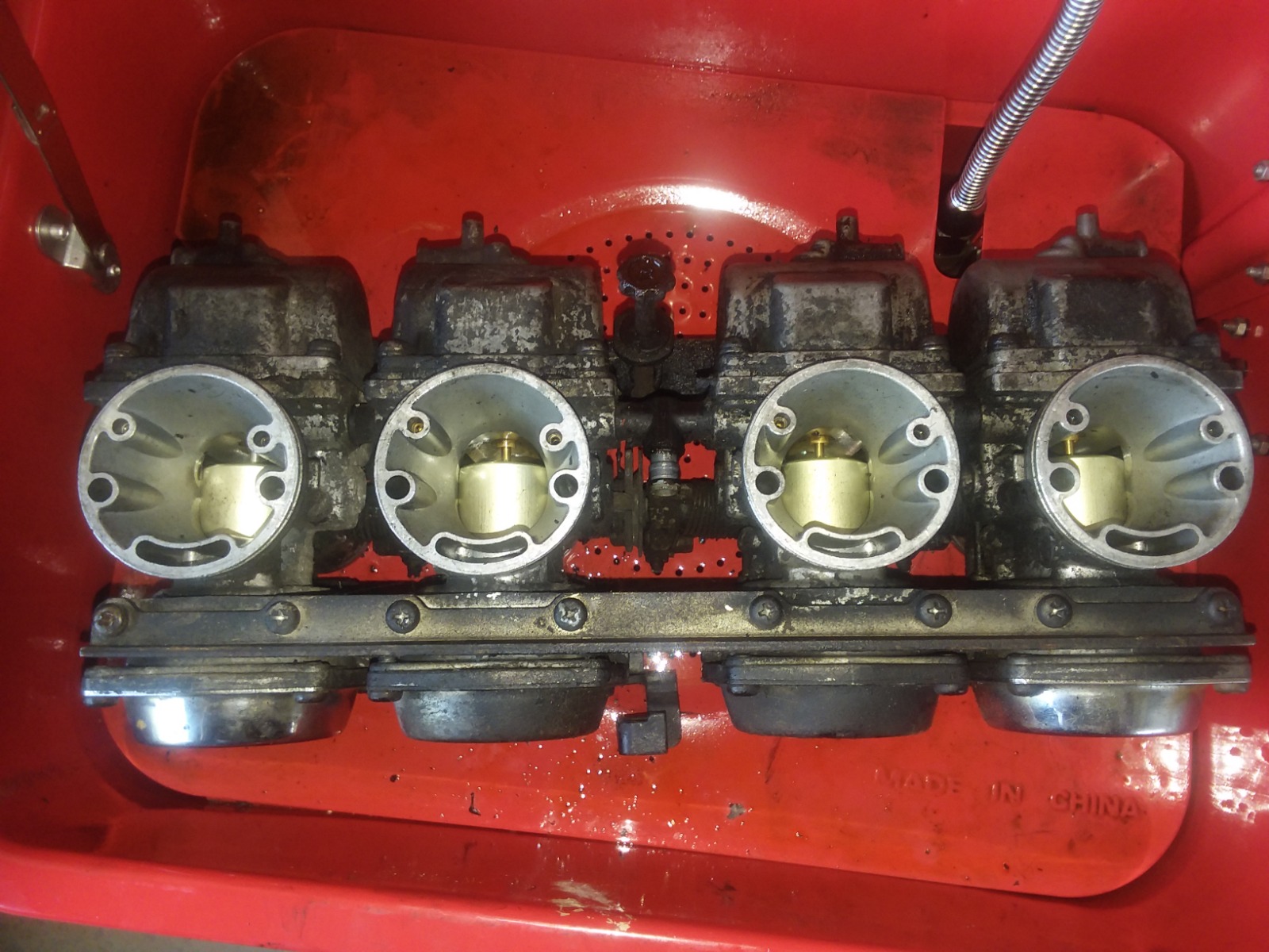

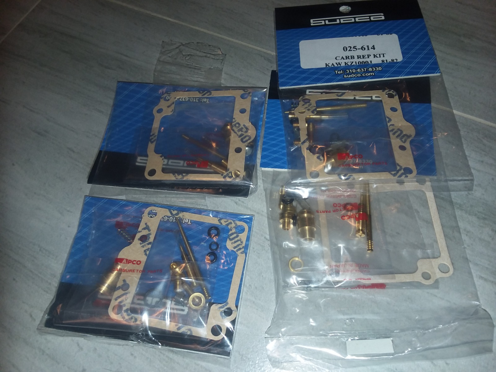

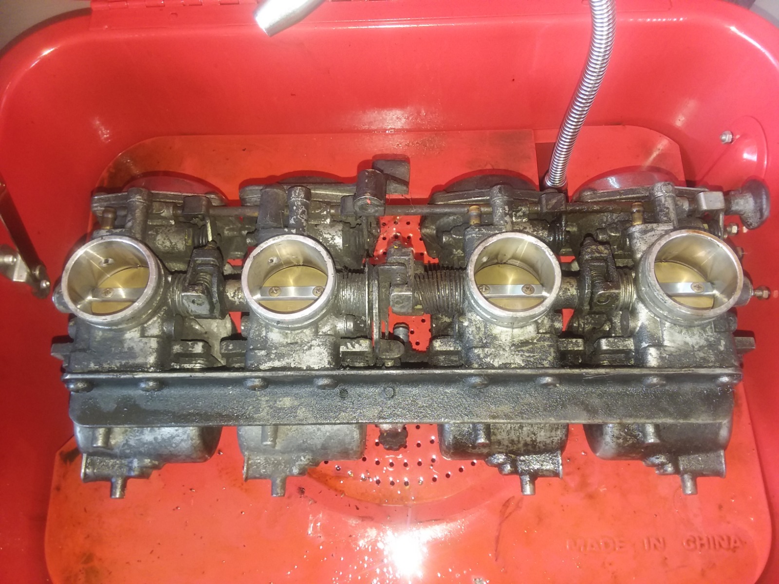

I recently purchased a 1993 KZ1000P and am going through the carbs. I'm not familiar with this style, I believe they are CV Mikuni BS34 carbs.
I had planned on using my stock modded air Box, then recalled what a pain it was to install carbs with and contemplated pods. Im assuming pods are a no go with the CVs, though.
Any tips or tricks on the rebuild?
Pictures below:
Pictures below:

So I take it you have done the boil method on numerous carbs, with different chemicals? Since you only get one chance to screw up any given expensive and hard to replace part,I tend to error on the cautious side cut my losses at one set.

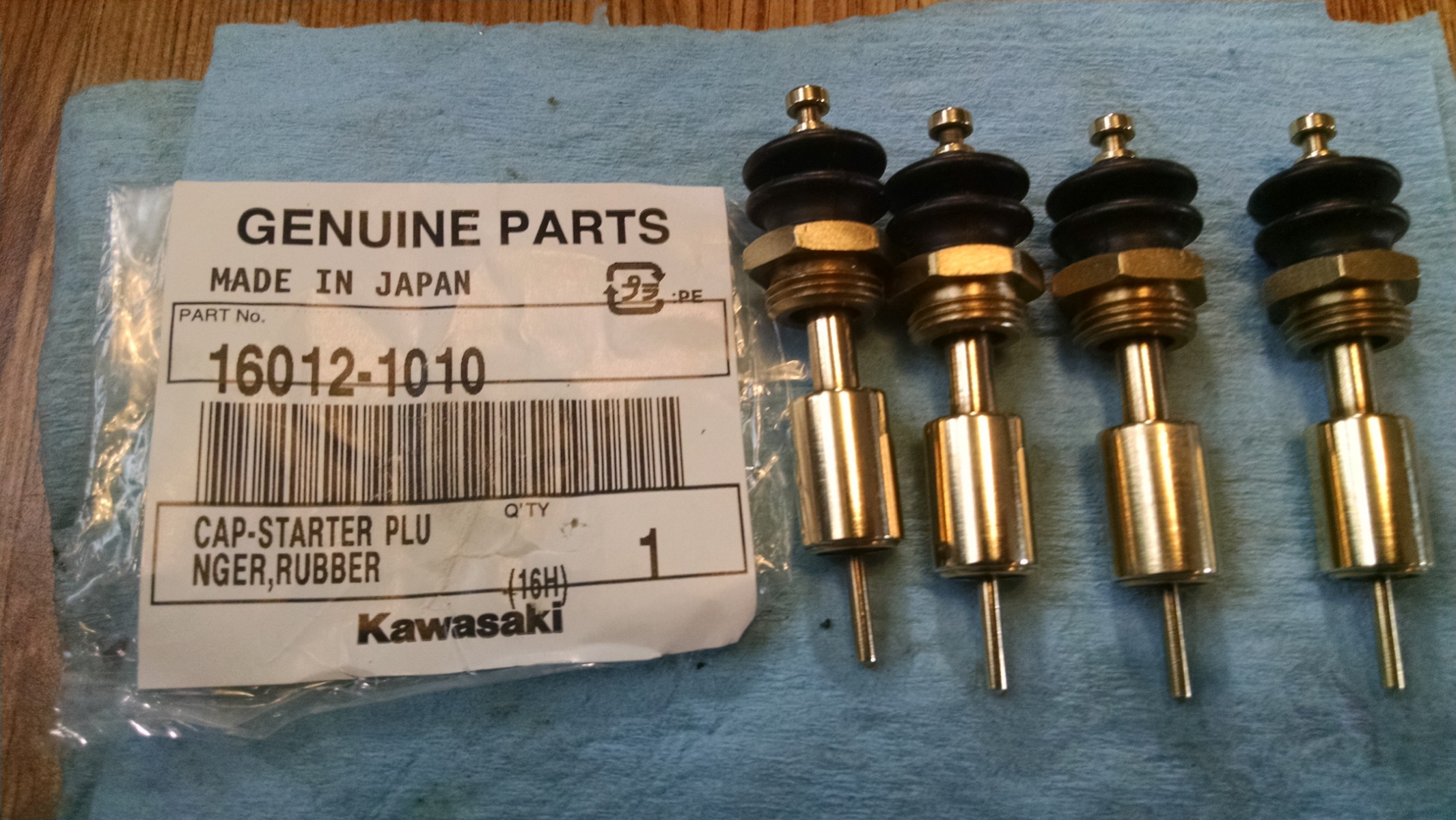

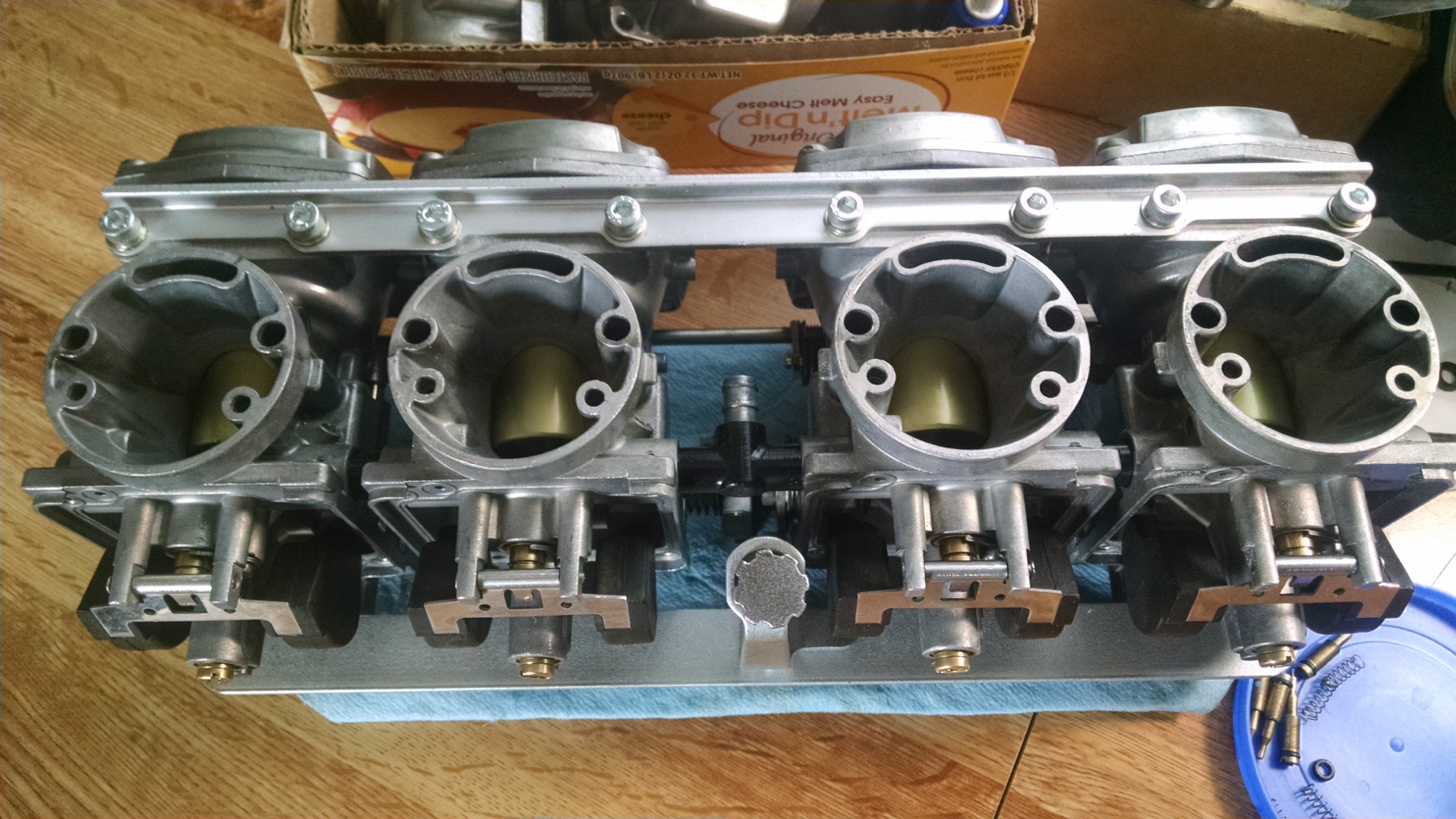

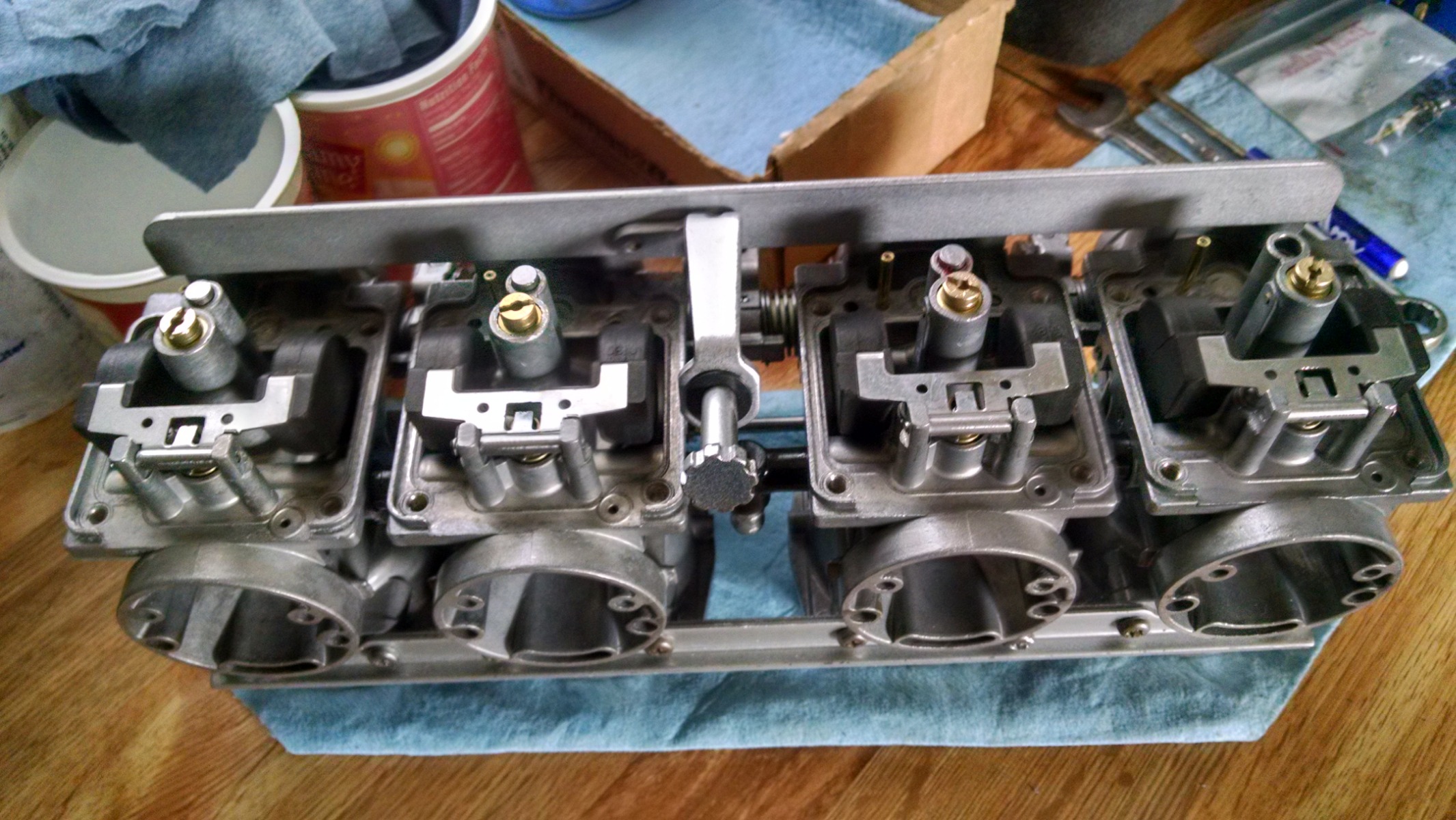

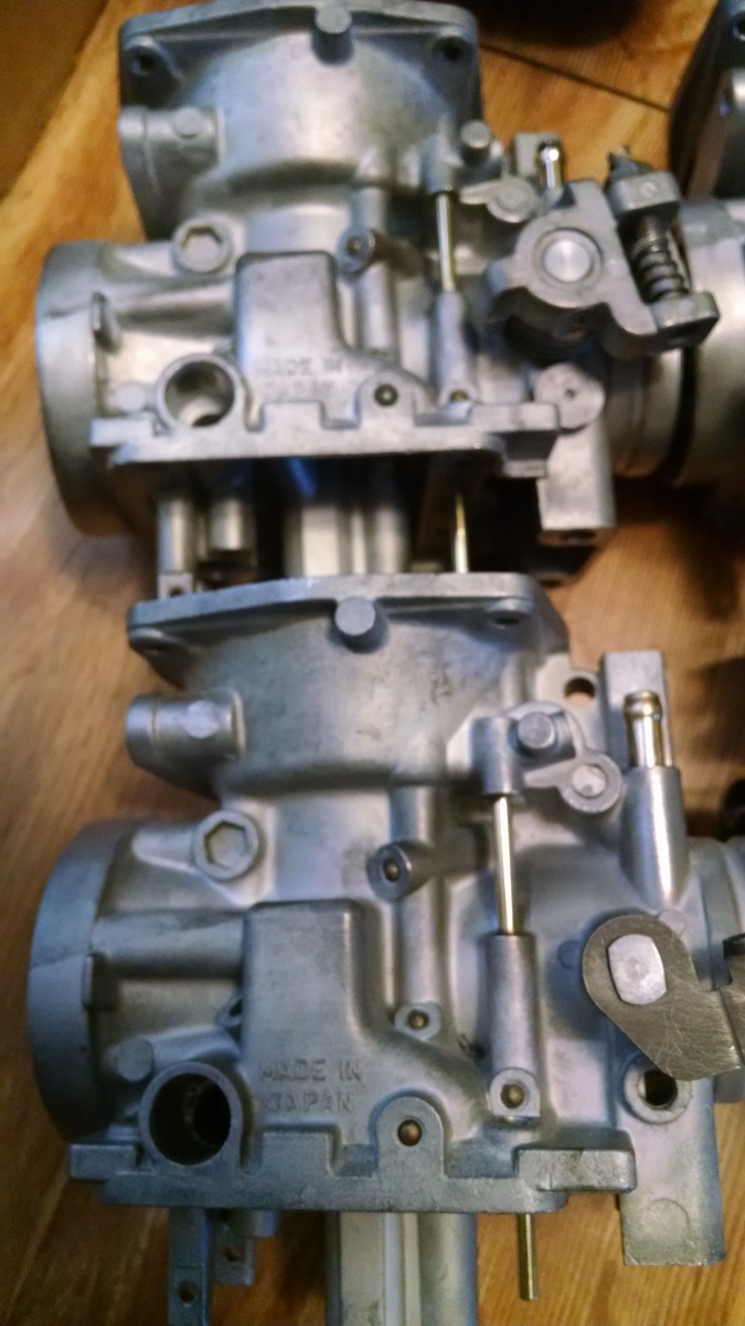

Last resort? Just a good cleaning with mineral spirits and a parts brush is a good start. Just like any part, clean it up. Boiling is unnecessary, and it removes the sealers used to coat the porosity in the cast metal. Old gas turns into varnish and crud. Lacquer thinner, brake clean or carb spray will cut varnish. Squirt the cleaners through all of the passages. Heating a bread tie to strip off the plastic coating will give you a thin wire that can be used to poke through those pesky little holes, and follow up with brakleen, then compressed air.
Of course the carb dip works as advertised. Or at least it used to. I had a 5 gallon bucket with metal basket at one point, I still have the metal basket that I use quite frequently still.
I polished all of the brass parts that I could too, since it all had that brass "gangreen" that it gets over time.
And I replaced the rubber booties on the choke (enrichment) plungers. Polished the plungers and all of the small o-ring sealing bores with my dremel tool and a small polish pad.
