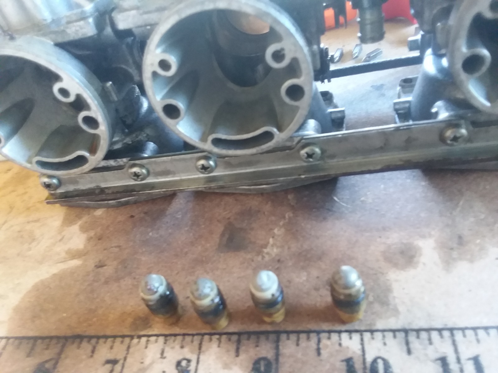

Carbs are gone through. I used all the new pieces and saved the old ones for extras. Other than junk on the seat filters and two clogged pilot jets, they were pretty good. I ordered a screw kit to replace the cap screws.
