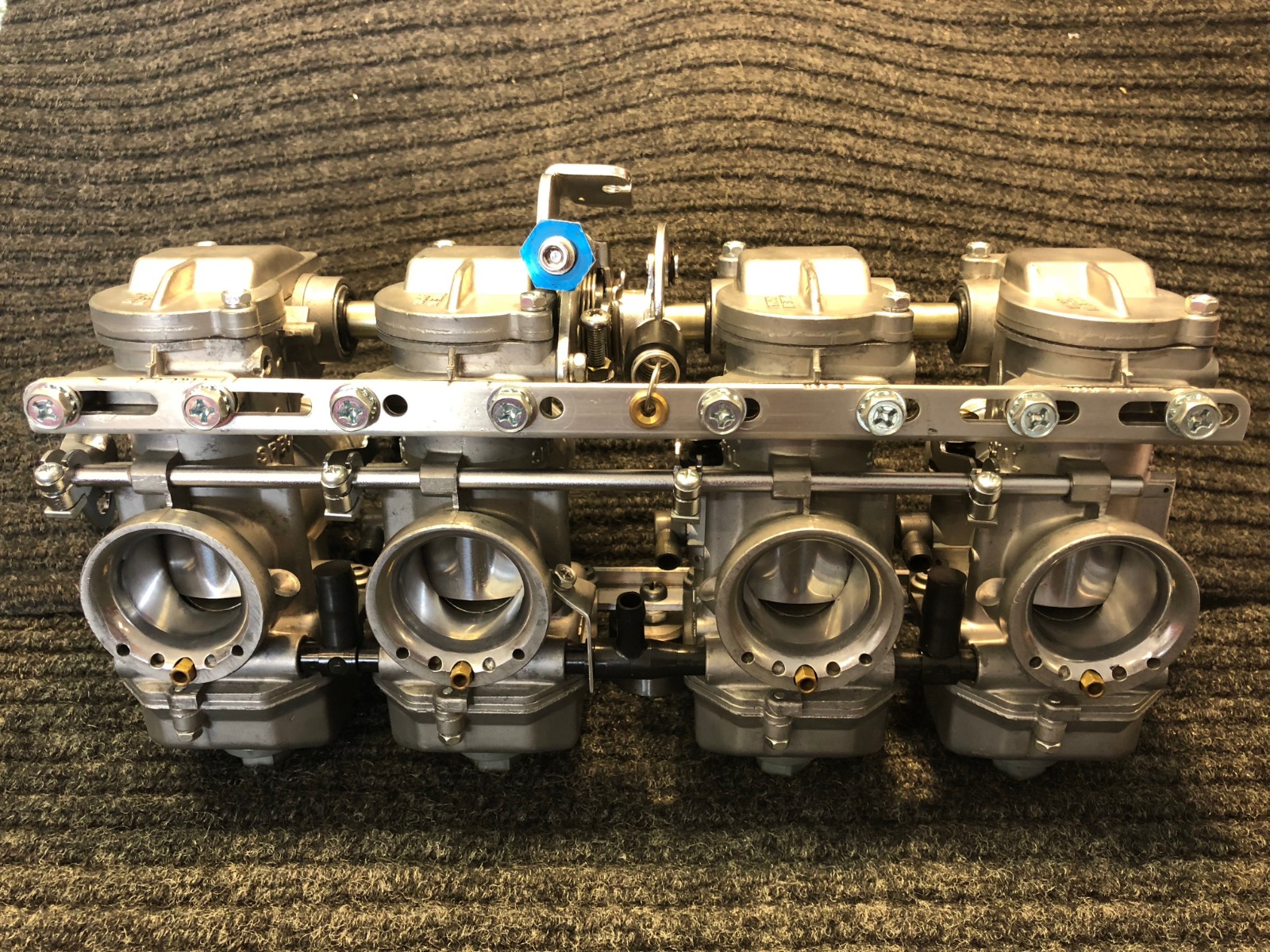

I fully support all the effort to try and revive the original fuel injection system.......but shameless plug here, I have some fully restored Keihin cr33 specials that I really need to sell. They even have the correct spacing and spigots to bolt right up to a gpz1100. Just so you know that you have a potential plan B
End of shameless plug....I return you to the original matter at hand.
