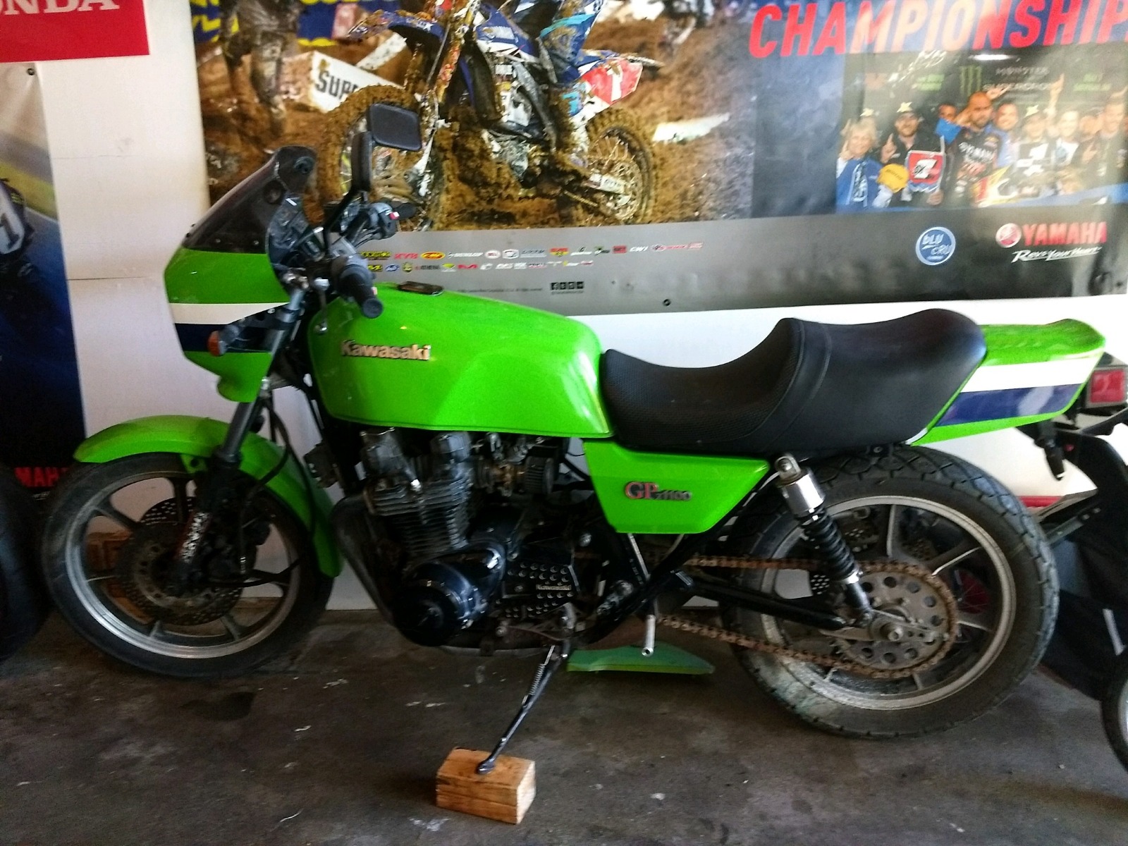

I don't know the details of the jumpstart 13 years ago. I know that was the moment in time when it quit running. Specifically the fuel pump wouldn't power up when the key was turned on.
Old Kaw, thanks for the video. I'll use some of the techniques you have described on my 1980 Z1 Classic soon. I am determined to bring that one back to life with fuel injection. is there a sensor that looks for the pump to come up to pressure? I've done some work on my 2002 Trans Am with EFI Live. I have a working understanding of a modern EFI system. Statement 1 in this post coupled with the dead fuel pump was in fact what doomed this FI system.

20 Sep 2018 23:35 - 20 Sep 2018 23:50ajsfirehawk wrote:
No one is concerned about what happened when some goofball jumped it from a car battery? I've got 7 hours in this thing, I've only charged him for 3. I only bill when I'm making direct progress towards the end goal. Buying a fuel pump, cleaning and or replacing injectors before I can even start to see if the ECU is fried
chops to make it run properly. I've got carbs I'll sell him for 60% of the going rate. If I don't make it run properly for well short of $1000, I'll put it back together and won't charge him a dime. Then we will talk about next steps as does he want to pursue fixing the FI. I suspect the answer is no and he would sell it for salvage value.
This is the neg battery cable? What a mess that cable is. THIS would be the FIRST thing to fix on ANY bike. Pry that connector open, cut that cable off, and pinch that connector back over the cable, and solder it.
NO, you don't clean injectors before seeing if the electronics work, that is what the noid light tells you. The fuel pump is / was`80 bucks on ebay,
Obviously you did no troubleshooting whatsoever to even find out if this EFI worked. All you needed to do was rig up a fuel pump and give it some fuel pressure., ANY fuel pump.. Put a hot battery on it, after fixing that screwed up cable, and crank it. Give it a shot of either and see if it fires. It might miss and run like shit, which also can be fixed.
With a battery ($60.00 eBay)and fuel pump, (80.00 eBay) and say ~8 hours labor at 50 per, getting this bike running would be under 600 bucks. I charge this day in, day out, and fix the stuff 100% of the time. I troubleshoot more than I change parts.
7 Hours? Hopefully one of those hours was spent on the battery cable.

I copped to spending little time diagnosing in the prior post. Early on when the fuel pump was shot I decided to cut bait. An early post by a GPz1100 owner in this thread talked about using caution to 'avoid going too far down the rabbit hole'. It is far from the first time I've heard those kinds of comments about these bikes. Sniping for a little show and tell on the battery cable? The battery cable came apart in my hand yesterday and of course I fixed it. I was not planning on cleaning before testing the injectors but the potential for needing to do so doesn't seem unrealistic. The 7 hours is in large part my reading, researching, tracking down a manual (thank you Pablo) cleaning, inspecting in addition to draining, flushing, de-rusting the inside of the tank, pulling, testing, soaking in PB Blaster the fuel pump, extracting the electronics and other maintenance items. I billed only for moving this bike closer to running as I believe I mentioned. My time in research, inspecting...it is that, my time, not billable but it is time.
I still do appreciate the input. Really. I will in fact use the information to get the next bike running with it's DFI.

I too recently purchased a GPz1100 I am completely in love everything appears to be good on mine so far. I did find that i have no power to the fuel pump. Does anyone know what I can do to get a replacement relay or can it be fixed by some mad scientist? Sorry for high jacking your forum. Once i have the bike running i will be selling the full fuel system so if someone needs one it is complete. Also i am in need of a new windscreen can anyone tell me which model fits my 82 where i can get one or have one made anything new.

I just got my fuel pump to humm away I was so stoked then I started pulling the spark plugs and found plumbers tape holding the number two plug in it's stripped. I got a thread insert in and seems good but have no compression in that cylinder so looks like I got a valve promblem or Piston problem. All the cylinders have good compression except this one. I took a look at all the valve seats on the good cylinders and I can clearly see a mating surface ring. On my bad compression cylinder there is no mating surface ring on the exhaust valve so hopefully it's just out of adjustment. We will see maybe it just has some build up. Cleaning the rust out of the tank now new filter and fuel lines and hopefully she will pop off. If the guy that started this thread would like my fuel injection it's going to be for sale. Not sure if it will fit on your 81.
