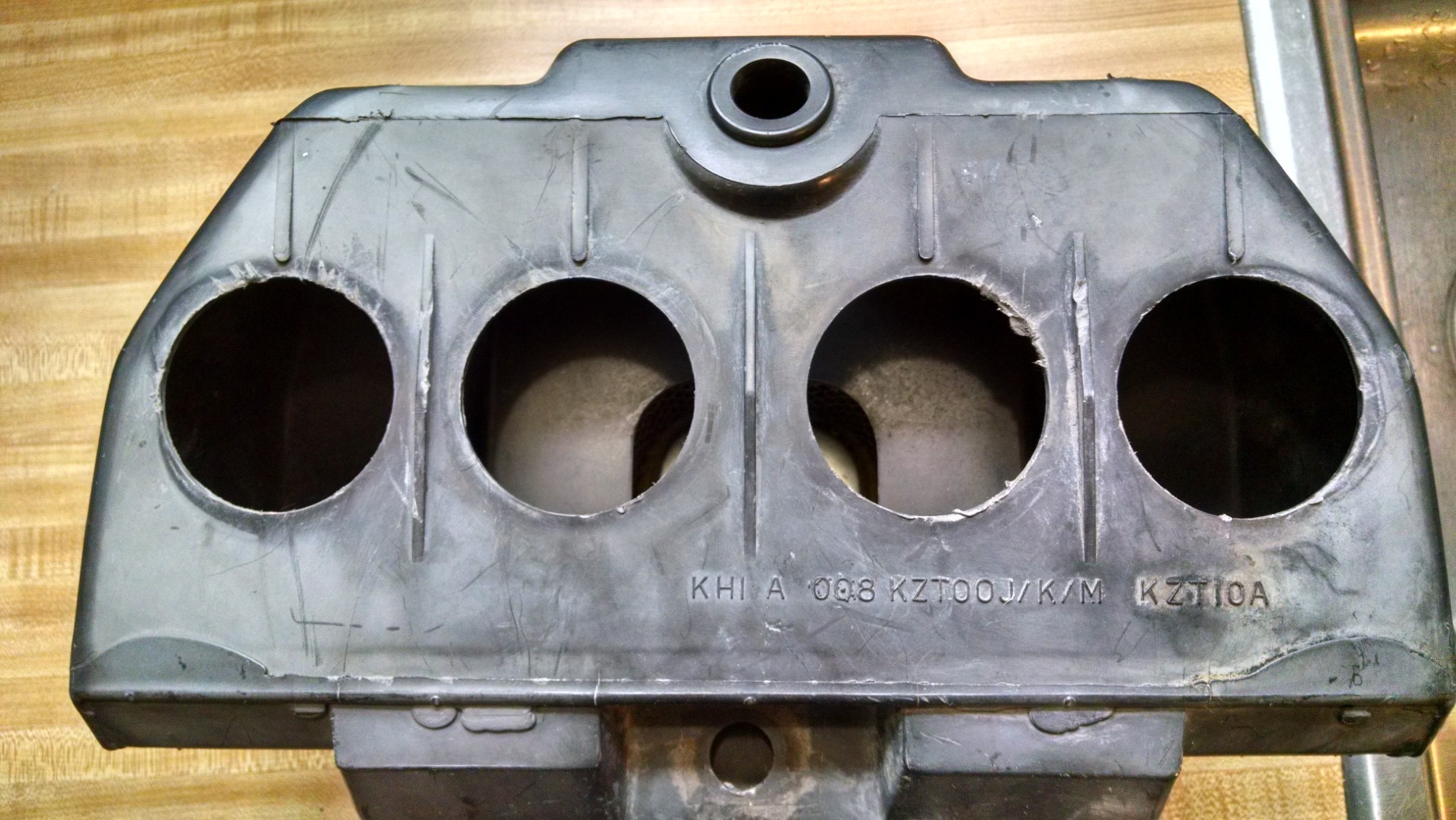

I sincerely appreciate this discussion. Let me respond to a few of the points made. As for the gentleman who talked about the issues he had with his GPz1100 when new: This was a Kawasaki dealer circa 1983. Not last week or last year where no one has the time, the skills or the interest to work on these. I've heard that some story a number of times for whatever that is worth. If it was my bike I'd mess around with it for months to get it to run stock. It isn't mine.
No one is concerned about what happened when some goofball jumped it from a car battery? I've got 7 hours in this thing, I've only charged him for 3. I only bill when I'm making direct progress towards the end goal. Buying a fuel pump, cleaning and or replacing injectors before I can even start to see if the ECU is fried and the diagnostic time to sort that out all costs time and money...for a 'might make it run'. My belief is much of the problem with the early FI bikes is in general the mechanics of the day had little interest in learning about FI. Speculative and all ancient history. Plus, if I were to get it running and he has a problem next summer, where does he go to get it fixed. If I've got a job at that time, it ain't going to be me. With carbs, someone will have the chops to make it run properly. I've got carbs I'll sell him for 60% of the going rate. If I don't make it run properly for well short of $1000, I'll put it back together and won't charge him a dime. Then we will talk about next steps as does he want to pursue fixing the FI. I suspect the answer is no and he would sell it for salvage value.
I'm going to move into projects since that is what this has become. Got some time in the garage yesterday. I extracted the fuel injection lock stock and barrel. The electronics came out fairly easily. It is completely isolated save one 3 pin connector. I've got to look up those three wires to see what they do and determine if they need to be addressed versus leaving them open. The oil cooler lines want to interfere with the BS34 carbs throttle blade shaft. I'll have to fab some simple brackets to mount to the #1 & 2, #3 & 4 top carb holder allen head screws. Bridging those with a flat bracket will hold those lines out of the way. I'll have to cover or dress out the edges of those brackets to ensure they don't chafe the lines over time. I should be able to get back out there for a bit this afternoon. I also have a little negative battery cable issue to address.

20 Sep 2018 15:04 - 20 Sep 2018 15:14ajsfirehawk wrote: I If it was my bike I'd mess around with it for months to get it to run stock. It isn't mine.
It would seem this EFI was doomed from the start. ( I have 2 extra air boxes and a Kz1000 battery tray I'd like to sell!)
At any rate, good luck on the fix / carb conversion.
