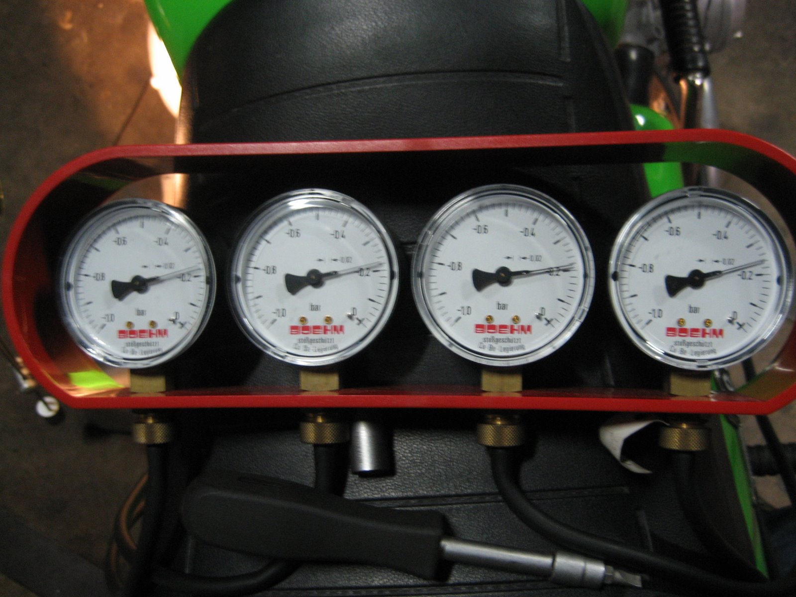

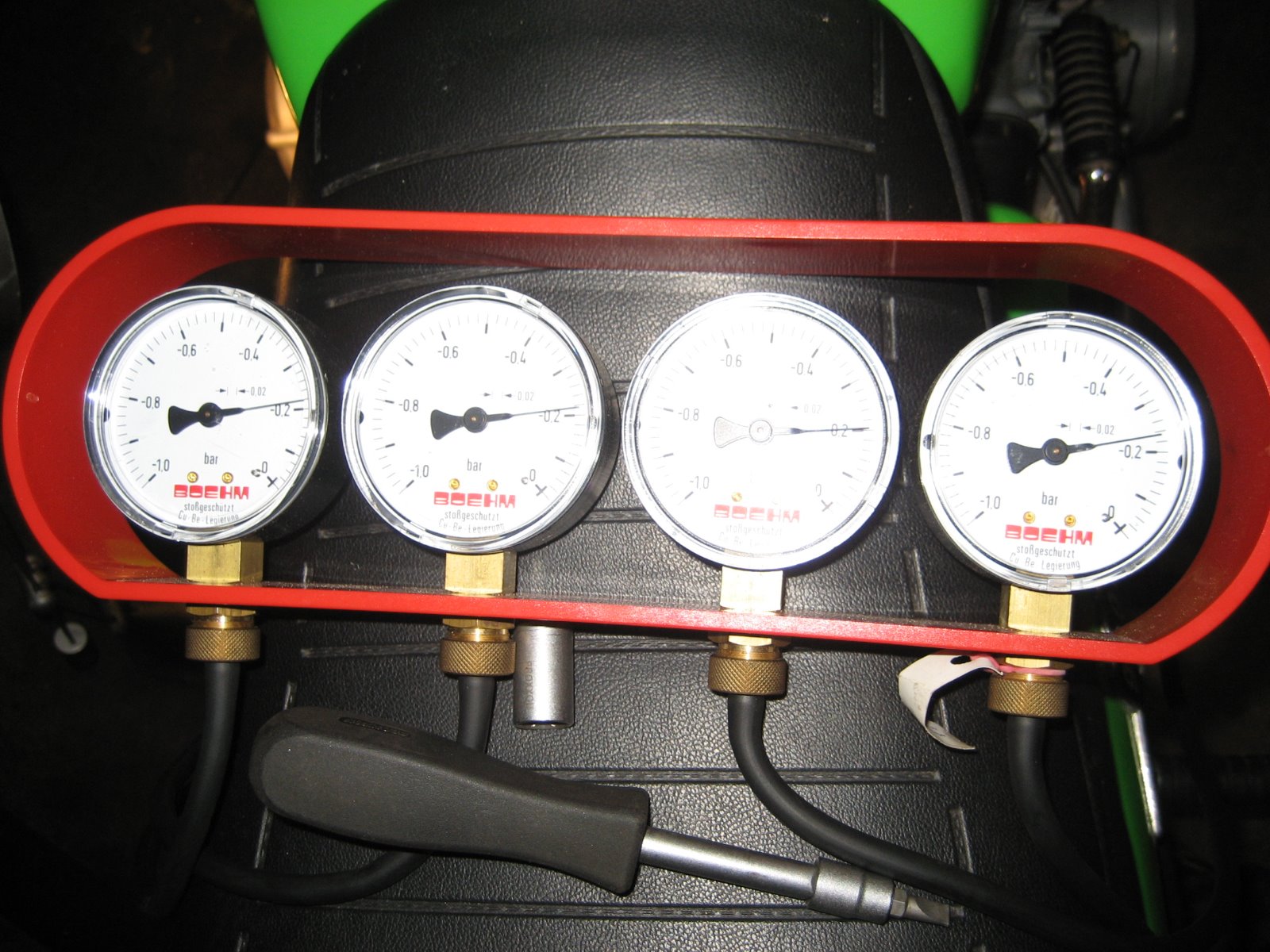

Adjust the idle rev and pilots screws (1 and 1/2 out) without throttle cable in touch.
Bike sounds good so far but a carb vacuum sync is a must have for stable low idle.
