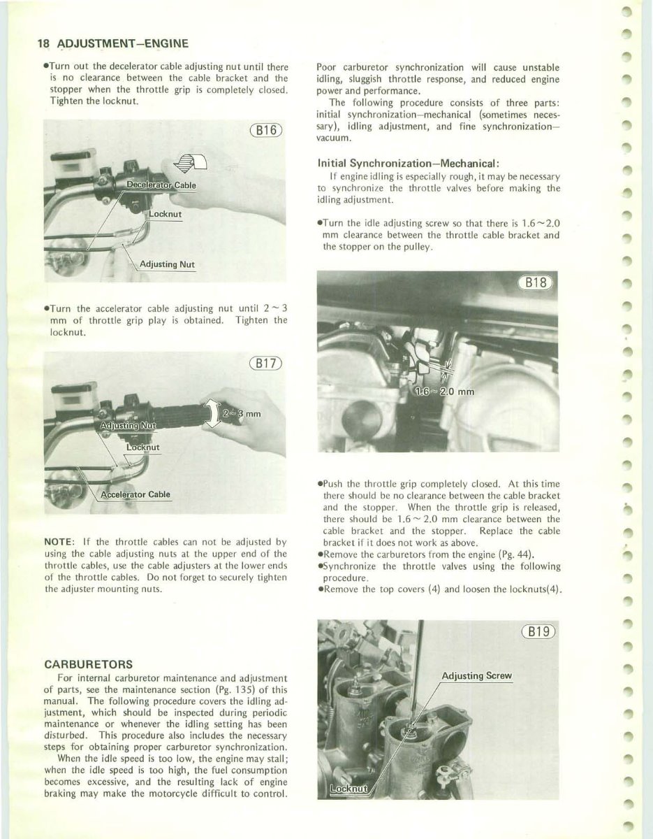

Let’s review the basics –
That large adjuster screw is used to adjust the idle rpm by raising or lowering all 4 slides exactly the same amount. When you adjust it it should raise or lower all 4 slides the same amount which in turn will increase or decrease the engine’s idle rpm.
If that idle adjuster screw is set to a fairly central position when the slides heights are individually adjusted it can raise or lower the slides depending on which way it is turned. However, if the adjuster screw is set to one extreme or the other when the slides heights are individually adjusted it will not be able to adjust the slide heights beyond the position where it was set when the slides were adjusted.
Think of it this way – let’s assume the idle adjuster screw was turned all the way out when the 4 slide heights were individually adjusted, and when you started the engine you found the idle rpm was too high. You would not be able to lower the slides by turning the adjuster screw further out because it would already be turned all the way out. If, other the other hand, the adjuster screw was set to a central position when the individual slide heights were set, and when you started the engine you found the idle rpm to be too high, you could turn the adjuster further out to lower all 4 slides the exact same amount and thus lower the engine rpm to the correct level.
That is the reason for turning the idle adjuster to a central position before adjusting the individual slide heights. Ed

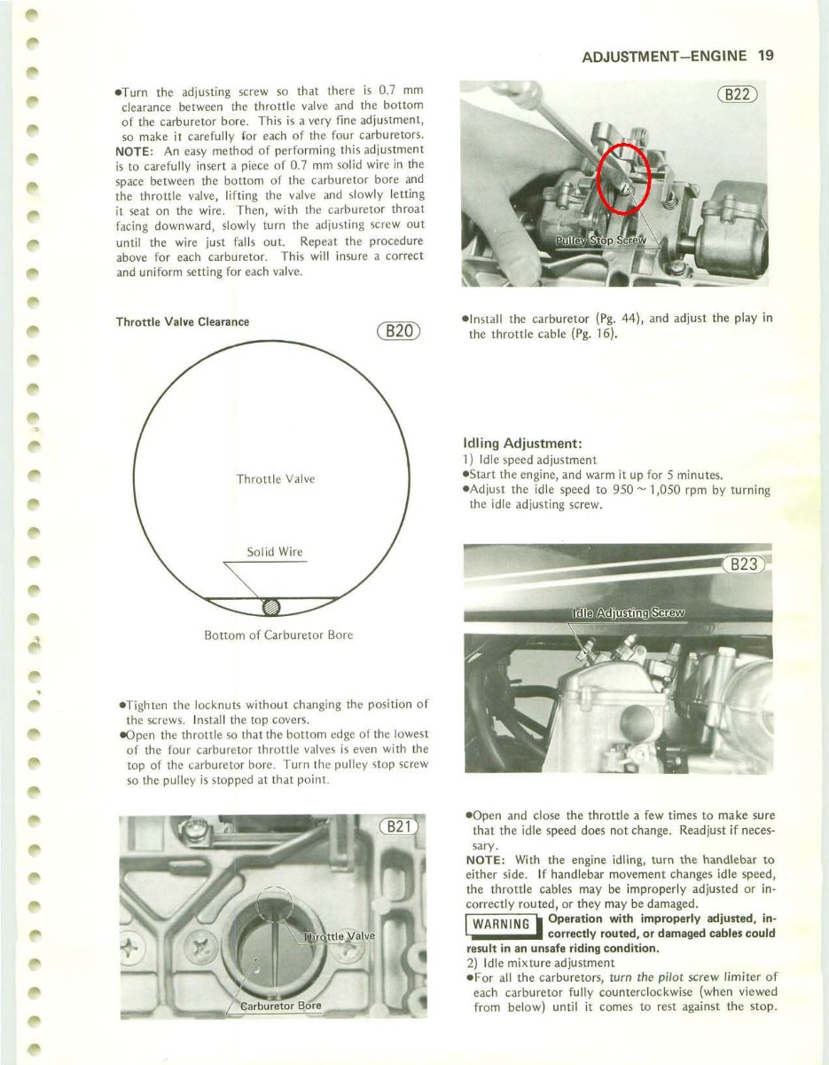

Forget the halfway idler screw adjustment. There is a pully stop screw you have to adjust as a lowest setting point for the sliders.
If you have set the sliders to the static reference you have to do a vaccum fine sync of the carbs.

I would not recommend forgetting the halfway idler screw adjustment.
Notice on Page 19 in the images posted under the heading “Idling Adjustment” it states:
1) Idle speed adjustment
- Start the engine, and warm it up for 5 minutes.
- Adjust the idle speed to 950 – 1,050 rpm by turning the idle adjusting screw.
My point was that if the idle adjustment screw is so far out that there’s no room left for adjustment one cannot use it to adjust the idle speed any lower. Ed
