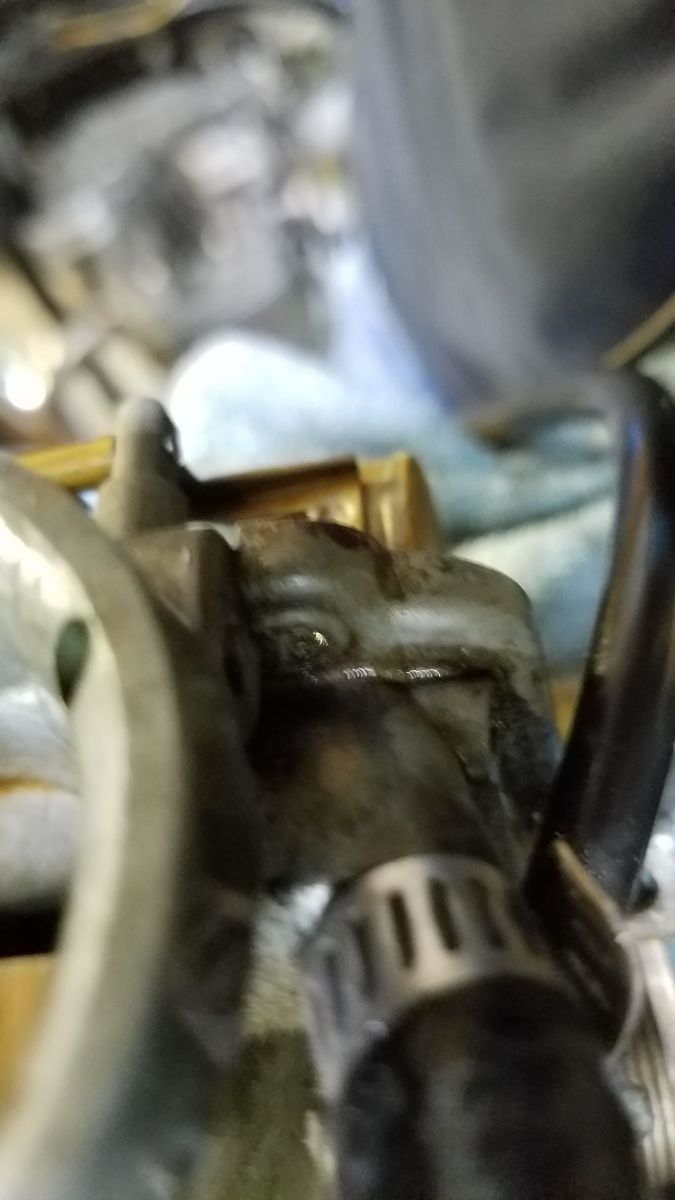

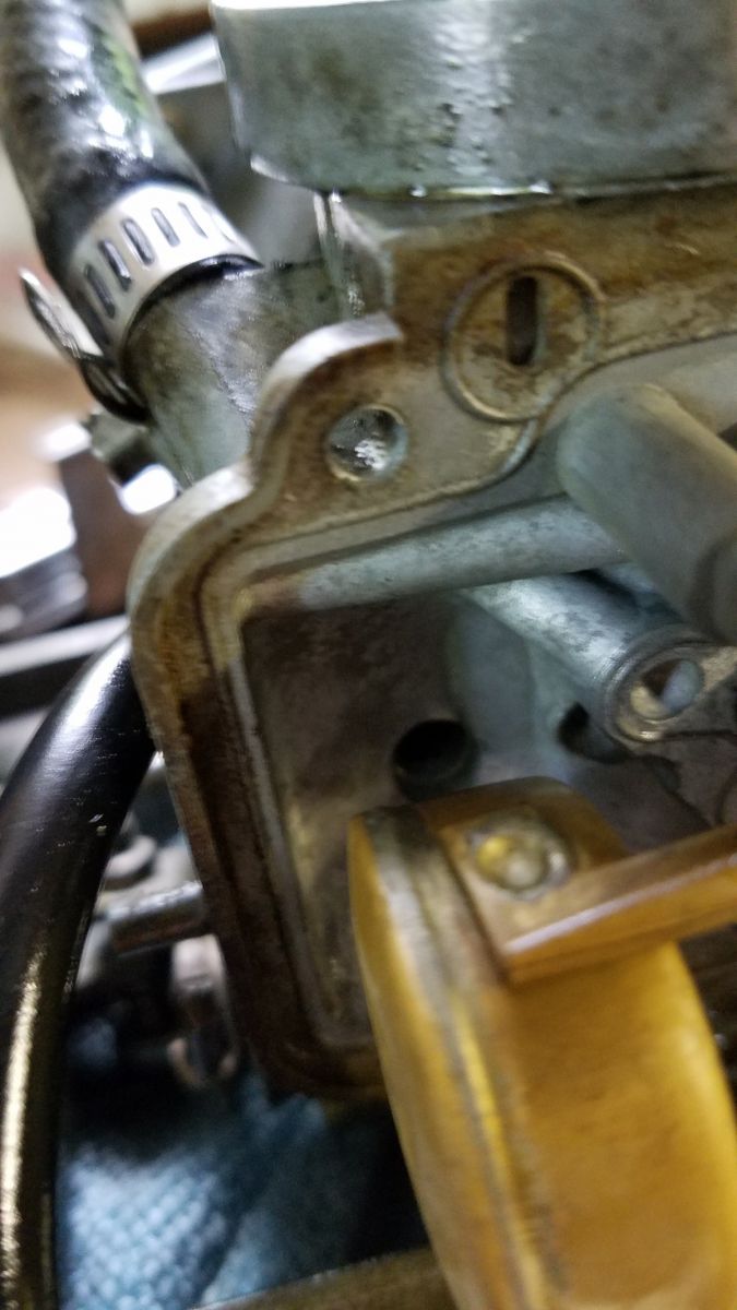

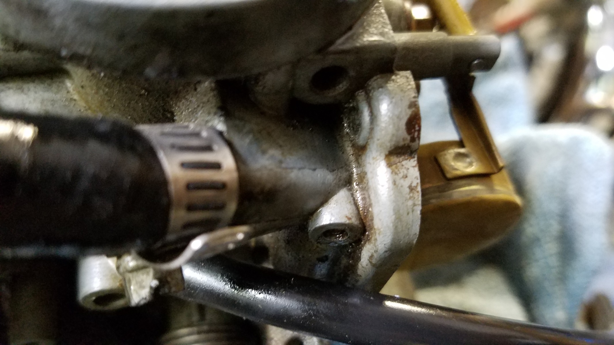

Here are some photos. I decided to take the easy way out and tap it with an American tap (8-32 i think)

Plenty of meat for a helicoil.
- Posts: 23540
- Thanks: 2945
Re: Stripped float bowl screws
13 Jul 2018 21:31
I'd say so.
